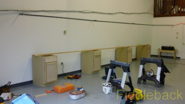

Alrighty. Progress pics. The first shot is taken from the bay door looking in. You can see the air port pipe up on the wall. I am just rough placing the cabinets using 2x4's to ajust the spacing. The bench will go on these cabinets.
This is a detail shot of the black pipe compressor line. The bench for the KMG's will go on this wall.

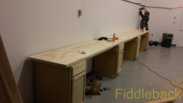

This is the first bench all put together. We're going to face the plywood edges with curly maple. I got 30 board feet yesterday for the task for $1.80 a bf. Hehe. Cabinetmakers, ... They think its trash. There will be pegboard over this bench, then two shelves with lighting underneath them.

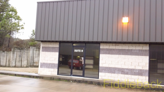

The rest of the pics are just random 'move in' pics. The first shows the front door. You can see the side yard there. The landlord doesn't mind me turning this into a dog run. I'm really stoked to take Boudreaux with me to work.

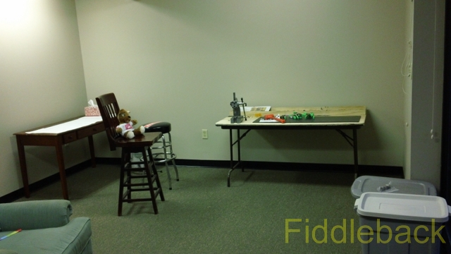

This is the front workspace. We will have a leather bench in this room, a PC, two tables for glueup, random not dusty task areas will be in here(kydex rivets and such). Its more space than we're using for this now.

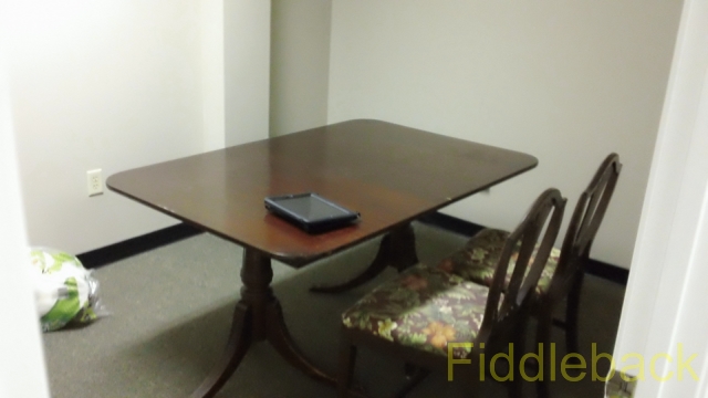

This is the 'office'. We haven't decided exactly how to use this yet. For now its our eating spot.
