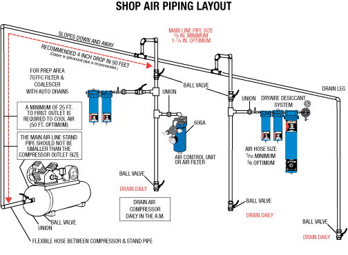

" Use 2" or greater diameter pipe as the first leg of your system where the air compressor connects
to the air piping system, and no less than " for the runs and drops"
This drawing is the one referred to in the text
Get the proper version here, much more visible
http://www.sharpe1.com/sharpe/sharpe.nsf/Files/YTCJYTCK/$File/pipe-layout.pdf
3/4" minimum, 1 1/4" recommended for runs and drops.
Man, that was interesting. We did put on moisture traps. Might go ahead and put a slope in the pipe. Thats a good idea. Neato writeup.
I think you will like it and it's much easier to do now at the beginning of a setup.
If you rotate the pipe a bit, you could also get the nipples to the fitting come off the top too.
& a drop on the end of the slope with a ball valve would let you drain the line.

I wouldn't worry to much about it, if you're not planning to spray automotive paints no worries.. It takes a long time for moisture to travel 'up' a pipe.. and in my mind the slop should be upward instead of down...
the biggest key is to keep the pipes cool, and I would install one 'T' before your first valve run it up like the drawing..
have your drain valve down by the compressor.
I'm going to add some drains, and turn the ports upwards. That will hopefully help some. Like I said, we're not using the compressor constantly. Just occasionally blowing dust.

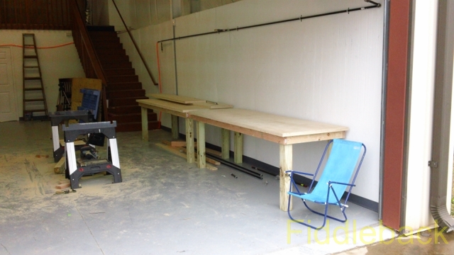

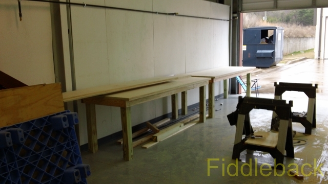

New pics today. Dan and I finished the 16' of benches on the bay door wall. This will house the KMG's (3 vert and one horiz) a 2x42 and a chop saw. Still have to put the curly Maple facing on the raw plywood edges.
Same benches from the stair end of the space.

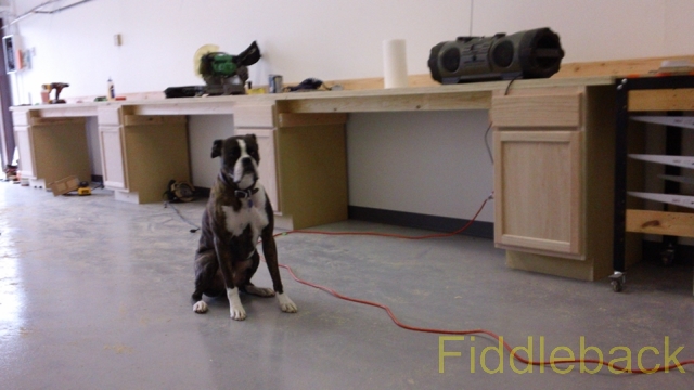

One of the dog, Boudreaux, overseeing the cleanup before we left.

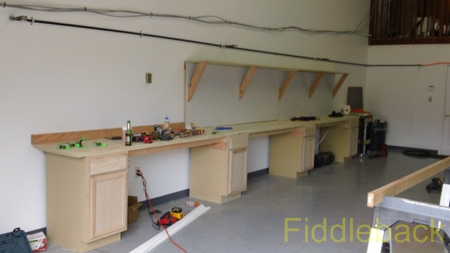

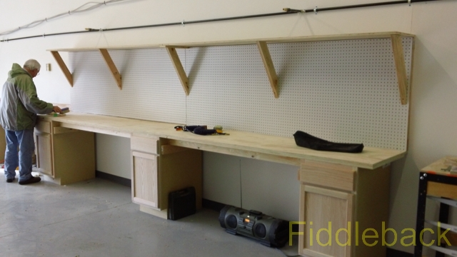

Yesterday I was lucky to have a couple of guys from the GA Guild show up to help out. They put pegboard and a shelf over 2/3 of the 24' bench. Got some pics to show now. I've never had a shop with pegboard. Its pretty neato.
