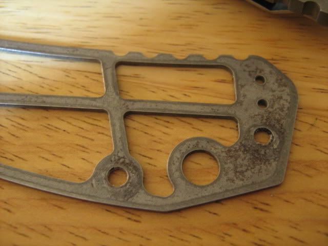

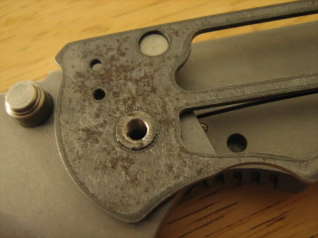

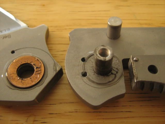

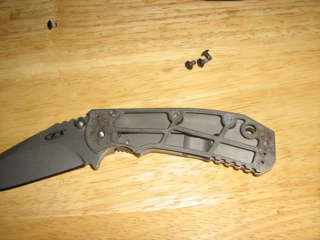

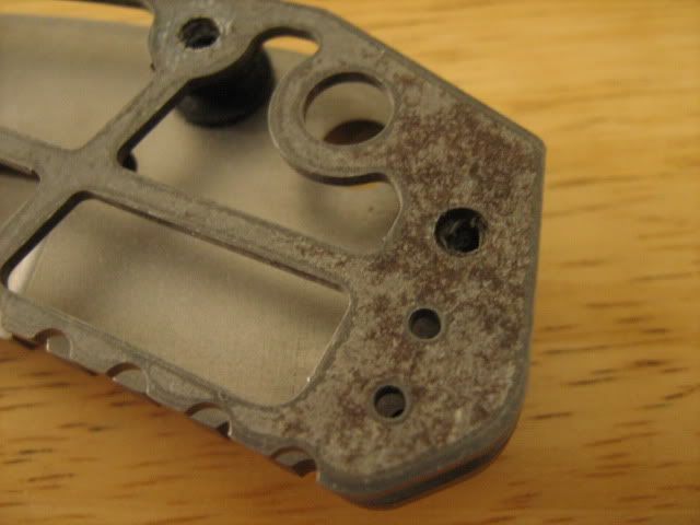

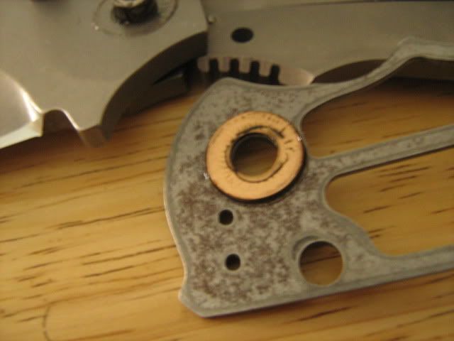

Well, I was overjoyed for a moment and then my curse kicked in.
When my knife arrived today I did the usual F&F inspection then moved straight to the sharpening stones. When I was done I noticed two things, the first being I could push the lock bar over the right after lock up and the second was rust on the liner side :eek:
At first I thought the rust may have been from using my water stones to sharpen but I dug a little deeper and found this.
The lock issue is one that I have seen before and I figured it was probably from too much oil, from the looks of it that seems to be the issue.
So before I fix the issues myself I would like to hear from Thomas or Rick. I can fix it myself and really don't want to send it back but if you want it for inspection I understand. I'm also not upset by this but rather just wanted to give you the heads up on a possible problem.
That liner doesn't even look finished. :eek:
Can you post a pic of the lock-up RevDevil?
I'm hoping to receive mine today, preferably without those types of issues.
It's kind of surprising coming from ZT.

Yikes!!! Hope this is just an isolated case!!! From those with experience, is this something that just happens with sprint runs? I'm sure it will get fixed if they want you to send the knife back, but what a bummer after all the excitement.
I'd probably point the finger at it being stone washed as to the issue.
Well I couldn't wait any longer and did what I had to do, the lock is solid and the rust is gone. Time to use this sucker!

I also think the lock up should be earlier on my 551. The lock bar feels a little weak imo. The pics of rust under the G10 don't exactly inspire confidence either.
Well mine did'nt come today-that sucks. I'm hoping for mañana. I'm surprized about the rust, this is not something you would expect from a brand new knife especially titanium & stainless with G10.

I took my knife apart and there was no rust, but the beginning of it. AZ is pretty dry right now, however the weather in Oregon is a different store, that could explain it. Not sure if I will keep this one or try again in December when the 2nd batch comes out. :(
