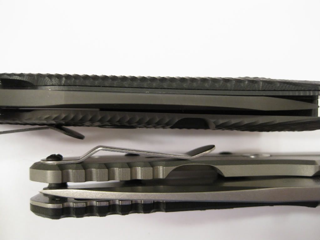

couple of pics so you can see the cutout of the ti next to a 300
Thanks for the great pics. The 0551 looks thinner in the pics. Got my digital calipers out and measured the Ti thickness in the cut-outs on my 0551 and 0301. 0551=0.048" thick and 0301=0.044" thick.
That's great idea and good that you posted that info, since the 0551 looks like it's ready to have a "blow out" at the cut out. Comforting to know it's cut out still leaves a thicker bit of titanium than that of the proven ZT 0301. :thumbup:
Can't imagine either one failing at the cut out unless you're doing something "crazy". If I can figure out how to do close ups I'll try to do pics of both readings and include my 0300, too.
You know, there is a reason why titanium is used for the lock-side handle for frame-lock folding knives, specifically this material's ability to flex and not eventually crack from stress.
The lockbar stabilizer mitigates any problem with this. That is the primary design function of the part. Rick has a clearly written explanation of the various design characteristics of the XM-18 on his website. Two of these items explained on Ricks website, the Lockbar Stabilizer and the thumbstud/bladestop, apply to this ZT model. It's all about eliminating torque points on a folder.
CZIV, I'm not picking on you personally, there are a lot of people on these forums who get caught up in these issues. The wrong ideas tend to spread until they become almost a Gospel message. It's important to remember the things like you mentioned: the ZT 301's don't suffer framelock cutout failures. So why is it a new "Issue" with the newest ZT?
If people took the time to research Ricks design philosophy, via his website, they would have a much better understanding of how and why Hinderer/Strider, (and, to some extent, the CRK Umnumzaan), are built the way they are. The questions of “weak”, and “possible failure”, points would be moot.
If people took the time to research Ricks design philosophy, via his website, they would have a much better understanding of how and why Hinderer/Strider, (and, to some extent, the CRK Umnumzaan), are built the way they are. The questions of “strength”, and “possible failure”, points would be moot.
bearcut - I'm not picking on you personally, but some of us feel we have the right to express an "opinion" such as "looks like" it's ready to have a blow out.
This means grammatically - "has the appearance of." Further, anyone who thinks a forum post that contains someone's opinion that some "widget" gives that observer the "appearance" of whatever, and takes it as a Gospel message, probably shouldn't be allowed to own a knife - in this case.

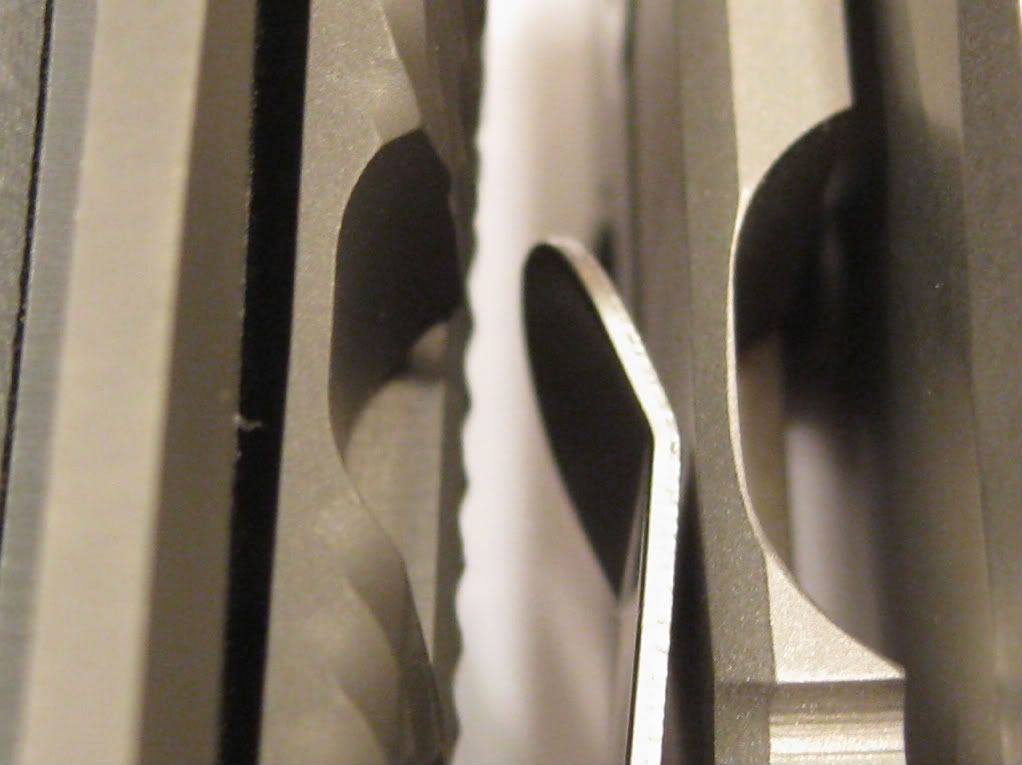

This picture illustrates what "looks like" the 0551's thin lock-bar cut out and it's been pointed out more than once by other members in the 2nd (older) ZT0550 Pictures thread. Optical illusion pic:
No worries, I didn't take it personally.
I'm pointing out the fatal flaws of "group think" that tends to pervade BF at times.
