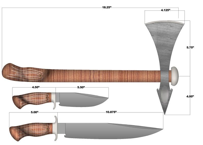

Ok, sounds good. I didn't hear anything from you so I thought maybe something came up and went ahead and drew everything up in photoshop.
I've just sent an email out to the Newbie Team. We are in the final stages of design and nearly ready to begin determining who will perform which tasks. I am putting the contents of my email plus the two proposed designs here in the thread as well. Any comments from the team can be either be made here, or by responding to my email.
Comments from the more advanced makers, and all others (such as, plain old knife lovers, purveyors, collectors, etc.) is welcome and encouraged.

Newbie Team:
We're closing in on final drawings. I've attached the two proposals for the teams scrutiny or vote.
They are both pretty much identical, just drawn with different programs and some slight differences. The three pdf drawings are by Eric. The jpg drawing is by Jared. We are really close to a final set of drawings.
On the drawing with the three pieces together (Jareds drawings), I like:
The look of the inlaid wire, as far as the pattern is concerned.
The flat spot on the arrow head side of the hawk. It will be a great place to put all of our names! A great idea!
The guard on the hunter.
On the other set of three different pdf drawings (Erics drawings), I like:
The guard on the bowie and on the hunter. If we go with the two guard designs that I've just mentioned for the hunter and the bowie, they will have a better match to
the overall shape and design. I've looked at the two different hunter designs side by side and I think the guards are designed almost identical.
I like having two pins in all of the handles from a construction perspective. I like the look of one pin better, but one pin in a full tang hunter would be difficult to pull off.
Does anyone in our group have experience with "hidden pin" construction on full tang handles? If we have someone capable of constructing a one
pin full tang handle, then we should go with the one pin design to show off the beautiful "Moran" curly maple.
I like all of the dimensions on Erics drawings! When I look at them side by side with Jareds drawings, I don't see any difference when I put a ruler against them.
I feel that both of them have nailed the proportions of handle to blade really well!!
Does anyone disagree with my thoughts? If no one disagrees, I suggest that we make those subtle changes to combine the two similar designs and move forward.

One thing we need to add to the drawings is blade and tang thicknesses! Especially at the ricasso areas. I'd like to keep the three pieces as light weight as possible, but still strong enough to perform the tasks for which they are constructed. Any suggestions?

Here are the requested modifications (my emails are still bouncing for the group).
I can do the hidden pin portion. I was also thinking if we still want the through pin method, why not hide the pins in the inlay channels? We could put multiple small pins all throughout that way. Just a thought. Also, for the thicknesses I personally would go 1/16" on the hunter and 3/16" on the bowie, but I know not everyone likes to go that thin :)
I agree with your suggestion for the bowie thickness. I think that the hunter thickness should be about 1/8". I've never done hidden pins, so if it's doable (hiding them in the wire inlay channels) I'm all for it!
I do however, really like having one mosaic pin. The wire inlay in this design looks like the trails coming off of a comet. That mosaic pin with the inlay will create a nice flow to the handle design, IMHO.
