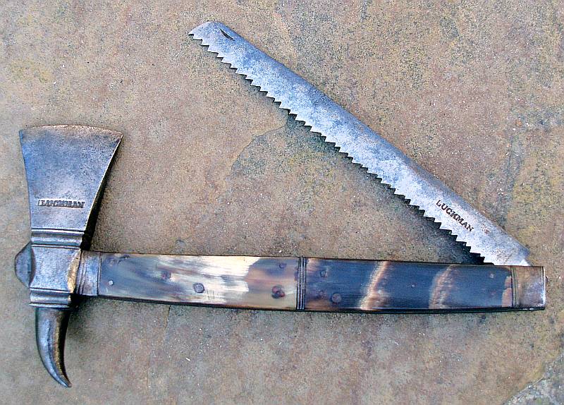

What if we did a multi-section hawk? I've never actually seen one, but have the hand in sections? I see a weakness problem with it possibly, but just a thought...
You know, this must look like the most schizophrenic group of knifemakers around to people who don't get our emails :)
That said, I'll add fuel to the fire and keep right on chatting...
I'll start playing with pool & eye here soon to see what nifty things I can come up with. I've got another billet of a low layer double bar twist to work on first for somebody, but hopefully that won't take too long. Of course, nothing will be happening in the shop until at least next weekend since I'm out of town (again!) :(
I've never seen a multi-part hawk either. How do we make something we've never seen? I like the idea of a spike 'hawk or a pipe 'hawk personally. Maybe I'll start some drawing and see what I come up with...
-d
checkisout! Maybe we could make something like this. If not, it's cool to look at.

I've been running the multi-handle hawk idea in my head, ever since you guys mentioned it. We could use two different burl patterns, alternating them down the handle in a "bamboo" shape. To hold them all together, we could have a piece of flat bar (3/16" x 1/2" mild steel) running through the center from one end to the other. The burls could be slotted to accept the flat bar, with the whole thing screwed on from each end with gun blued mild steel at each end. With the insides epoxied up strong around the flat bar it would be a very strong handle, even though it is made of multiple parts.
We could then make the camp knife out of one of the two burls and the drop point hunter out of the other of the two burls.
