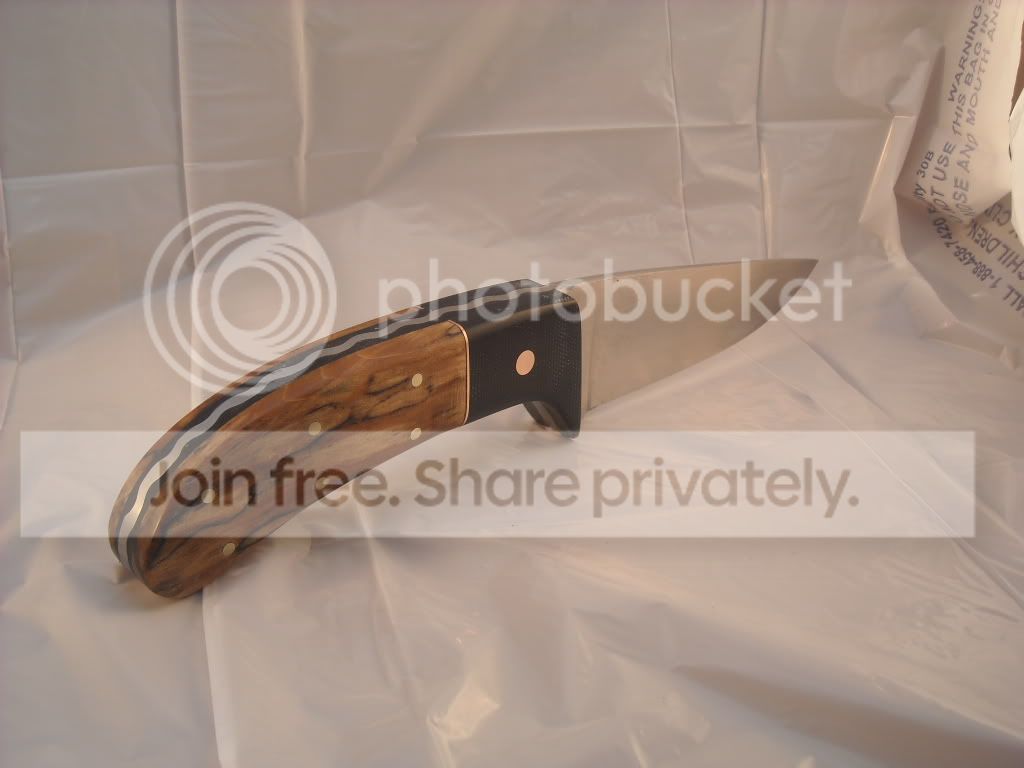

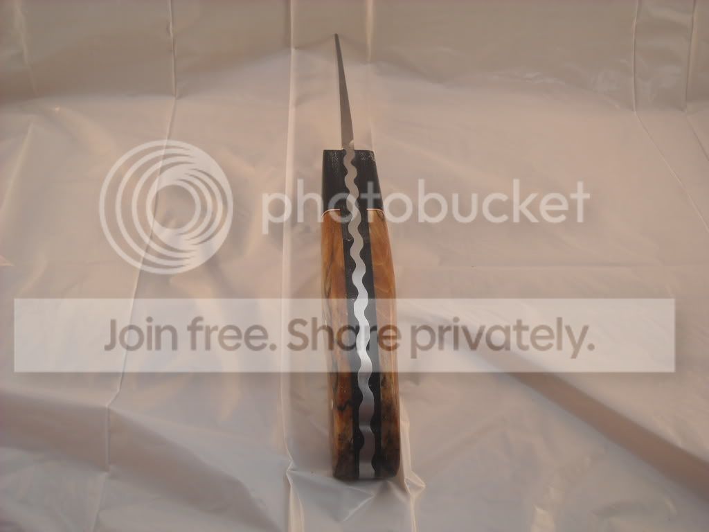

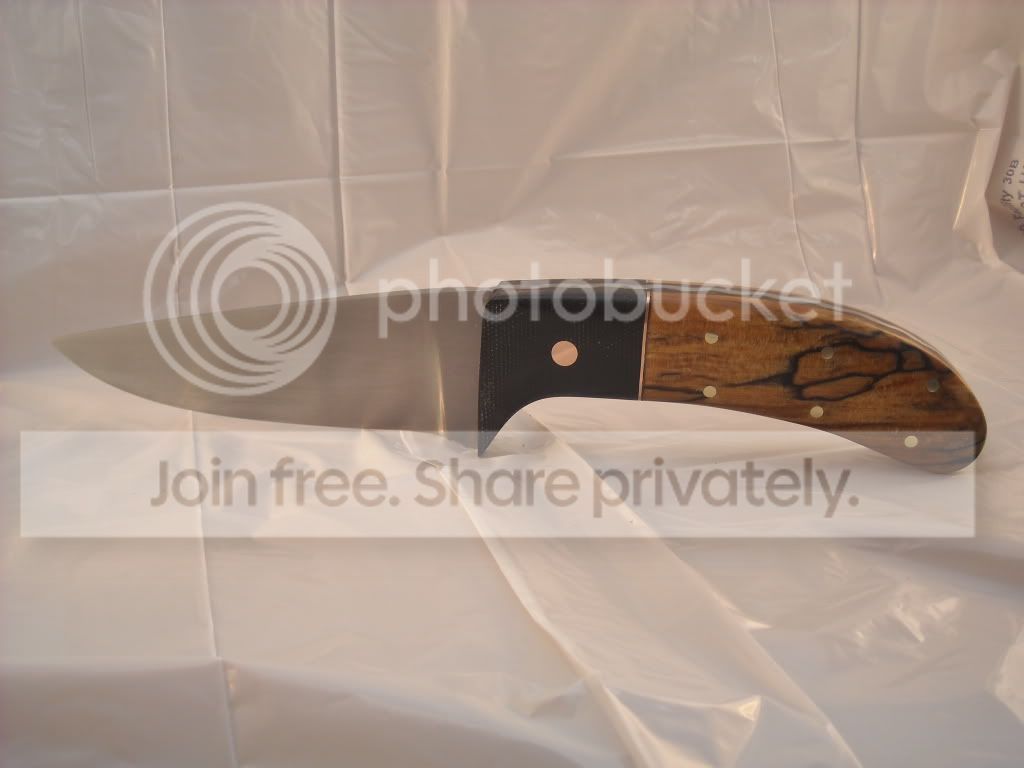

I'm ready...finally! Excuse my ghetto light box photo's. It was raining here today and is suppose to be nasty through Tue.
This was my 2nd attempt at this knife. The first attempt ended in a warped and twisted blade! This knife is made from Aldo's 3/16 1084. Blade is 4 1/4" from the tip to the plunge. It's about 10" overall.
It's either my 9th or 10th knife I've made so far and the first one with bolsters. I used a 1/4" copper pin on the bolsters and a piece of copper sheet metal for the spacer and brass pins in the scales (thought I had copper 1/8th pins, but they turned out to be 1/16th and I'd already drilled the holes!) It was my first time piecing together a knife handle and I'm not sure I did it right. Couldn't find a tutorial on it (although there are plenty on how to attach a bolster!)
Bolster is black canvas micarta and the scales are stabilized spalted maple. Black g-10 liner tops it off. There's some basic file work along the spine as well. Blade was belt finished with a Gator A45 then hand sanded at 400.
There's a few flaws, mainly a small gouge in the edge when I was trying to even up the bottom of the ricaso. Kinda forgot to watch everything at once...:) I'll start on the sheath tomorrow.
wow. that is really pretty.

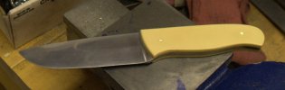

Specs:
1/8" 440c 59.5Rc blade
1/32" Yellow fibre spacer
1/8" Ivory paper micarta handle
1/8" brass pins
9-1/4" OAL
4-1/2" blade
No sheath, and no case. I apologise. Next year, no misunderstandings.
