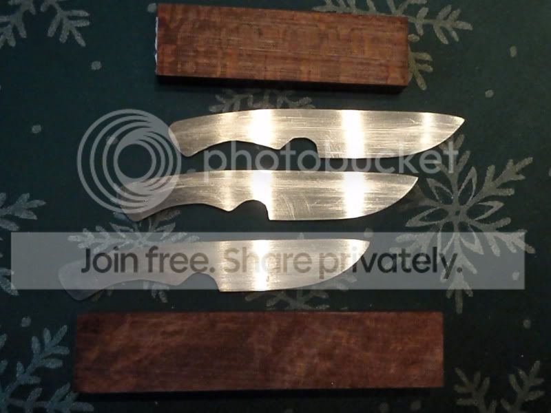

As I mentioned I will be making 3 of the same blade... and the best of the 3 will be submitted to this KITH
All 3 are profiled out to about 95%. The handles need work before I will drill holes and then bevel.
2 of them will get handled in redwood burl and one in dyed lacewood. I got a great deal on an 8.25" block from Mark so it was perfect for doing two knives!
I also have some wrought iron coming my way... I'm considering doing dovetailed wrought or brass bolsters... attached with hidden (for wrought) and peened (for brass) pins :D. I will try this one one knife, if it doesn't work, the other two will just get straight handles.. but I really want to try some bolsters!!!!

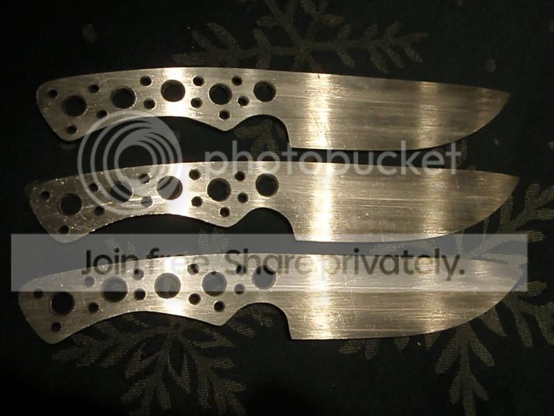

I cleaned up the profiles by file/handsanding this evening (2 weeks without shop time really blew...) and drilled and countersunk all my holes. Main bevels will be rough ground in by monday or tuesday I hope... and I hope to have these off to heat-treating by the end of next weekend.

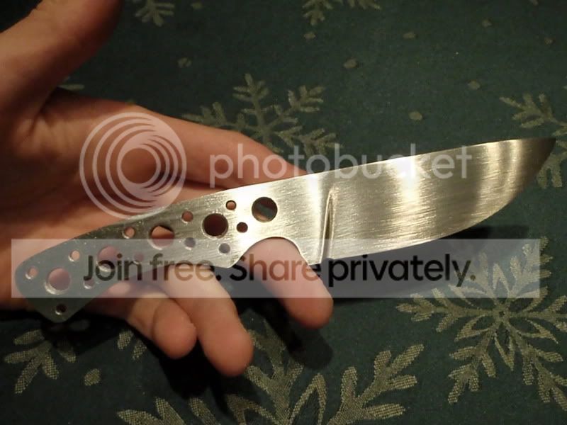

Had some free time tonight since I finished all my drafting work at school... got the first of 3 blades rough ground, draw-filed and sanded to 120grit on one side.

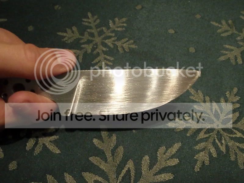

Tried a new method to establishing a plunge. My grinder has a very crappy platen.. and I'm just kind of dealing with it until I upgrade to a 2x72. I took a 1/4" round file and cut int he plunges first, and then ground up to them. This kept them even and probably my best looking plunges to date. Here's hoping the other 2 turn out this nice :D
If only I could take a picture worth a damn...
If I can do this each evening this week (mon and tues are my busiest days anyways) I will be in good shape to get these out to heat-treating by the end of this weekend. I also have the whole weekend free for once... so while I will have almost zero time after then it is great because they will just be out in the mail =)
Looking good, Jonathan.
Lot's of people struggle with plunge lines that I have seen. Yours look very nice but also look deeper than the bevel. Two things that helped me are hand sanding on a precision granite slab with the paper rolled over the edge (thanks: wheeler and stacy) and or j-flex belts in 120-220grit 1/16-3/16" over the edge of the platen (thanks: mickley and many others). A little experimentation pays off.
A precision granite slab is a great tool anyway. Stacy posted about one for sale at woodcraft in January for $19, $26 to your door. I don't know how often they are that cheap, but keep your eyes open, I use mine on every knife for checking flatness or hand sanding at a minimum.
Woodcraft.com has those granite slabs. I bought mine, 12x9x2 for the sale price and it's awesome. Keep checking back with them for when they go on sale. Also, you can check with a local monument company or granite countertop company for remnants....sometimes they're free!!

Thanks Erik,
After your comment about the plunge being lower I took a closer look at the blade. I think the photo is just playing tricks.. I even took my calipers to make sure, the plnge is definitely flush/level with the rest of the grind. I did use a similar method to the granite slab, I just used a large piece of square G-10 instead to work the plunge. I'm going to get a slab soon when I can find it for cheap in canada, may even just swing over to HD and find a granite tile or something.
Hopefully conversion to a 2x72 in the future and using that method with the J-flex will improve them even further. Stuck with the archaic methods for now though it seems ;)
This KITH is making me work extra hard to get out all the scratches, and even pay special attention to the edge thickness. I sitting at ~0.030 for the whole edge currently, and will cut it to about 0.020-0.025 after sanding before heat-treat. Hopefully this will make for some better performing blades =)
