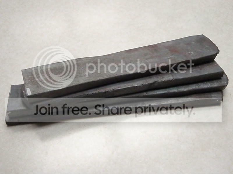

Had a Chance to Forge up another blank

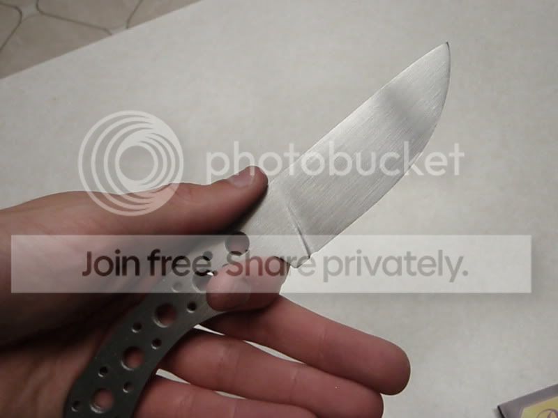

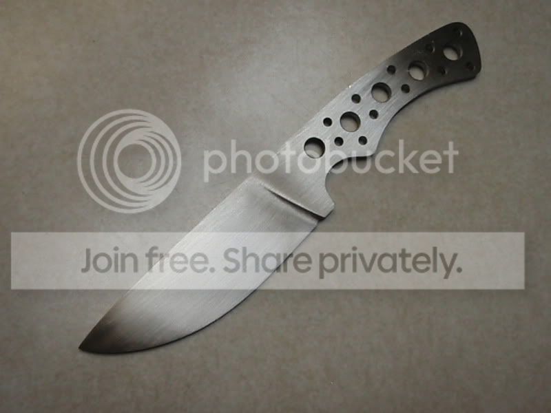

I also got some grinding done,
The shiny one is out of a piece of CPM 154 I had, so that one is off to Peters Heat Treat tomorrow, then I can concentrate on the other two forged blades.

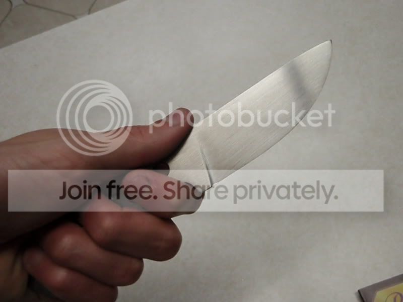

Everyone, If you were to receive a bushcraft style knife, then ask yourself this question: jimping or no jimping.
I would like to know what you guys would prefer, and where.

Personally, I'd take the jimping. But it's not that big of deal to me. I have knives with and without jimping and I like 'em all!!
Jimping is nice but very hard to make depth of cuts and spacing even without a mill, can be done ... just difficult, at least for me.
I honestly don't care for jimping at all. I have some knives with it and i still use them, however it just isn't appealing to me. I do not put them on any of my knives. It is your knife however so make it to the standards you like.
Dan
I have made several knives for hunting buddies that requested the jimping along the spine for a little extra control when the knife is covered in blood. Having used both with and without, I prefer with.

Got the whole knife 98% sanded at 120 grit. Evened up the edge all over and drawfiled the bevels nice and flat on the remaining side. I'm sitting at 0.025 on the whole edge at the moment. That should be about 0.020 by the end of the hand sanding to 400grit before heat-treating. Calipers were a great investment :thumbup:
