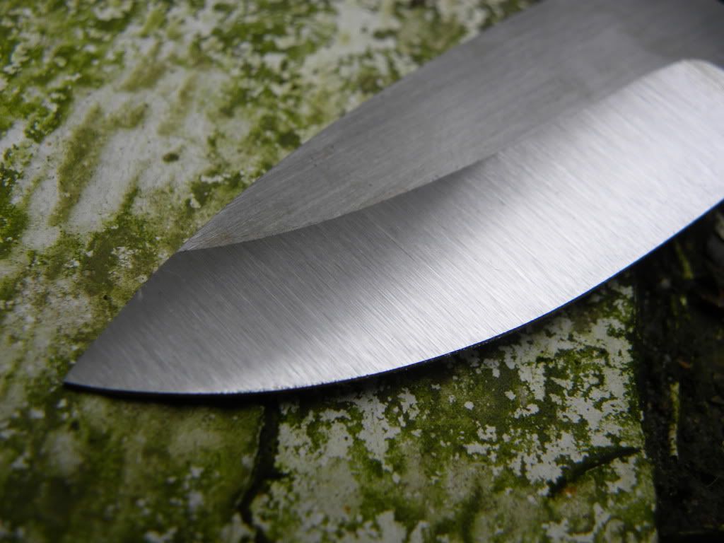

Perhaps you don't understand that my inexperience with the grinder caused the problems. Continued used of the grinder would only worsen the problems.
If you read between the lines you may see my frustration... which I keep at bay.
Keep on grinding! You are doing great!
Get some 1084 and grind 10 of them at the grinder, by the time you get to the last one you will want to re-do the first few. :D It just takes time and repetition to get good.
Greg, if you ever want to get together and work on some grinding together, look me up. I'm just up the 405 from you and while I'm below an apprentice at this point, I'm sure there are things the two of us can pick up from each other. Just a thought. Most of my grinds are convex however I set a lot of my original bevels on the flat platen. This one is preheat treat with a 120 belt finish.
Thanks for the offer, Michael. I'll probably take you up on it some day this spring/summer. One thing to bear in mind about this blade, it started off as a hollow grind, which is one of the reasons it's been such a pain in the ass.
Anyway, I'm finally past the stage of working out dimples and divots, and now I'm moving forward on all fronts.
