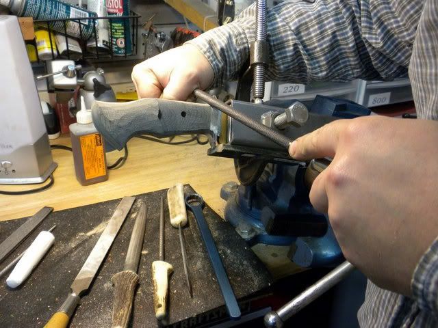

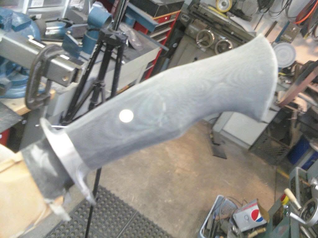

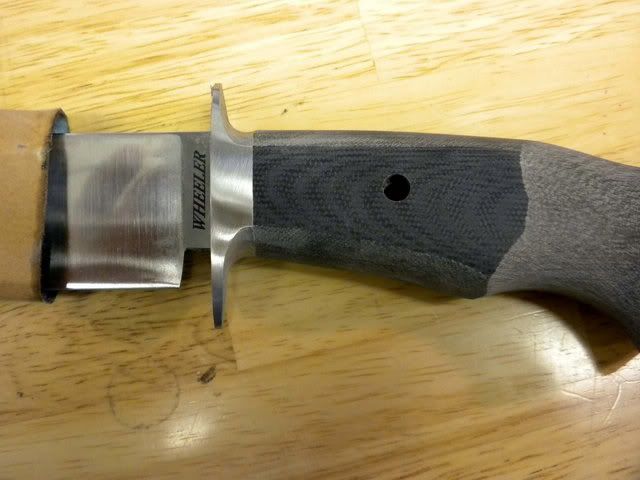

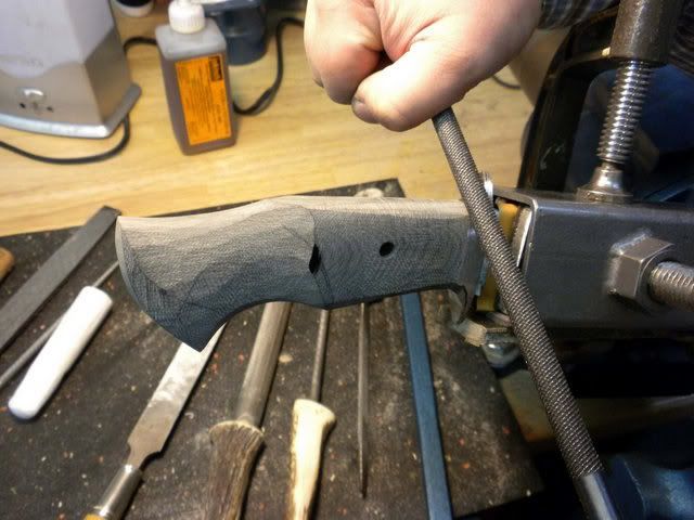

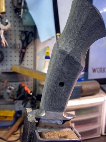

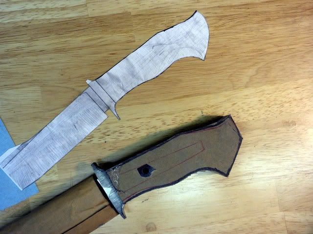

Nick writes

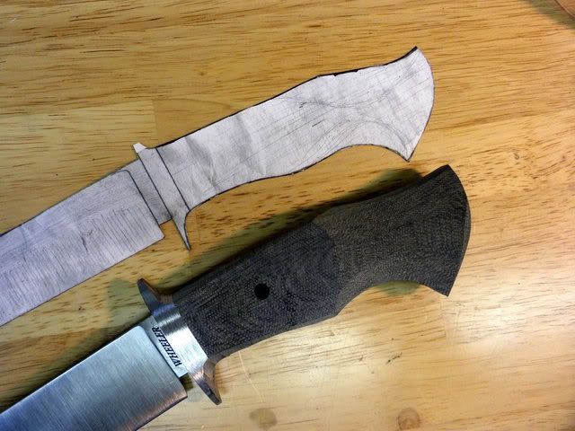

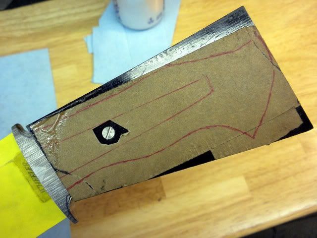

Here's some more pics Joe!
I really like how the knife feels. *I'm leaving more meat in the handle than I usually would, to help with the weight of the blade, and also retention with a snap cut.
I'm putting a hidden thread Cobry bolt in this one... it's very strong and I think the size will go well with the beefy-ness of this piece. :) *I drill and counter-bore the handle for it when in block form, but wait to epoxy it in so that I can just saw most of the bulk off and not deal with it building up heat during rough shaping. *:)
