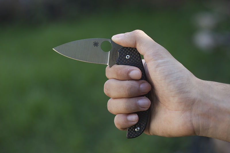

Based on the OP I fail to see how people are concluding abuse at this point? There is no mention of chopping, prying, twisting or anything of the sort. The statement that he "pulled it out from a wood log" isn't enough info to determine anything.
I am curious to know what exactly happened when the knife closed. Spyderco design their knives with safety in mind. They design their knives for accidental closures that the user will not be cut.

1. I didn't put the knife thru any hard test , I was pulling the knife out of 2.5" log of wood that it was stack in to make a stick for my kid for camping , as I pulled the knife probably not striate , the knife fold on my hand and got out of the log.
yes I know a fixed blade won't do it but there are times you go walking / biking and you have only your folder in your pocket
yes I know I could be more careful , but that knife got me to feel very comfortable with it so I got less aware of the danger
I got lots of fixed blades from busse (ash1, basic 6 , rodent , fsh...) to mora but you don't always carry them on you
I don't blame no one but me but I do ask If you know a folding knife so magical that will do all of the things a small fixed blade will do without failing ( ad10 comes to mind but I still didn't got one , waiting for the one to sell international in a reasonable price )

...I wouldn't swear off of frame/liner locks, I would just suggest taking this as a learning experience. Treat all folders like a slipjoint, and if there is a chance force can be applied to the spine go with a fixed blade. Fixed blades have no moving parts that can fail. Something like an Izula 2 will do everything you could need, and the Izula/Candiru are just compact versions in case you want size variations...
Honestly, the "hard use" folder is the worst thing to happen to knives since not naming steels. I don't care how "tough" you call your folder, it is still weaker than a fixed blade. Solid steel beats pieces of steel wedged against each other every day. The blade can be thick for prying, but anything else is dangerous (chopping primarily). The purpose of a folder is space conservation at the cost of strength. It is convenience over function.
I'm not saying never carry a folder, I am saying know its purpose. Err on the side of caution. Better to carry two knives (fixed and folder) than lop a finger off.
I held my Tuff in my left hand and concluded, considering where his cut is located, he had to have a half grip on the knife. With a full grip the blade would have contacted his finger on the un-sharpened part of the blade. I would also highly suspect the blade was stuck in the log and he might have twisted the knife with a good deal of force, twisting the locking bar off it's contact. If he could have just pulled it straight out, I can't see where the lock-bar would have any force on it to cause it to release. Until he provides more detailed information we all are just coming up with our own theories. (OK he did, but I was typing at the time)
All locks on folders have their weak points, a lock back can slip out of it's notch and you could grip a axis lock in a manner, while pulling back on the handle and release it. You can twist a frame locks handle with enough force to cause it to slip. Dirt can get in any of them and compromise the locks. You treat folders like fixed blades, IMO you're going to be cut sooner or later. I love to carry folders because they are more compact, but if I know I'm going to be using a knife hard, I'll pick up a fixed blade.

I don't care what brand, what price, who the designer de jour is when it comes to folders, if you are a user and not a collector, the lock, any and every lock, will eventually fail; and when I say user, I don't mean using your big azz Strider at work cutting cardboard, twine, and tape. For me, all my folders that see regular use and in a pinch go from simply cutting open a taped box, all the way up to slicing meat, veggies, and fruit when I'm on the road, or in a backyard BBQ...anything more intense would and should require a fixed blade. There's a reason you don't see a folding bayonet affixed to a rifle.;)

"Use" doesn't mean needlessly and stupidly batoning firewood, or needlessly and stupidly prying fatwood out of a stump. If you use a knife like a knife, it is exceptionally difficult to cut yourself.

Knife was not being used hard.
Then why did he have it in a half grip? It had to be if it folded and cut his left index finger where it did. Why would a person have a knife with a well designed handle like that in a half grip? Could it be because they would want to apply more force to free a stuck blade? A half grip would give more leverage on the stuck blade and I'd bet he was twisting it as hard as he could, to try to get it free. These modern locks just don't fail so easy, unless you do something wrong.
Part of the design of a frame lock is that as you grip it, you are applying pressure to the lock making it more 'secure'. Unfortunately, if you are left handed, it's not going to be ideal, and you can't really take advantage of this function. That being said, if the knife was held up in the choil area when pulling it out, if it did experience lock failure, it would not have been able to cut due to the choil making first contact with the fingers before the blade.
If I was a lefty, I would probably stay away from frame locks as well unless it was designed for a lefty.
Get a fixed blade, no folder will ever have the strength and piece of mind a fixed will. I have seen almost all types of folders fail (liners and frames more so than others). Things with choils do help depending on how your grip is when the knife fails, it could stop on your finger with the choile before the blade bits. The axis locks are great and the cold steels work well although I personally dont like cold steel knives. You could try something like a Balisong or a paratrooper knife. I never use my balis for hard use ( or any folder for that matter). Multi-tools keep the blade pretty safe, most have locks in combination with the handles of the tool sandwich the knife so even if it fold on you it will stop. I say just get a smaller fixed blade. Esee Izula is excellent size for almost every task, super tough steel and awesome warranty. Comes with a great sheath and you can get a clip for it, I wear mine IWB. If that's not a long enough blade they esee 3 or 4 should suite you. You can beat the bag out of those knives and they will come right back, easy edge to sharpen as well.
If your using knives that hard on a regular basis I would get a folder to do a fixed blades job.
