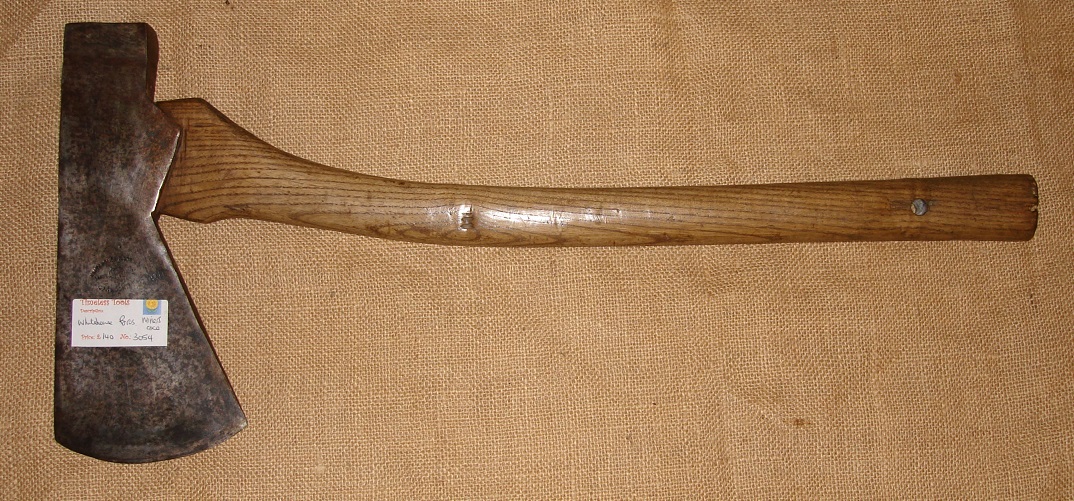

Tuatahi axes have a similarly small poll, but notice the trajectory of the main length of the handle--it points right towards the center of gravity. The neck is offset to allow for this.
This picture is self explanatory to folks that appreciate axes (a bona fide Ferrari amongst the Toyota Corollas/Chevy Cavaliers and Dodge Powerwagons that we ogle over) but selecting and fitting a durable haft to this particular head is not something an 'ordinary stiff' merely seeking a new handle at the hardware store is going to find, nor if he/she did find one, is it going to 'hang together' for very long.
Although the "ordinary stiff" is unlikely to do a good job of fitting even a conventional American hardware store handle to a domestic head, either. We've all seen those photos. :D A handle with less offset would still work fine, but you'd need to be more mindful of your technique rather than it being so automatic as with a single-axie handle. Most handles available today don't have as much offset in the neck as they ought to. The only ones I've seen I consider as having the right amount are the ones that Snow & Nealley uses on their full-sized axes.
