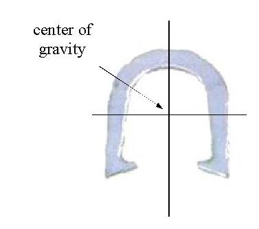

No offense, but this doesn't sound right. If correct, this would mean that a one-handed carving axe, with the grip portion of a curved handle being aligned with the cutting edge, would behave the same as if the axe had a straight handle where the grip is aligned with the eye (when a substantial poll results in the center of gravity being in the eye). This is just one of the counter-examples that come to mind.
That's because the balance impacts the presentation of the bit. The axe is balanced, but that does not mean that the presentation of the bit is correct for the intended purpose. Remember that if the handle is not aligned along a unified axle that a change in the grip point results in a new axle, which changes the presentation of the bit in use. However, there will be no wobble introduced by a single active grip point, which is what I meant by identical behavior.
The adze balance demonstration is a bad example. Although balance plays a role, the most important consideration is the angle of presentation of the bit to the stick of wood. That is why the curve is in the haft, it is not curved for a balance point. Haven't you wondered why the haft shape is different for a carpenters adze and a shipwrights adze, while using the same weight and balance head? To an extent, this is also true for axes. That is why, depending on who is chopping and what the intended use is, sometimes you need a straight haft and sometimes you need a curved haft on the same head. This balance thing is not the end all to this discussion as some here would have you believe. There are a lot of variables that are being left out of the discussion.
Actually, that has been discussed. It is curved both for a balance point and for an angle of presentation. If you were to keep that straight section on the handle pointed towards that stamp (where the balance of the head is) but had the neck curved in such a way that that it was doing so at a different angle, it would remain in perfect balance while changing the presentation of the bit in use. Balance is only one aspect of the total equation, and the least important of the three in the sense that one should not be concerned if a tool is balanced or not, because the tool will always attempt to balance itself (in fact, it is this attempt at self-balancing that is responsible for tool wobble with off-axis handles) but the balance of the tool affects the presentation of the bit relative to the cutting stroke. You can have the handle on a unified axis but have the bit presentation too open or closed for your given cutting task because of the orientation of the axle the handle is aligned with. This is precisely why understanding axle behavior is so important, because creating an optimized handle for a tool is so dependent on not merely creating a unified axle, but having that axle properly aligned for your intended use.
