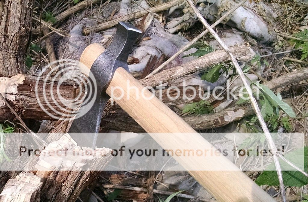

From this
To this
To this
And now like this
I rather like it like this.... I "may" etch it 1 more time, but doubt ill stonewash it... I like the temper lines and would rather not "polish" them away by stonewashing it....
Now i need to find a replacement handle... Suggestions? Then ill coat it/darken it up and maybe flame it a bit.... I wish i could tie a turks knot... Would love to put a big one up towards the head and p-wrap the handle some....

How did you etch it? Ratio of water to PCB etchant? Time?

First off... I originally tried the PCB etchant from radio shack... Then i got some pure ferric chloride off of the river store... Im not sure if the PCB has other ingredients, forgot to even look before throwing the bottle away, or if i just got a bad bottle but i didnt get as good of results from the radio shack stuff as i did the pure FC from the river store... Lots of factors could of played a hand in this though.. this is just for clarification, i thought i should point out im using pure FC not PCB if there is any difference.
That being said.... I guesstimate the ratio... About 75% FC to 25% water.... I have tried pure FC, i have tried half and half, i have tried several ratios... It seems a little bit of water helps etch it better, But i didnt spend weeks or months testing, i just tried a few things and found what worked well for me and stuck with it.
I etched for about 30 minutes in 10 minute increments, took it out, neutralized it and cleaned it up, then i took cotton balls and kind of polished some FC into the steel in circular motions for a while.. Then neutralized again and cleaned it up and here we are. :D

I got to here then remembered the hawk laying around so I put the haft on and gave it a shot. After about 6 whacks it was through. Barely any chuncks, it more or less smashed it until it snapped. Maybe my technique, I dunno. The Dex Wharncliffe 9 blew it away. I'll have more time with it camping this weekend.
