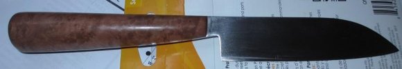

Not your every day mirror edge

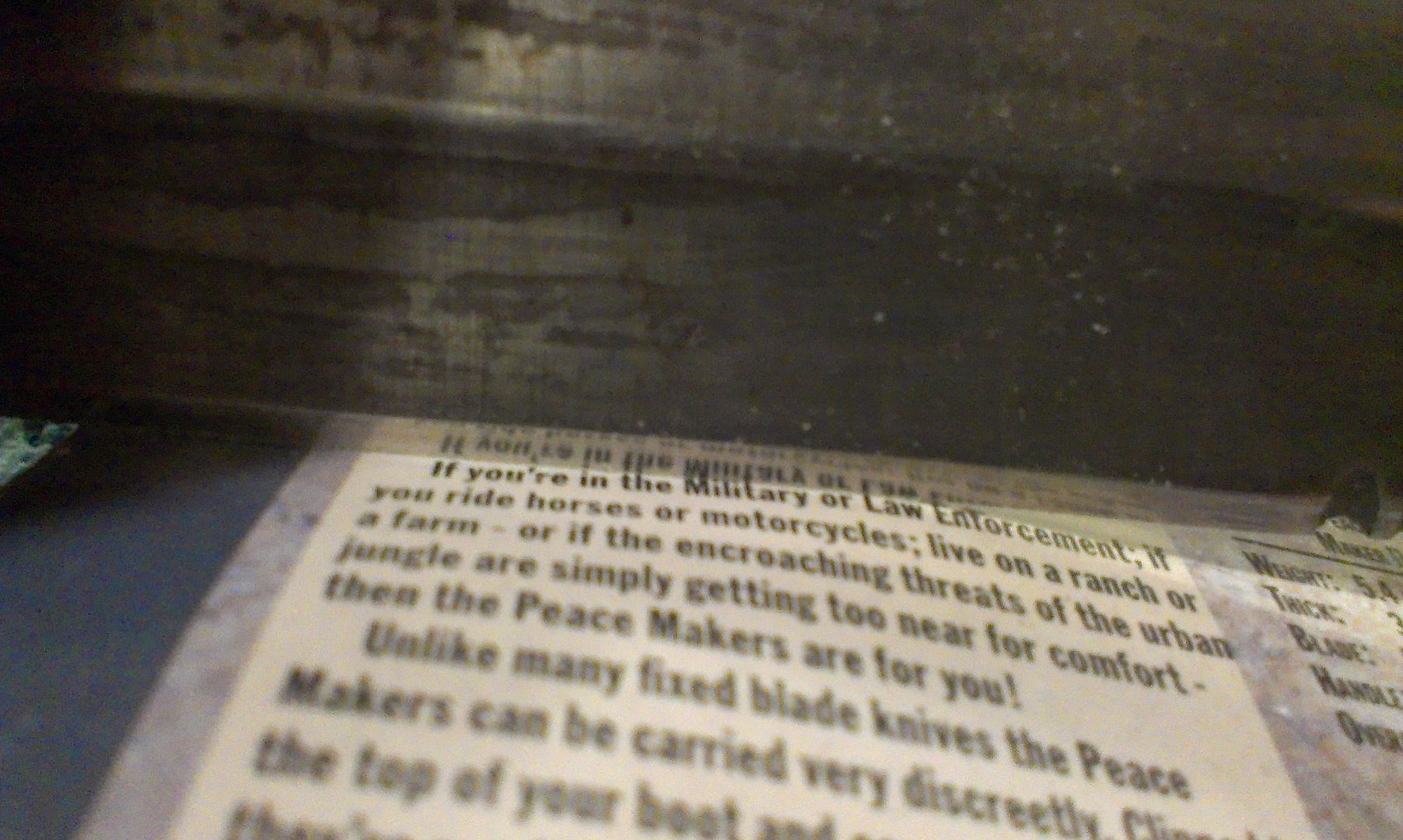

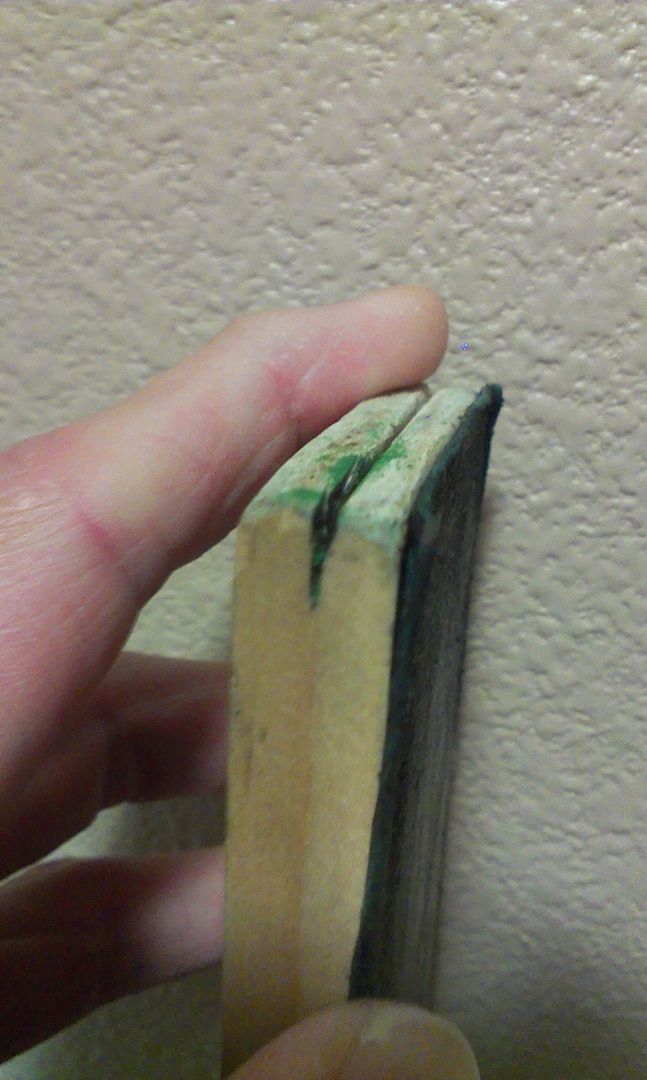

These shots aren't very revealing, but I'll post them anyway since I bothered to take them. :D
This is the notch I used.
Seemed like the notch was good. The edge didn't fit, so it had to be forced which seemed like the same as cutting a new notch.

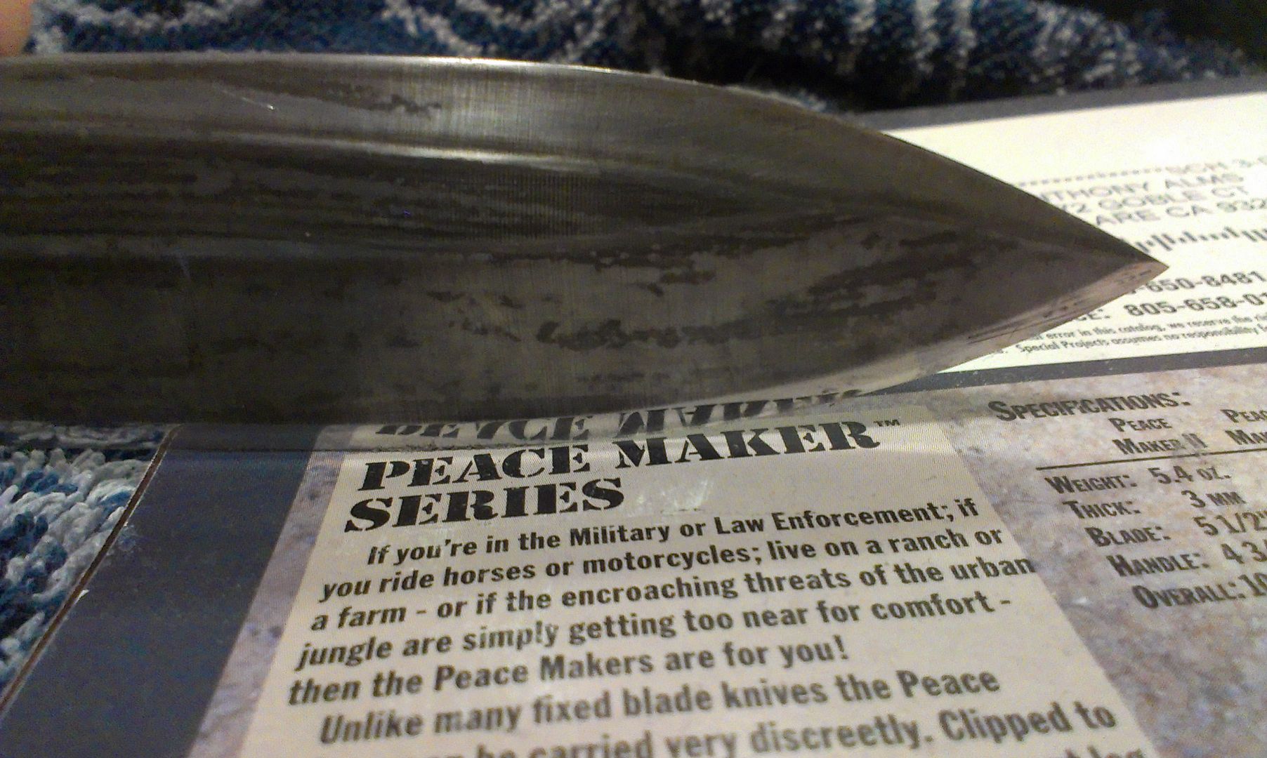

The part of the edge is used in the notch.
And part of the edge as it was before I tried the notch.
It was fairly polished before trying. Again, the pics don't really show much, but it was less polished after.
I think it was the compound, or my technique. The apex was fine. Steel is 1075.

That could be it too. The bevel had vertical scratches (spine to edge) so I figured it would come out more polished since, usually, a scratch pattern in opposite directions is better than one in terms of getting a finer finish. The burnishing from the compound may not match the scratch from the belt grinder though. Or, it's possible that I didn't use the technique long enough to attain good results.

52100 mini petty knife
Reflection is not super mirror but not bad after spent a few minutes using the groove sharpener and just 2 grits progression.
