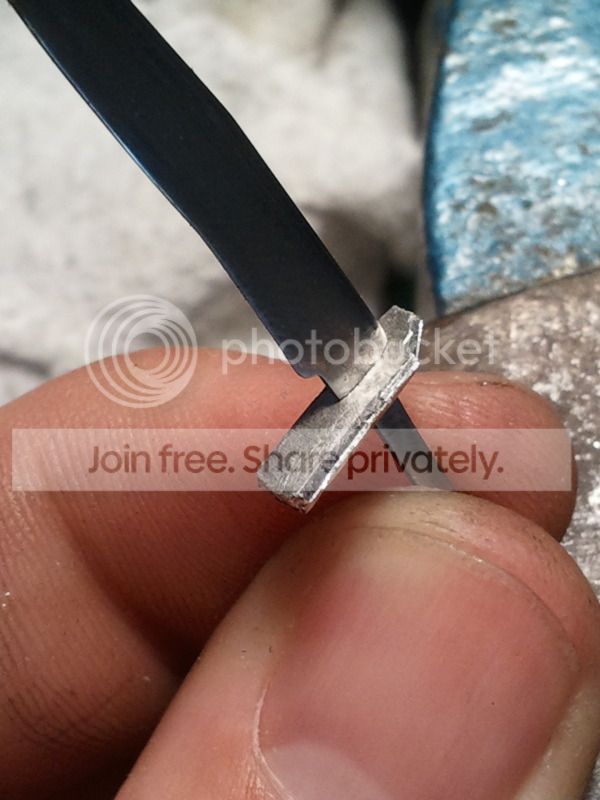

Started fitting the guard today. Using .999 silver. I found out real quick how good of a conductor silver is from just a couple 2 second passes on worn out 320 paper on the 9" disc! This stuff gets hot quick and stays hot! My hands are hurting now so I'm done for the day. I got 95% of finish sanding done on the blade up 2000# and will bring it back down to a clean 1000# when finished.
Fitting the tang hole...

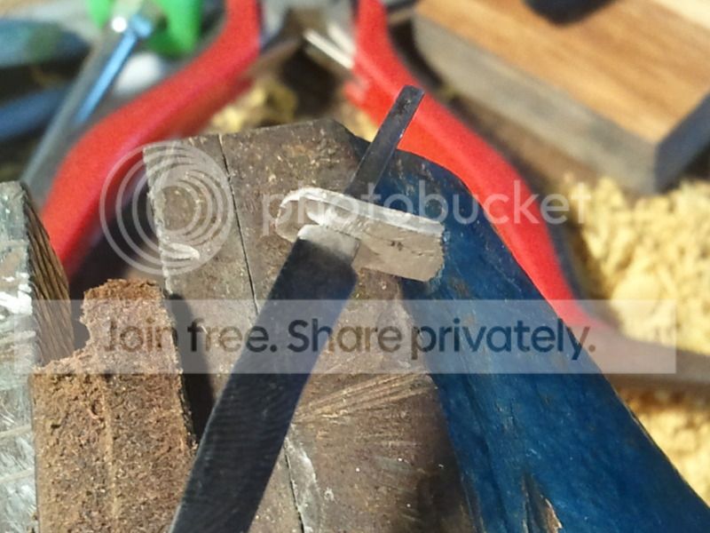

Got the top of the guard bent forward and better fit to the ricasso. Also started to trim down closer to final size...

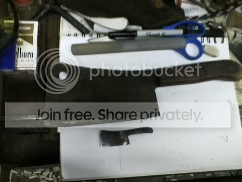

Here is mine. I hope someone here likes it enough to be happy to get it in the KITH. I tried to blend the line for the handle mortise as best as I could. I'm probably going to soak the wraps in epoxy a couple of more times to make sure the bond is extra good too.
I'm trying to think of something clever to serve as a base for it, something to sit on a desk and hold it. A skull or a rock or something.
