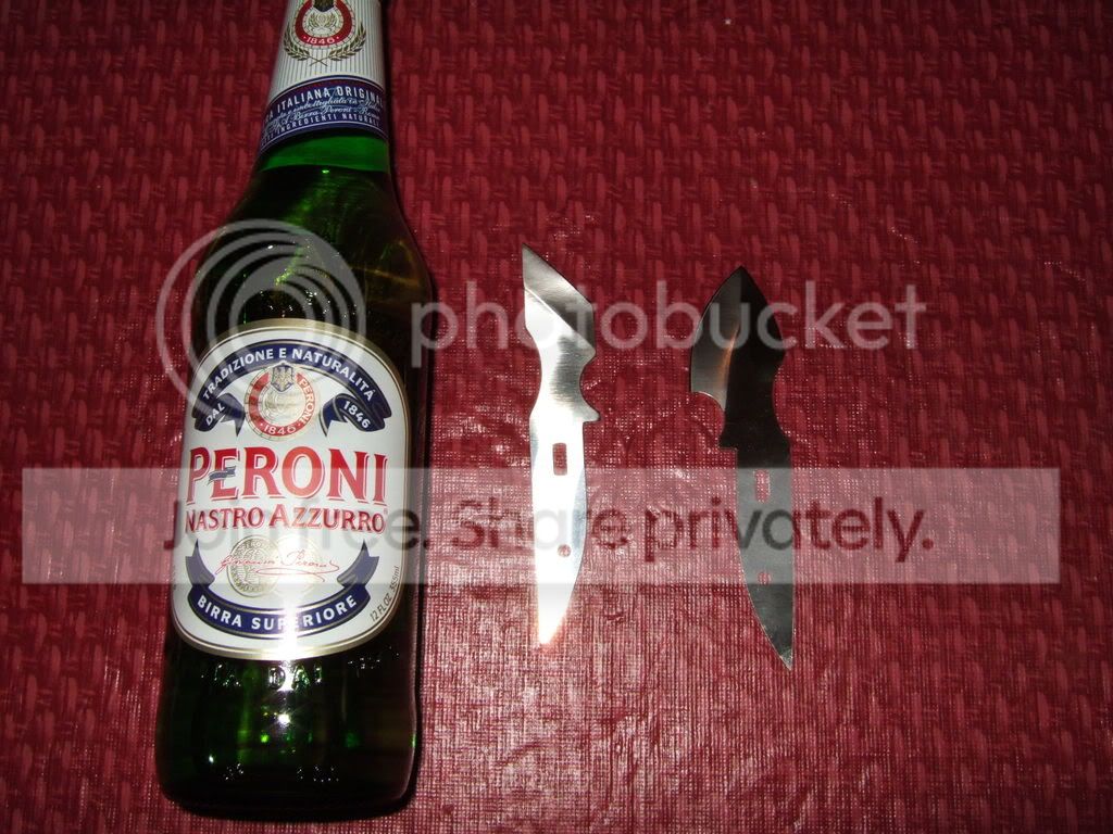

E-mail you addie (mneedham51@hotmail.com), I'll send you some more "technical" manuals and my address for the books. I've actually got some small knife blanks laying around if you want to grip one, how do you like these little guys in 440C (Jantz Cutlery)?, there is a third, more traditional pattern around here too... Maybe a piggyback for the Fusion Battle Misanthropist your putting together....
