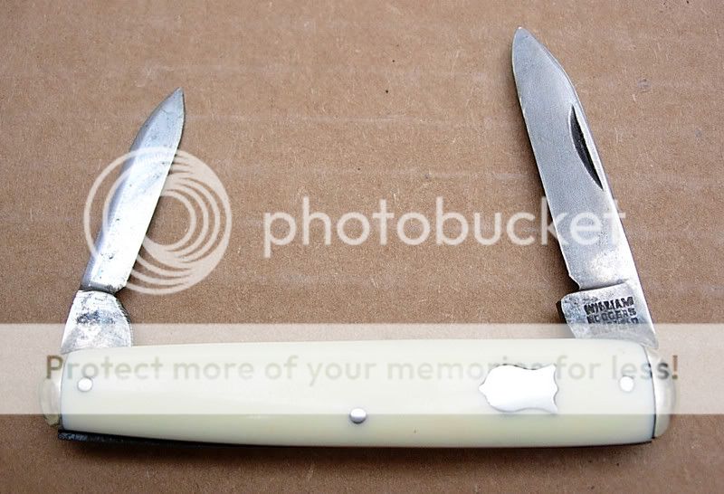

I am certainly no expert on William Rodgers as a maker or the trademark and it's use. I can attest to the special quality of this 3 spring, 5 blade knife being exceptional quality. I recently sold a small William Rodger pen knife with SS-77 on the inside liner (made by Stan Shaw). Although of good quality it was no match for the 3 spring. Here is my listing I sold it from:
Nice petite shadow pen knife marked WILLIAM / RODGERS /SHEFFIELD, secondary marked CUT (knife) MY WAY. Inside liner is SS-77 mark indicating Stan Shaw built this one. Blades are file worked, shiny and show no sharpening, snap both ways no wobble, there is some spotting. Nickel silver bar shield, file worked back spring and milled brass liners. Pearl covers have no cracks or chips.
Charles
