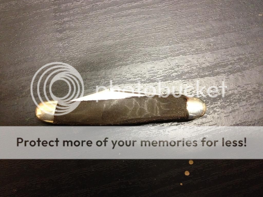

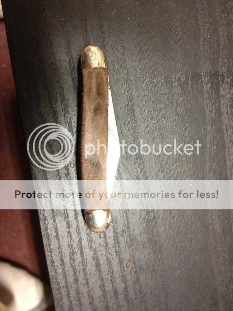

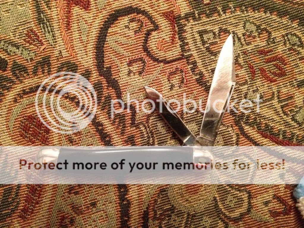

Well, I've started the project. Sorry, I couldn't help myself. I've got the leather glued and trimmed up. I put one coat of dye on but after sanding the leather, I'm going to redye it when I get home. I've got it sanded down fairly well. After the dye dries, I think I'm going with a superglue finish to harden the leather and make it more moisture resistant. And hopefully, I'll be able to sand it smooth and get a nice polish on it

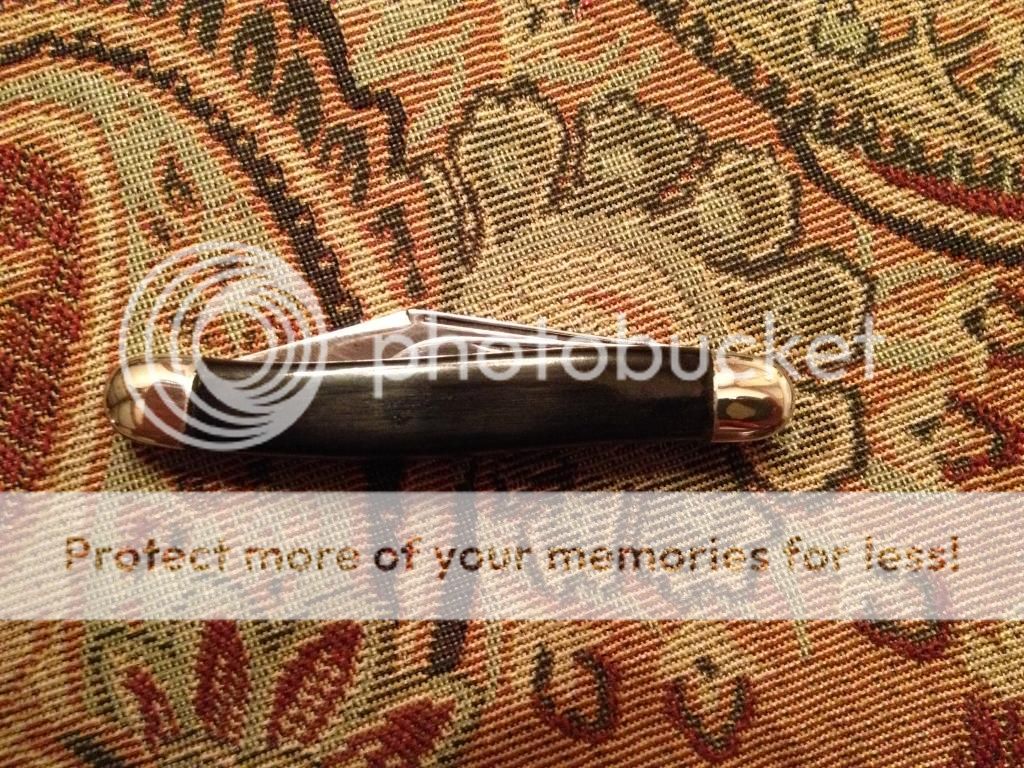

Here it is. I recited with superglue, wet sanded with 220, 600, and 1500 grit sand paper. Then the buffing wheel with green compound on tight stitch wheel then red rouge on soft wheel. Finished up with mothers mag polish. I'm pretty happy wih this little guy now.
