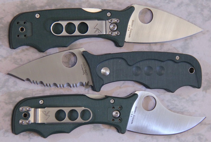

Well, the revival of this thread inspired me to finally get around to fixing my Lil Temp.
I missed out on this knife when it first came out, but I've always really liked the design, so a couple of years ago when offered one in trade, I jumped on it. The example I received didn't look like the blade had ever been used, but it had clearly been disassembled, and the lock up wasn't great. It had a bit of lateral blade play, and when I tightened the pivot screw to eliminate that, the compression lock wouldn't engage at all. Been meaning to fix it for ages, but seeing this thread finally jolted me into getting out the dremel and removing a bit of material until it locked up properly.
Here it is below with another Golden oldie - the original Paramilitary. I look forward to finally putting this to us, about 15 years or so after first noticing the design.

Yours may have the same pivot as mine. It has 16 flat edges on it for different fit each time. You know. An octagon x2 that Lock's into the liner. If yours had a D pivot that has no adjustment.
I marked mine with a marker before removing the pivot and cleaning it yesterday.
Any how , thanks for the post! Glad you pulled it out to make the adjustment .
