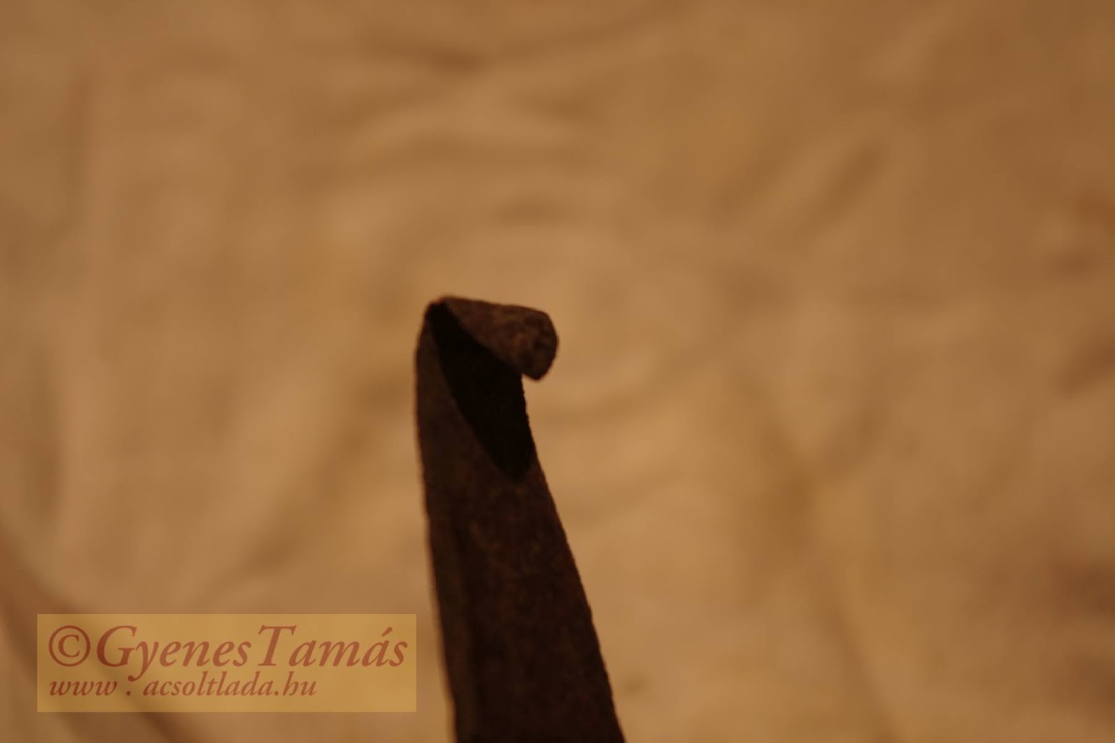

First time I have seen the tool used for putting the grooves in the boards:
http://acsoltlada.hu/index_en.html
Chests made from green riven Beech:
https://thrownandriven.com/2016/07/12/hungary-part-1/
I think its called a Twivel.
Bunch a old primitive Pete's hanging out around here that have sniffed to much saw dust...
The word you're looking for might be twybill or twibill. Also sometimes called a kruezaxt, though the kruezaxts I've seen pictures of were generally wider. I think Ernest Dubois could tell us more about them.
I'm not sure that twivel, or is it twivle, and twybil/twibil are synonymous. Possible the names refer to two separate things.
I'm pretty sure though there is widespread confusion on the matter in general - maybe I can add to it by drawing distinctions where drawing distinctions may just be misplaced.
This tool at hand - from the video - maybe it is a twivle but it's not a twybil though both began as carpenter's tools. Twybil gets mentioned by Ben Johnson like that in 1623 and no carpenter then is going to be caught making sheep hurdles. In this context - that the tool is from the carpenter - I draw parallels between twybil and kreuzaxt and they are true axes in the sense we understand. That is to say, a tool that gets swung and whose primary action is chopping.
This twivel is categorically different if that category is the action behind the use because it never gets swung, it gets pulled, just like the german name, Nut ziehen implies and also the similar Dutch name, ritsmes.This twivel is basically a carving tool, not necessarily limited to grooves but also wavy lines. A version of it was standard in timber frame assembly for marking components in order to get them back together in the right order.

So the twivel is a primarily pulled tool and the twibil is an impact mortising tool.
I wouldn't necessarily say that Sloan's drawing is inacurate. It may correctly depict a tool differing from Ernest's kruezaxt. Sloan depicts a tool used for shearing rather than chiseling. The angle of the point is not a chisel angle and would be more appropriate for a shearing cut.
It's likely that each tool in this family was made to order to fill a specific carpenter's desire.
With the twivel one end appears to be for scoring and the other for gouging. From the film and Sloan's drawing I can't be certain the gouging end is actually a gouge or a hook like a hook knife. How do you guys see it?
This is indeed the basic distinction. There are others.
I see it now that Slone says twivel for one and twybil for another. I think that's looking at it with a clear head.
Still we have the confusion coming out of England - surprise surprise - between the contemporary use of twybil and the historical. The contemporary idea, we can look it up on the computer, being a misappropriation popularized by Mike Abbot and his band of merry country craftsmen, (probably got started before them though), and which has taken root, thanks in no small part to that same internet's influence, so we have to accept it going forward to one degree or another, which is not to deny its origins, recorded from as far back as 1623, as the tool swung by the carpenter.

"He then sent me another more lengthy email a few days later, explaining about the tool and how it works etc. In Hungarian, it is called a hornyoló. It seems that the cathedral window artist even got the detail of the cutter on the tool right, as it is a ‘U’ shaped hook on the end of the tool. By holding this tool with both hands, one on the iron part, the other on the wooden handle, the artist pulls the tool through the wood, repeatedly removing strips as is done with a plane, until the desired depth is achieved. I assume that only skill and practice render straight and accurate rebates, as there is nothing, save the craftsman’s dexterity to guide it."
These are some of the things that struck me about the video. He cuts the groove (rebate, rabbet) totally free hand. And the way the shavings came off made me think it might be a hook knife.

The business ends of this tool are identical so when it gets flipped the cutting action is reversed to give the groove symmetry otherwise you'd have a rough go of it keeping the groove perpendicular with the plank's edge and having a chance at creating a flat surface once the planks were stacked. With this kind of chest construction everything has to work in your favor otherwise you'd end up with a pile of firewood after the chest started to dry.
