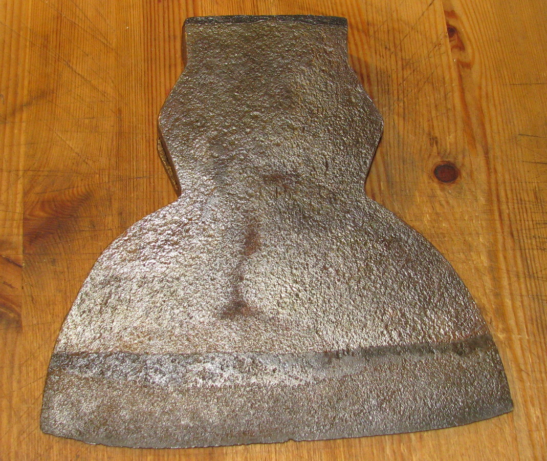

It's very clearly a wrought iron body. But look at how the bit and poll laminations also shows layering. I'm not certain what process created this look in the carbon steel poll.
Huhh?It would be interesting to know whether there were many precedents to such varying the depth of the blade....
And yet it is a common solution.You're claiming that making 2 forge welds will be easier then simply drawing out the existing steel. It's ludicrous!

This shows your inexperience with blacksmithing. You're claiming that making 2 forge welds will be easier then simply drawing out the existing steel. It's ludicrous!
And there are/were many means by which a smith of old could determine how much and what type of steel was remaining. You're placing your own lack of knowledge of steel and smithing onto blacksmiths who had a lifetime of experience dealing with the metals of their age. You really think those guys couldn't read a spark test? A file test? You think vinegar didn't exist?

Or a depth guide? I don't know. I can't wait to get my grubby hands on it in July.Sorry for my barbarous English...Just meant the depth of Terrain,how in that regional style they were not shy at all about the thickness of that raised area on the blade...(made me wonder why...as a chip-breaker?).
