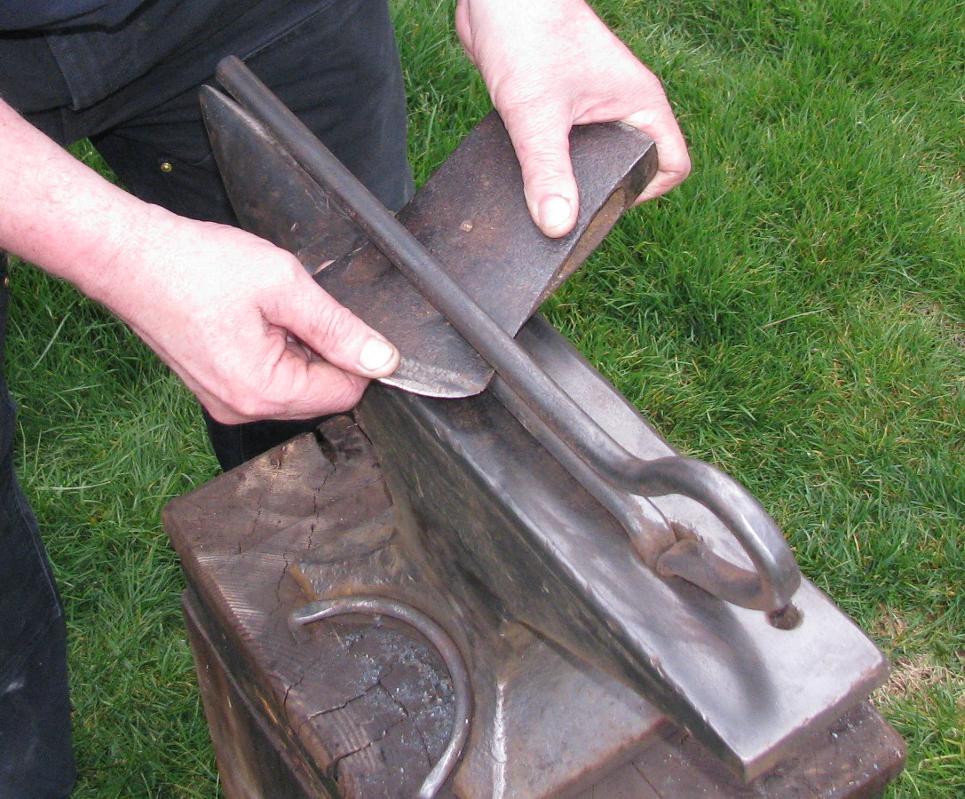

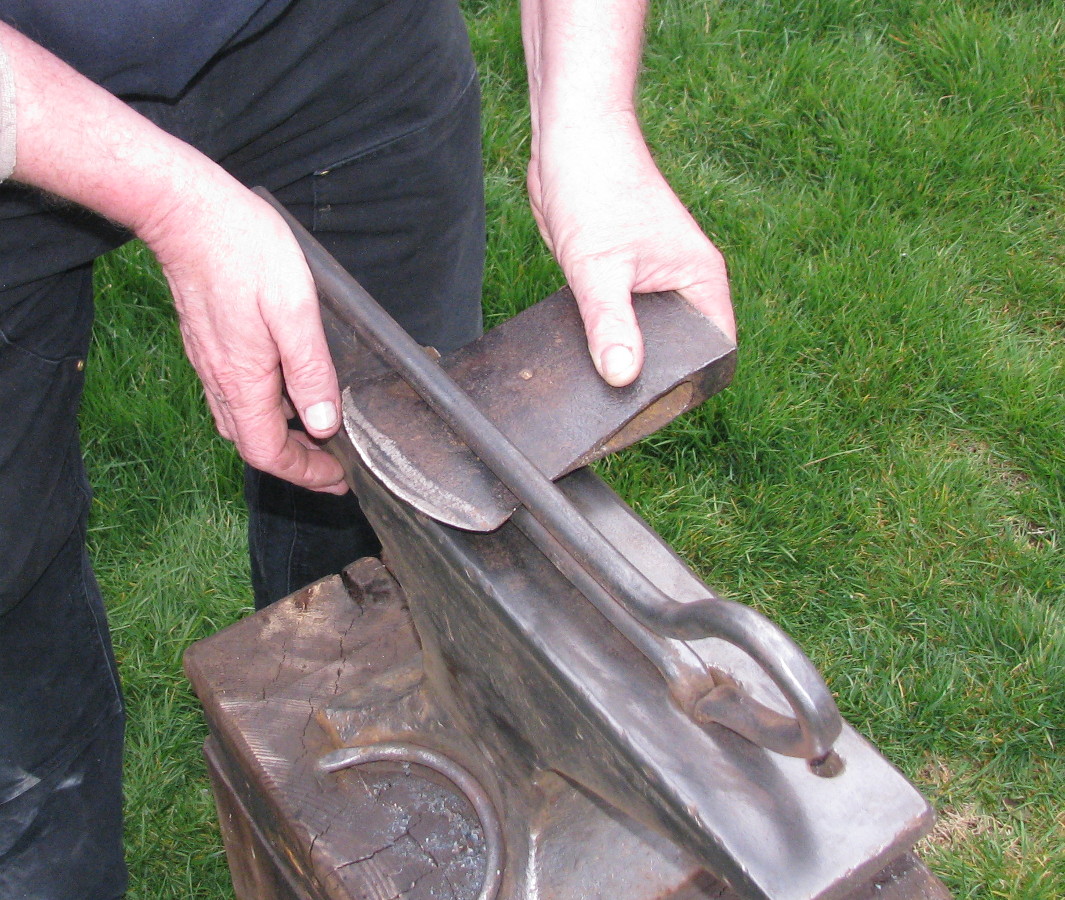

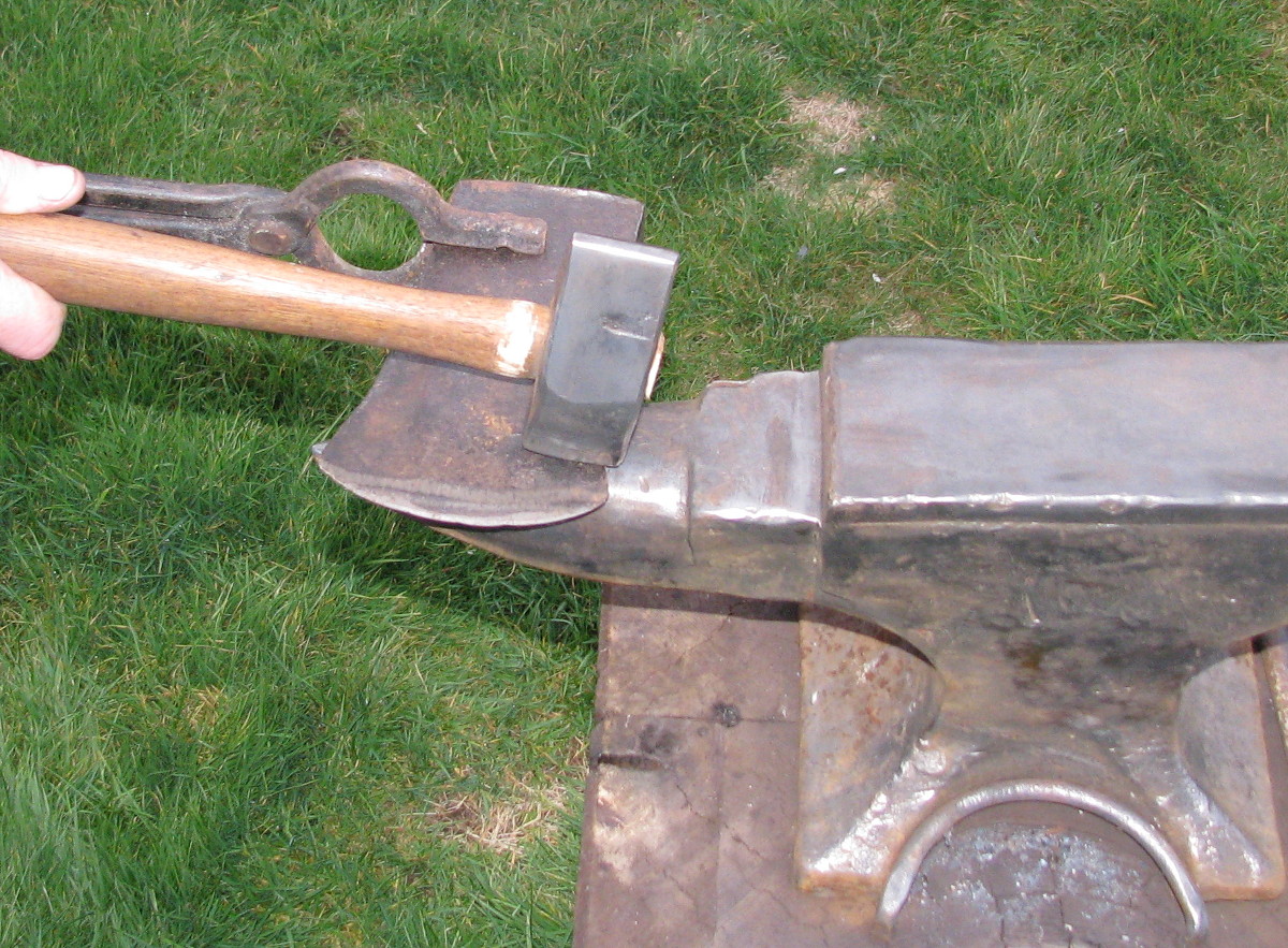

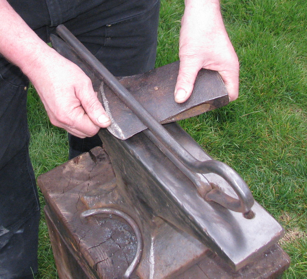

There's one misconception lingering in this thread that needs some light shed on it. I think there are some here who feel that repairing an axe in this manner would have been a shoddy or hap-hazard way of making a repair. This is completely wrong thinking. Old tools were routinely repaired this way and some still are. Makers planned for this in the design of their tools. The drawing out and re-pointing of striking tools was and is standard operating procedure.
Read this from Hubbard, a renowned maker of railroad tools including track chisels. Begin below the images of the Hubbard Chisels at "All Hubbard Chisels..." The maker is explicitly acknowledging that their tools are going to be redressed by local and company blacksmiths to extend their working life.
To this day jack hammer points are redressed in this manner. My friend and fellow blacksmith Larry Langdon had a business doing this for some time (which he has since ceased - paid the bills but boring). He heats the bit in an induction forge, nips a bit off the tip (fatigued metal) and then re-points them at the hammer. He did 1000's of points this way.

Another necessary tool for this would be a Bolster block of N-th convexity,to forge the axe on edge.All i have for that is the base of the horn,and it's of course bad and wrong,horn being a dead-blow entity to begin with,And a degree of taper corkscrewing things on ya...
So,in an ideal world,had you some time at Larry's :),you could even make a combination tool-half bolster for edge/half mushroom for the indenting(to match some old 3-4 lbs sledge)...

That last photo is pretty much exactly how i did everything today.And it was rough going...Horn has no rebound(not supposed to),and of course corresponded poorly to the size/shape/radius of a 3-lbs sledge that i was using.
