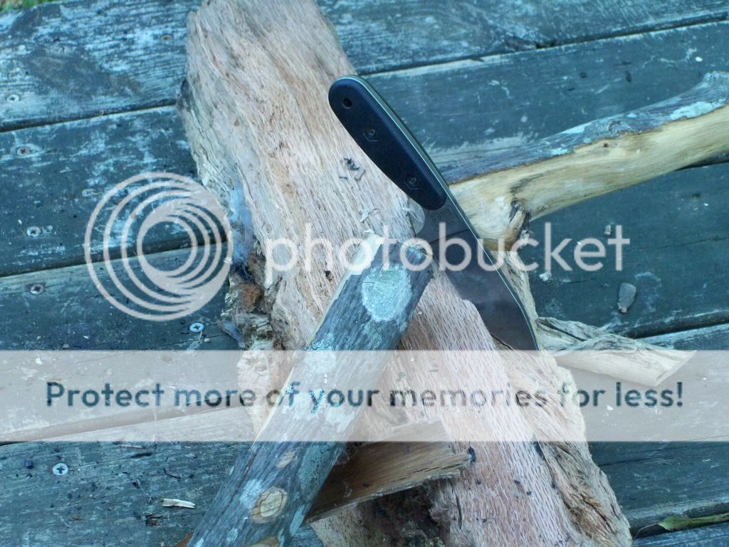

So for X-Mas I got an Ontario BlackBird. I got this knife because the maker claimed you could baton with it. Some state that you shouldn't baton, but as a knife maker, when you make a claim, expect that claim to be tested.
What I did:
First I baton a few small pieces of wood. Then I chopped for a few minutes. And finally I decided to baton on top of it to see if it could take the hits. I can't stress this next part enough, I put about 1/5 of my normal power into these swings. My normal hits on my CS LeatherNeck have never caused me issue, and with all my might I could not break my CS LeatherNeck. I'm gonna say it again in a different way..........The wood my BlackBird broke on was soft, straight, no knots, hit with very little power and it broke by the third hit.
Here is where it broke.
I'm gonna see if the manufacturer will send me my money back.

I'm sure that "battoning" means different things to different people. Perhaps when the maker said that the knife was suitable for battoning he meant splitting small pieces of wood, not using the knife as a wedge to split tree-trunk size logs with.
Imho, all relevant discussion in this specific case ended right there on the front page. Looks like the OP was attempting to cut a large diameter log with a 5" bladed knife... uummm, what did you think was going to happen? That log required a machete, hatchet, or axe; or at the very least a substantial 7"-9" knife with a much thicker blade... RD9 or BK9?

The Blackbird should take a good beating, with little to no damage. But you ain't gonna use it as a froe or single bit and split a log that large. It would be better to nip off the outside, because, if you are needing to split wood that large up for kindling, its gotta be small any how.

No way that knife was gonna come out on top . As stated above you should have chipped the edges off along the grain , say from the bottom point of the log in the pic.

I think this is a case of using a good knife for the wrong job.
5160 and 1095 steel would be a better choice of steel for this type of camp chore. The SK5 is a superior wilderness knife however batoning 154cm steel is a bad idea no mater who the manufacture is. Take into account the blade thickness is 1/8" thick. and 154cm is better known for its edge retention not its toughness. Also the cold weather didn't help.
