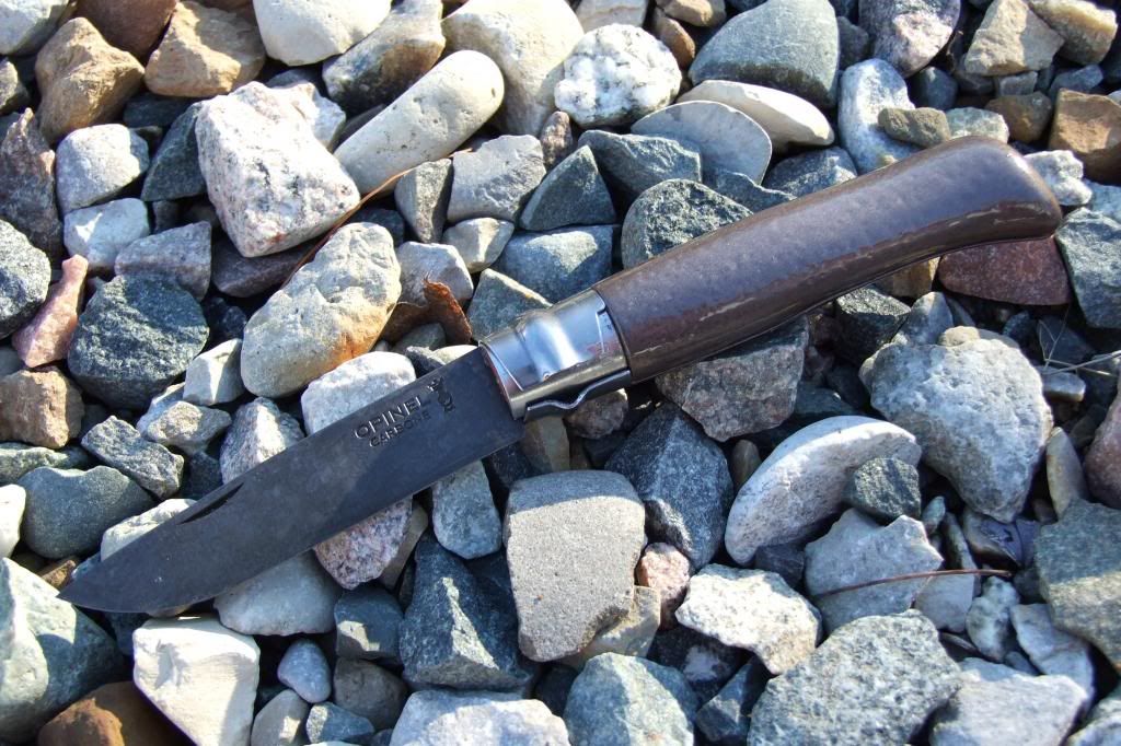

I did not sand a relief for easier opening. Yes I know, it's pretty basic stuff, but it was my first try at modifying an Opinel. So I kept it basic, the forced patina was fun to do. Overall, I'm pleased with the result and I now have a unique Opinel in my collection. Will not be my last ;-)
That was not meant to be a slur in any way. Those are the best and most logical mods. I used to mod Opinels a fair bit and I've done some pretty funky things which didn't work out.
I used colored woodwax on the handle and patinated the blade with mustard. I am not entirely happy with the patina, but I buffed it with steel wool and oil. Maybe better next time.

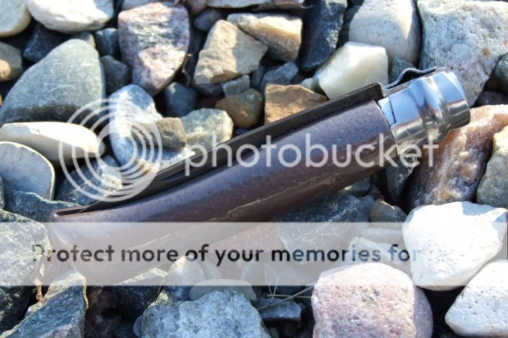

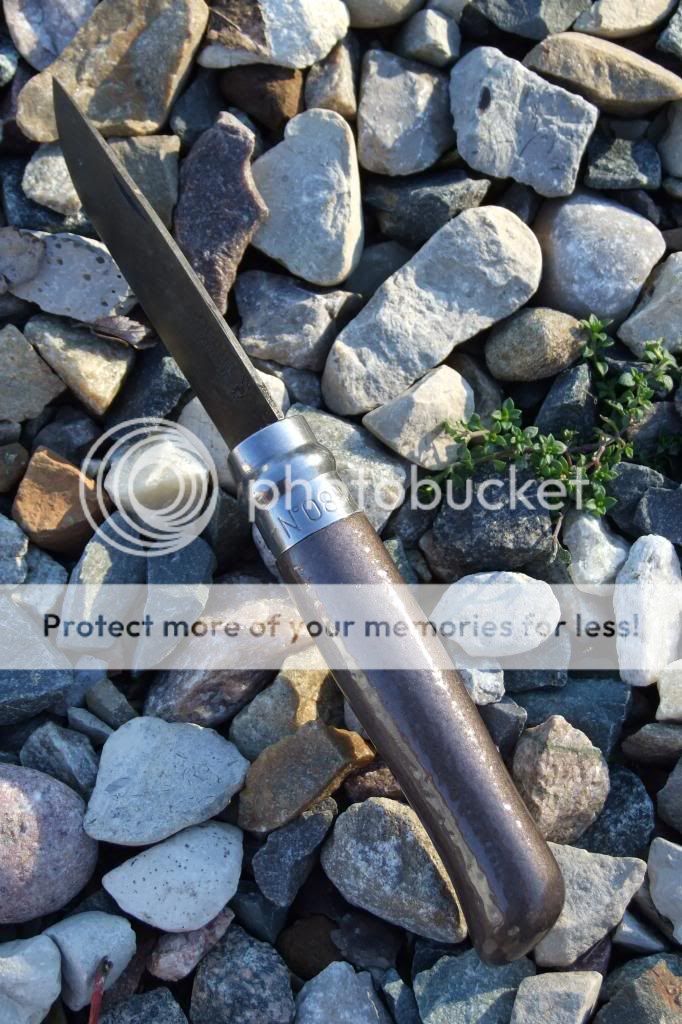

This thread inspired me to mod my #8 carbon which I just got last week.
I sprayed the handle with a hammered brown paint, but it had a slightly sticky feel (like it wasn't/wouldn't dry). So, I put a few coats of lacquer on as a top coat and it feels good to the touch now, but it lost much of the hammered texture.
I used apple cider vinegar to force the patina on the blade.
I just ordered 9 more last night. :)
Thanks for looking.

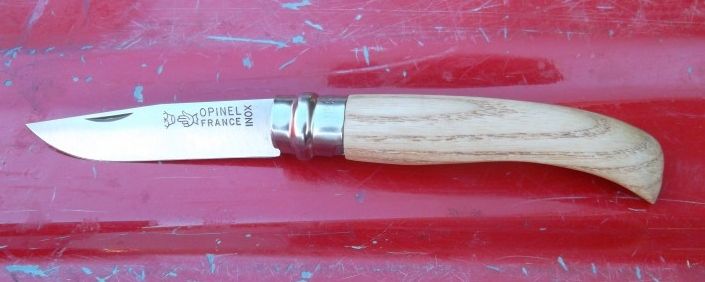

I got this No.8 several years ago when House of Blades still had their store in the Fort Worth Stockyards. Didn't know anything about Opinels, just thought the twist lock was unique. Kept it in stock form with laser-etched deer until this year. Used minwax golden pecan stain, but what really made the grain pop was re-using sandpaper from sanding down a piece of cocobolo on the lathe. The slimmer shape fits alot better in the pocket, and the unique look gets attention. Wood is ash.

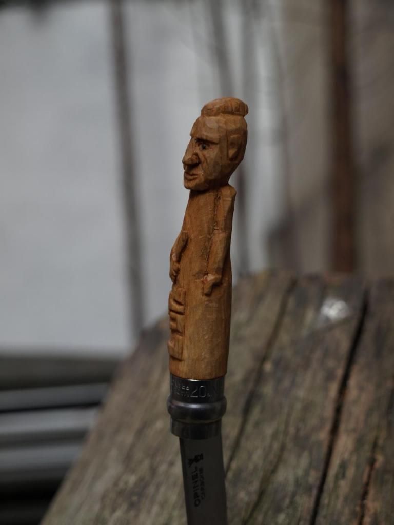

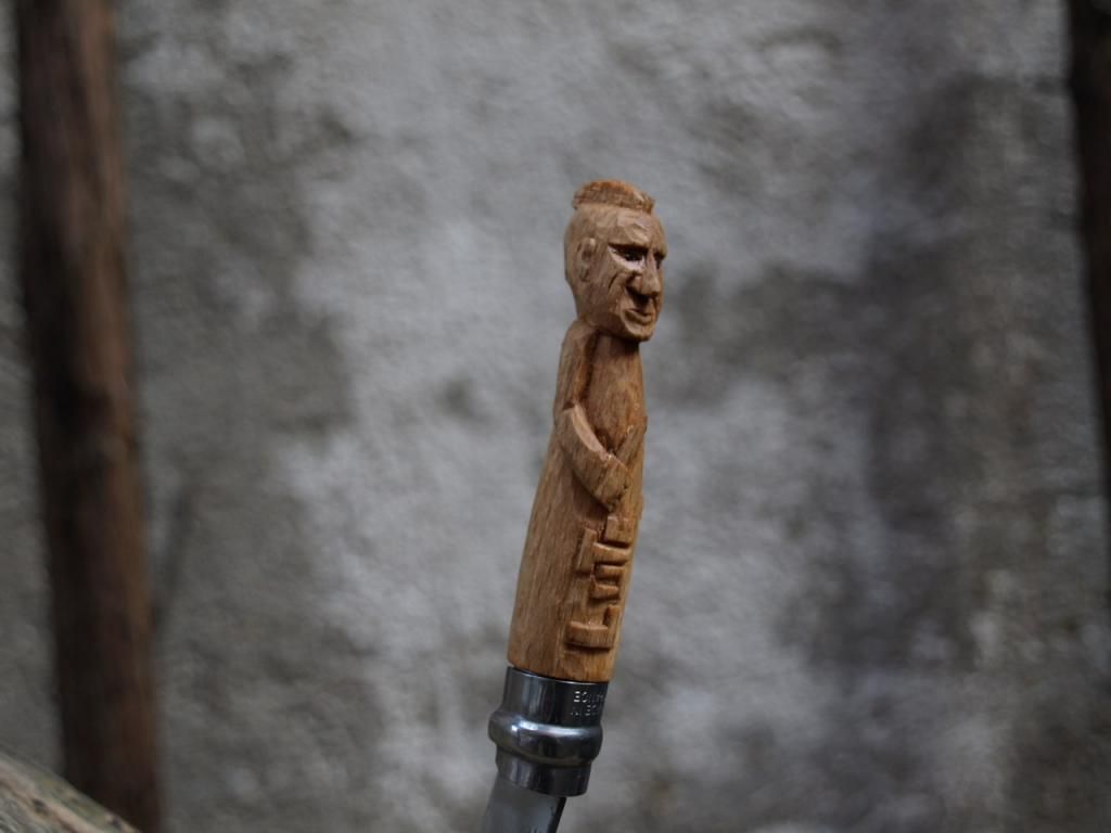

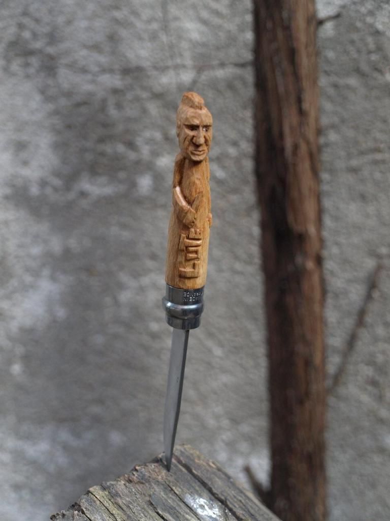

Hey guys,
Here is an opi number 7 in which I whittled a little Indian on the original beech wood handle.
I'm thinking about shaping the blade to a drop point but I'm still considering it.
Hope you like it.
