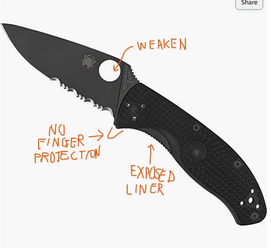

To me, another STUPID design is this Spyderco
Look at this.
1) Big hole close to the pivot of the blade. For plying, of cause the tip will break first, but you still have a useful knife even if 1/2" of the tip broke off. But then the next weak point will be right there. The big hole weaken that part just like the super thin part around the pivot hole that weaken the base of the blade. If the blade breaks here, you have no knife left to use.
2) There is no finger protection. If you use in self defense and thrust. You really risk shoving the blade back and cut your finger seriously.
3) The liner lock is exposed, you can easily move it when you grab the handle for using as tool or in defense situation and unlock the blade.
How is this a good design that worth a lot of money? You want me to learn from a famous designer? You can't go by the price and name. I won't carry this one even if I get PAID to carry.

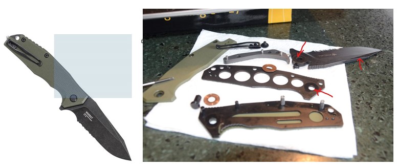

COMPARE TO THIS MODEST PRICE($68) Steel Will Warbot
None of the problem described above. Look at how robust of the blade around the pivot point area both on blade and liner. Liner is 0.06" thick, blade is 0.14" at the base. It dosen't use ball bearings, no thinning in the pivot hole. Still smooth and easy to deploy.
Both knives are more utility with teeth on the blade for cutting seat belt. Look at the difference on the design. You don't need to be a knife designer to understand all these. This is COMMON SENSE. I hate to sound offensive and ungrateful, but just use common sense. THIS IS NOT FASHION, THESE ARE TOOLS AND FOR LIFE AND DEATH.

There are a few Spyderco more expensive ones looking like that. I have $20 ones better than that. This is one example, I've seen enough expensive ones.
