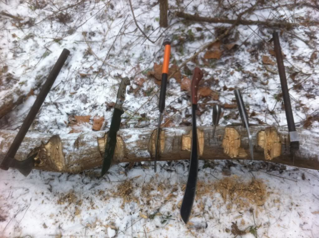

so me, dtrap, and mad dog (my 5 y/o girl) were about and about building shelters, fires, and just plain chopping today. it was going great. we had some busses, blind horse knives, 2 hawks warbeast, JK belt hawk, condor parang and a fiskars bill hook.
we threw up a quick tarp shelter, found some kindling and dry wood (very hard task). do some prep work. I pull out the esee fire starter and get a flame going (after about 30 tries lol) we found a old metal barrel someone was shooting and used it as the fire pit, also found some weird plastic things we let my daughter use as seats and a sled lol. after she was all hooked up and warm under the tarp, dtrap and me started really playing around. we found a lot of dead hardwood and proceed to test the chopping ability of the blades. the wood was a hard oak or something similar. the hawks are crazy good choppers. they all were really doing very well but the blades required more work. we stoked the fire continually and it used a lot of wood. under the tarp it was actually very warm, probably around 55 or so, while in the elements it was 21.

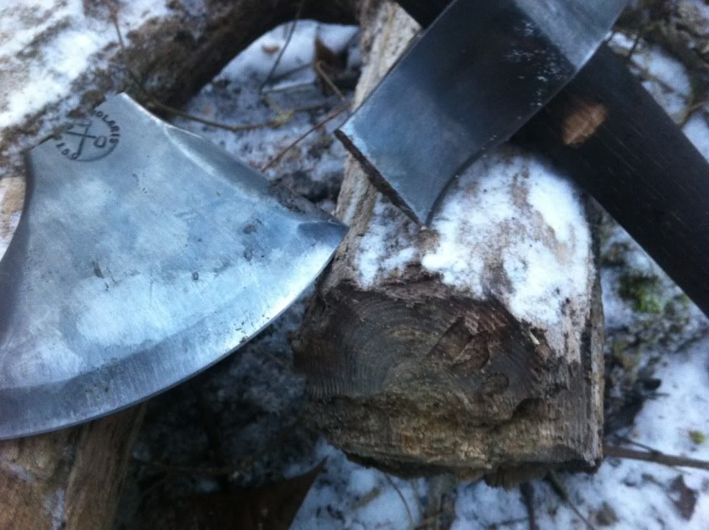

now on to the wtf part. so I am using my 2 hawks war beast to chop some very seasoned hard wood. the final hit and the wood breaks off and I hear this strange sound. I look down and this is what I see
to say I was salty is a freaking understatement. wtf!!!!! but I guess at least it wasn't a real survival situation and I guess we will see how his warranty it. this hawk I got at the 1500 and has very minimal use.

Dang, I haven't ever seen a hawk do that before, I've heard that steel has a point where it can get fragile, just never experienced it myself. Good luck with the warranty!
yeah it's only a week old and the website says hawk blades are warranted for 25 years so. it was still a blast hanging out with the family and beating on some blades, honing skills and watching the little one chop
Looks like a bad heat-treat. Great that you got the tyke out there and enjoyed some quality time together!

Never saw a break like that before
Crazy!!!!!! Must have been a flaw in the steel.

That really sucks. But, that is not the first picture I have seen of that happening. My friend had the same break occur in the same spot with the same hawk.
Let it be known that all of 2 Hawks are CAST heads not forged like the regular custom or even Cold Steel heads are. Stuff like this while rare can happen easier being cast imo.
I was going to order one of those 2hawks axes until I did a bit of research and found out they are all cast. Way too expensive for a cast head IMHO. Chris
really? this makes me nervous lol. I'm hoping he gets back to me today but who knows. and I knew it was cast heads but I didn't think that would cause a problem like this.
