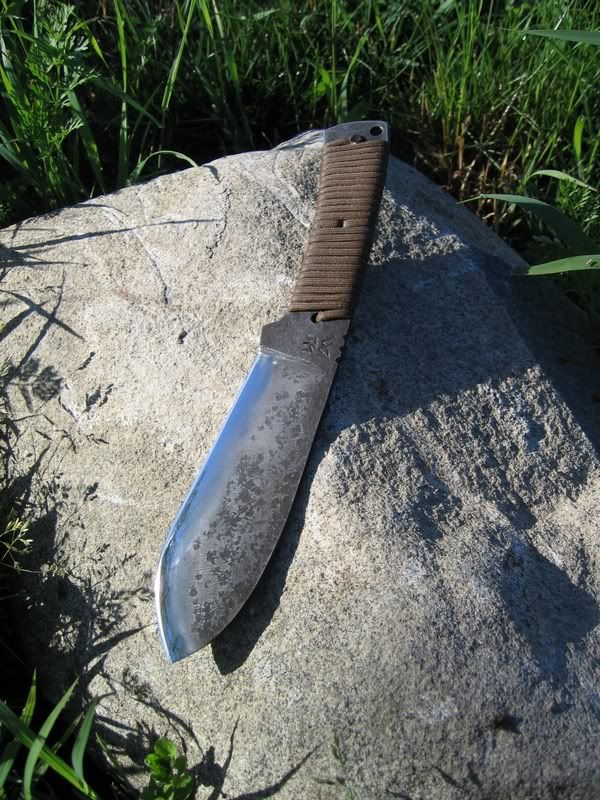

Gratuitous pic..... the "Bushpig".... approx 5/32 at thickest...

Dannyboy- I love that slightly convex clip! I'd do a bit different on the handle if I warn't doing a period piece. Do you have more history on that style? I'm looking at my longknife design and trying to get some more historical oomph behind it. All I really know is it's a lightened long leuku that works.
Koyote, That particular knife is an exact copy of one found in a museum in Indiana of an old English butcher. Though the knife has an 8" blade, 5" walnut handle, it is so light and well-balanced that I have no difficulty using it as a paring knife. Peeling potatoes, so forth, is a breeze. Needless to say, the blade does not have a grind - true to the originals (no power equipment was used in its making), but was filed to finish after the forging process. The blade has a convexed profile to it...which is typical for the flat filed finish.
