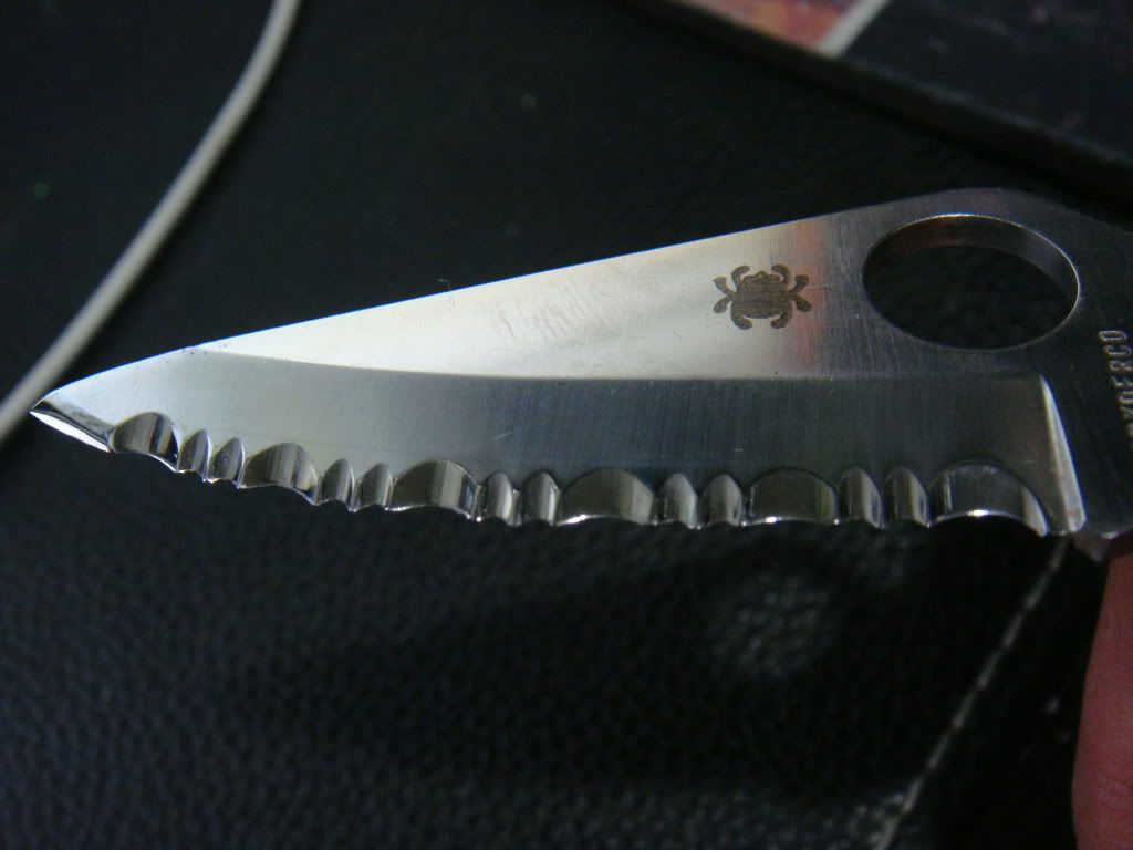

Here is a serrated blade that Richard sharpened for me. I wish I would have had a before picture, this blade wouldn't cut anything but now it will cut anything you throw at it. Cuts with ease! He sharpened this blade with a slotted wheel ONLY!!
Thanx Rich ;-)
I was going to actually remove the serrations because they were so bad but he brought it back to life. So Ill get some more use from this blade now.
its easy to resharpen a serrated blade just using the slotted wheel if the serrations are not in bad shape without the need to grind on the backside of the blade.
a few spots might not be quite as pointy and i could have recut them but there was no need.
that camera takes good pictures. it looks like some skin or something on the one tooth in the bottom picture :D

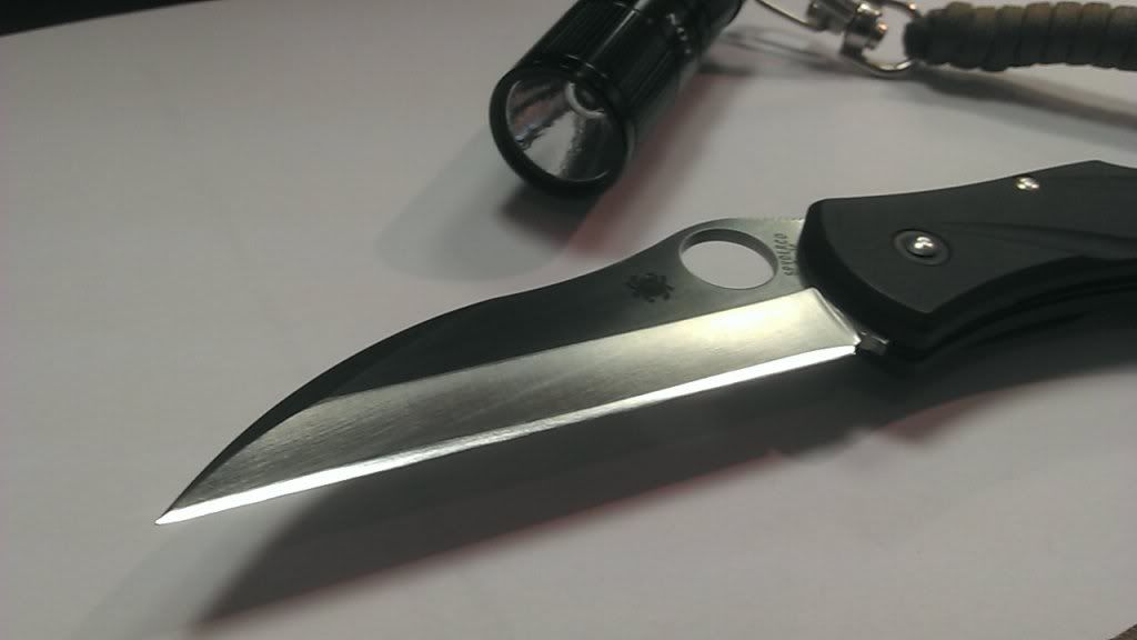

Convexed zdp endura polished on the slotted wheel:

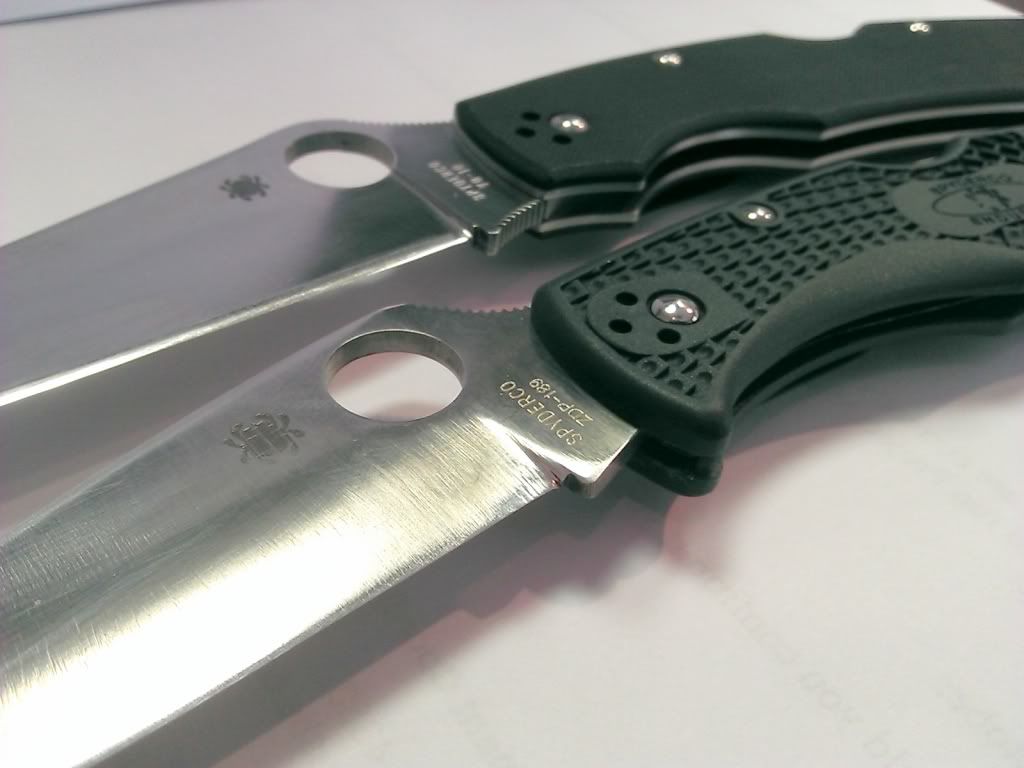

Full serrated endura, just a quick swipe on the flat blackside of the serrations keeps her cutting nicely (the cento 4 gets paper wheel spa treatment as well!):
Spydie Bill Moran FB, crazy sharp as it's been thinned and convexed then polished on the slotted wheel:
on the endura, when you say "a quick swipe on the flat blackside" you do mean with the slotted wheel and not the grit wheel correct.

Yes sir, I don't want to ruin the stock edge geometry of the serrations by grinding them down on the grit wheel, I only tune them up with the slotted wheel and it seems to work well so far... :thumbup:
