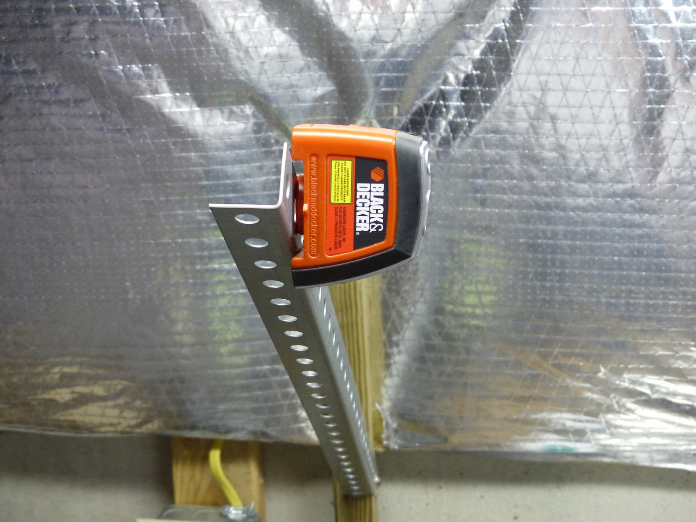

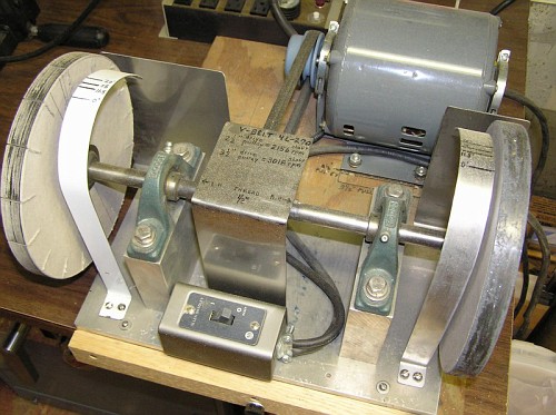

This is a set-up for the paper wheels I made 4-5 years ago. Put the proper size pulleys on to get the speed you want. I also made a platen a year ago for this that was adjustable up and down and in and out. Did not find this comfortable for my use and removed it. I now have a laser that is adjustable for different angles. It is set above and between both wheels. It is very easy to place the beam on the right position on both wheels, at the same time, to get the angle I desire.
I saw that some were marking angles on the wheels, and grinder sides to get the right angles.
I just wanted to see if some sort of guide to keep both sides the same, would help me just starting out.

Lil' John, I marked my wheels like shown, and then drew a line with a sharpie across the body of the motor for the angle I use the most for a guide line. Works great for me. I can mentally adjust from there for other angles.

I marked the angles on the wheels when I first got the paper wheels. Those marks were transferred to the metal pieces on the side of each wheel. This was my first guide to placing the knife on the right spot on the wheel. I have since progressed to the Laser and until I find something better this is what I like best. If I used it more often I am sure that no markings would be required for me. The more you use it the easier it becomes. Good luck.

Ok rpttrsn you have me hooked now...what kind of lazer are you using, like a contractor's lazer level, or a pointer type?
(Got any pics, and brand names/models etc?)
I am just now getting around the parts, ....looking for pillow blocks, mandrel arbors etc....now I am trying to figure out how to rig up this lazer angle.

I went to my work area and took the shots for you. The laser is by Black and Decker. Lowes or Home Depot have them. Hope it helps.
Ron
YOU DA' MAN!
That set up looks foolproof!
(I've got another toy to buy now.)
