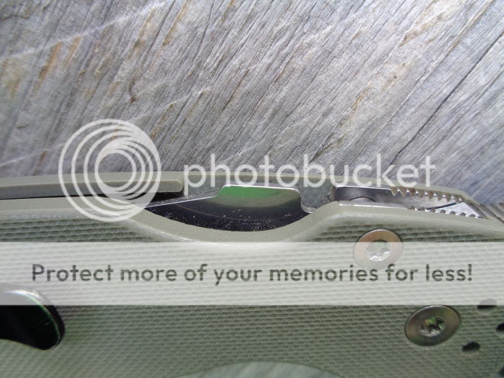

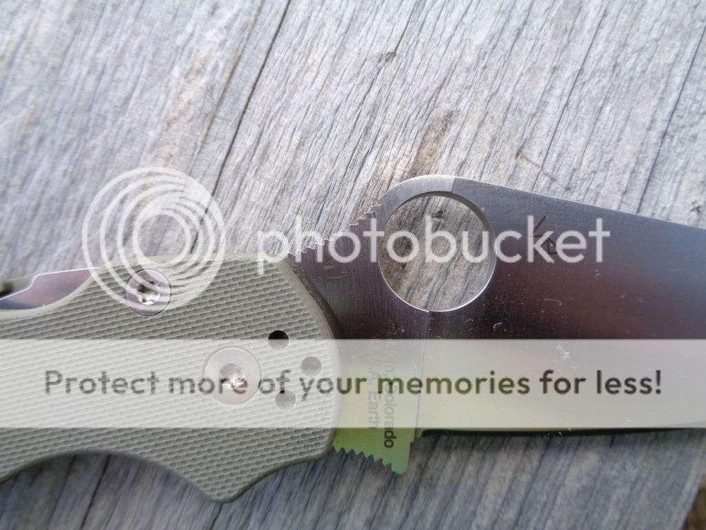

It's fake. The box is fake. The white line should not be visible under the gold spyder. Blade markings are all wrong too.

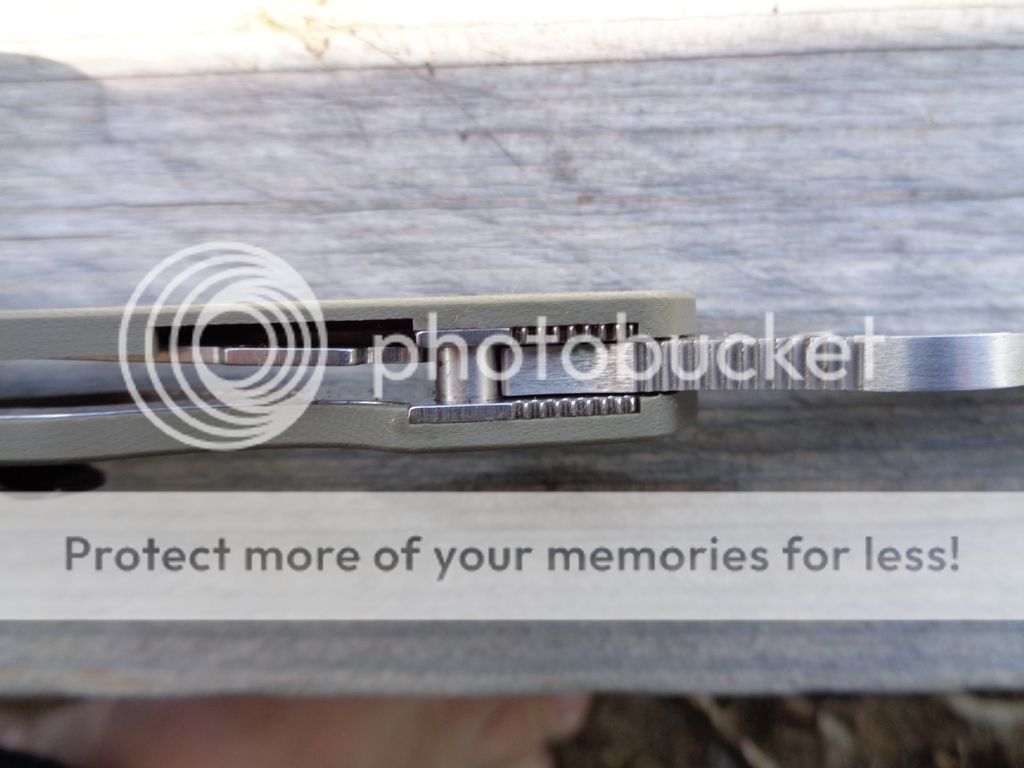

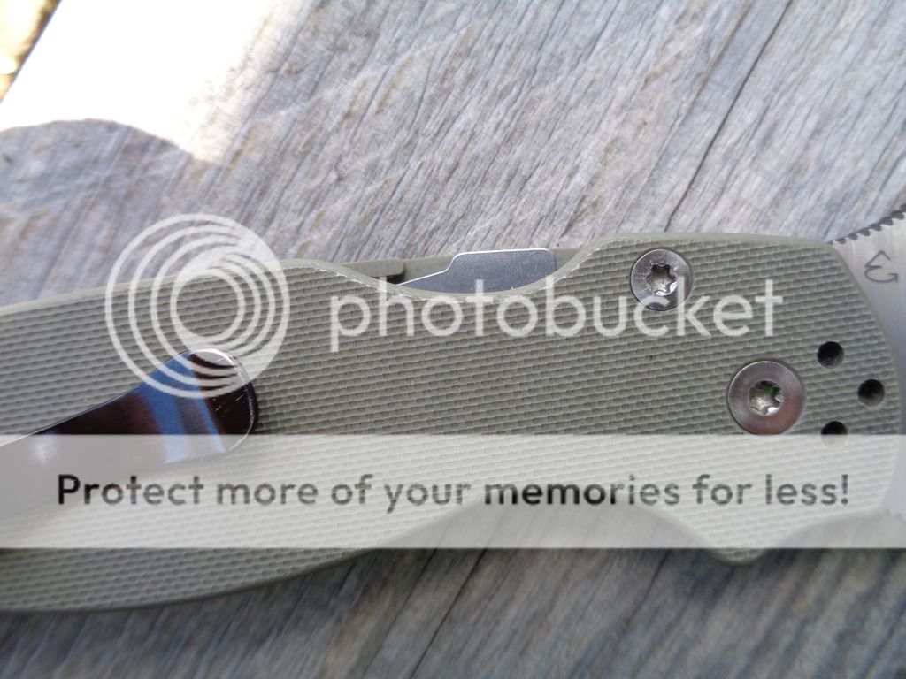

Better pics of the thumb ramp jimping, lock area and close ups of the G10 would help us see if it's a fake or not, though some fakes are getting to be to damn good and hard to spot, at least to my amateur eye.
Here's a few pics for you to compare. Note the backwards angle of the thumb ramp jimping.

The problem with mailing it to spyderco is if it is fake (looks like it to me) you will not get it back. They may compensate you in some way but do not count on it.
Pictures like the ones above would help a lot! In one photo of yours (the OP) the jimping looks little angled, but the others it doesn't. Take your photos straight on.
Sorry, bit slow to post. Nah, the jimping just doesn't look right to me. And that edge is shite.
Sorry friend, I don't think it's a real Spyderco.
