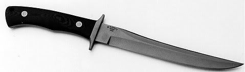

This is a Pic a Tyledyne Vasco Wear Knife I made for a soldier heading to theater. The rockwell hardness is extreemly high.
Here is a scan of the same Knife. The Soldier. (Now a very well known collector of Loveless, Moran, and Lovett Knives.) Carried this knife into Combat. Where his life could very well have depended on it. He and I designed this knife, as he was three time all U.S. Army Marshal Artist Edged Weapons Champion. He knows what a Fighting Knife need to be. S
She is light and extremely strong!
He just sent the Knife in simply because I had no patter for it. It was made in quite a rush as he had to ship out is just a few days.
This Knife has now been in his hands for over 18 years. It has never been refinished. It has never had to be resharpened. And Yes. It is well Used. Judge for your self. Just how this knife has held up. Do you have a knife that could match it's record? If there is a steel that can be hand forged that can match it's performance, I nor any one else has found it.
