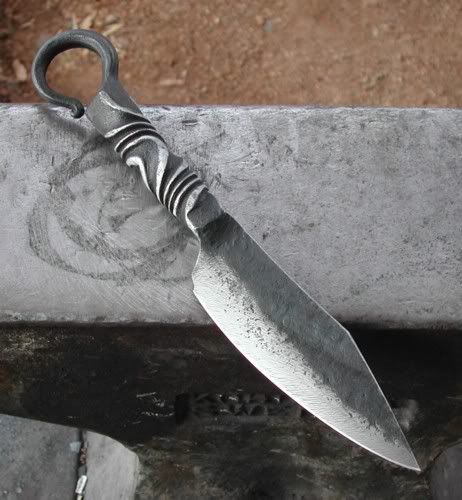

This has nothing to do with general performance, but as far as forging vs. stock reduction, which is faster or more efficient goes,... I'd like to reiterate the point I was trying to make about,... It depends on the form and desired character of the knife.
I doubt any stock reduction maker could duplicate this knife nearly as fast as I could forge it or capture the character of it,... and I'm sure there are others that they could do much faster with a totally different character.
