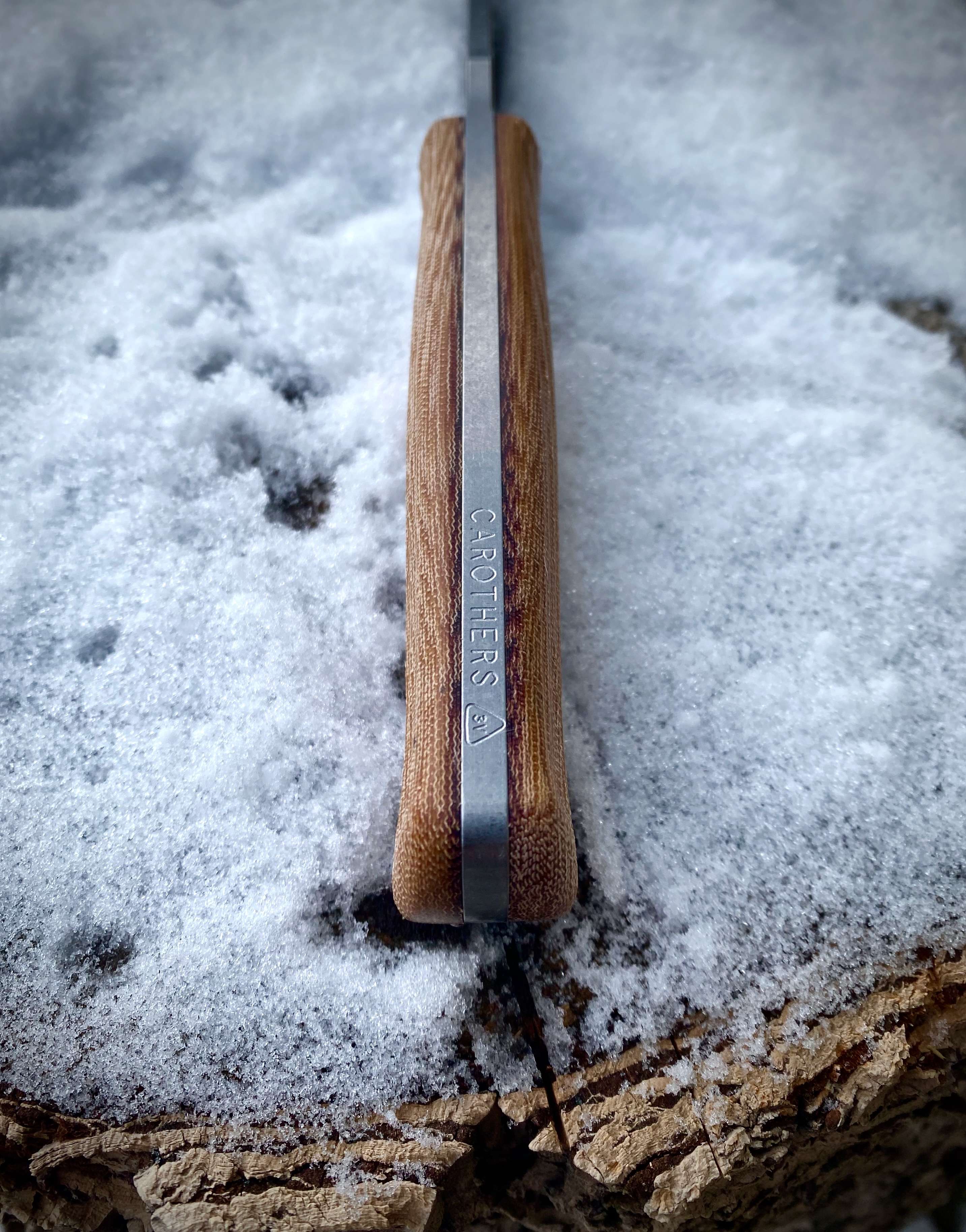

Since I posted bad news in the UF thread I owe some better news. Here is my EDC in the middle that I have used to clean a good number of animals and then the EDCs I got for my kids to use when they get a little bit older. Since I’m not giving them my knife I wanted them to have a piece of the knife that cleaned each of their first deer. Since they are opposite eye dominant it made it super easy to give them a scale from mine inline with their dominant eye and I now also have a piece of their knives with me.
Not knife related but they also both used the same rifle I did when harvesting their first deer and I was fortunate enough to be sitting with them as they did it.
