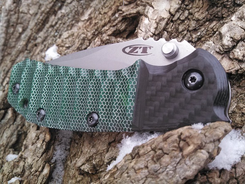

Here is my customized Eraser with carbon fiber handles, silver twill bolsters, carbon fiber back-spacer, along with acid stonewashed clip, blade, and liners.
Display side:
[/URL][/IMG]
Pocket Clip:
[/URL][/IMG]
Opened:
[/URL][/IMG]
Opened 2:
[/URL][/IMG]
Carbon Fiber Back-spacer:
[/URL][/IMG]
Lock-up:
[/URL][/IMG]
Acid Stonewashed Blade:
[/URL][/IMG]
Close-up of Silver Twill Bolsters:
[/URL][/IMG]
Close-up of Carbon Fiber:
[/URL][/IMG]

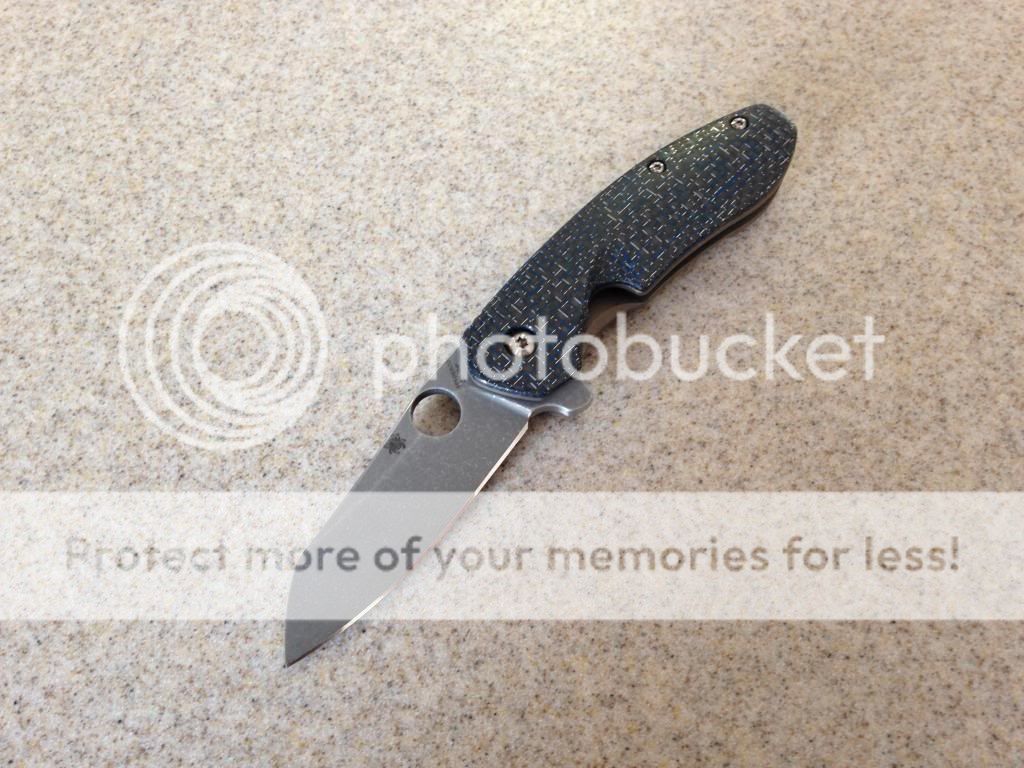

Chad Nichols stainless damascus reblade by Matt Cook. Handles are from a BM45.
