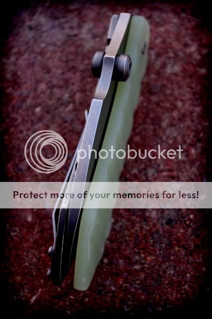

Well after admiring all of the great mods done in this thread I decided to give it a go myself. Here is the result. Turned out to be more time consuming and difficult than I had expected. Sure have a better appreciation for some of the work you all do.

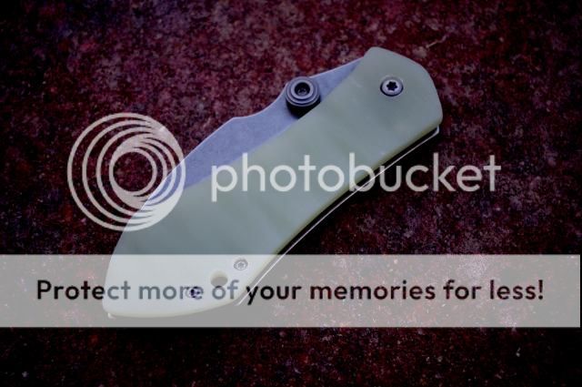

Acid-Etching Blades via the Professor Method (No Tumbling Involved):
Please note, I do this in stages, over three to four days usually to allow ample drying times. Results are a combination of bead-blasted-like and satin finishes.
1. Purchase PCB Etchant Solution at Radio Shack (about $13.00)
2. Pour solution into either a plastic or glass container, enough that the entire disassembled-from-chassis blade can be submerged
3. Degrease the loose blade twice or even three times using rubbing alcohol and a lint-free cloth, allowing ample dry time
4. Paint the surface areas of the blade with red fingernail polish (to be highly visible) that you DO NOT want affected by the solution (I paint the edge and any parts of the tang that contact the chassis internals – lockfaces, pivot hole, etc.)
5. Allow polish to dry, paint areas again, allow to dry again (I allow drying overnight)
6. Make an “S” hook with a large paper clip, hook through pivot hole, completely submerge into solution, hooking the free end on the side of your plastic or glass container for ease of removing the blade
7. Leave submerged for EXACTLY 45 minutes
8. Remove and submerge blade immediately and fully into a container of water to neutralize the remaining acid
9. Scrub blade under running water with dishsoap and toothbrush to remove remnants of solution – rinse clean
10. Use non-acetone fingernail polish remover with paper towels to removed painted-on polish, exposing un-etched areas
11. Use 600+ grit wet/dry sandpaper wrapped around a popsicle stick under running water (controls dust) to expose grind lines, blade holes, or any edges that you want to give the blade contrast from the polished edge/surfaces and etched surfaces
12. Etchant solution can be stored in container and re-used several times (I’ve used the same solution up to 6 times) and/or disposed of safely per the instructions on the bottle
13. Have a gin and tonic or cocktail of choice while re-assembling your knife and enjoy it for the unique beauty it now is:

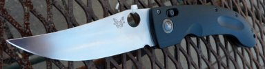

I just used professor's method to do my GB (my D2 556 is in the bath now). Fwiw I used 100% acetone to remove the polish afterwards and it didn't effect the patina at all. I did end up putting it back in for another 20 minutes after the initial 45 but other than those two minor tweaks I used his process exactly as posted.
Here's my D2 556, it took a total of 90 minutes (in 1/2 hour segments rinsed inbetween).
