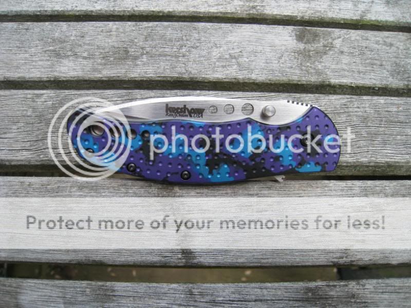

Experiment with gloves...
I think I did better job straitening Tyrade then ZT302...
Thanks, Vassili.
I must say you have a lot of courage to sharpen and change the shape of those expensive knives!
Well, now that you bring it up...

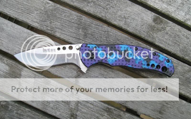

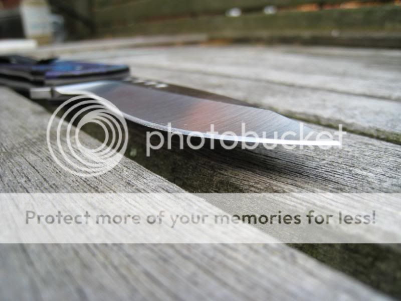

This is my first attempt at combining the edge bevel with the primary grind, otherwise known as a "zero edge". Unfortunately CPM S60V is the wrong steel type for that kind of edge (too soft, it would bend instead of cut).
With a ten degree per side micro bevel the knife works wonderfully, and the opening slot I made out of the decorative holes works pretty well too.
I didn't realise that S60V was 'soft' - does that mean it's edge retention isn't as good as S30V or even 440C?
I made a zero edge with my survival knife, I found that it became a little too vunerable to bending (the edge).
Is there anyway you can get the black coating on again?
First off, I'm learning that almost any steel type currently available isn't hard enough to sharpen at those angles, ZDP-189 is still too flexible when it's that thin.
As for the black coating, it's gone, and I'm fine with that.
I gave it an ok mirror polish, at least it's shiny.
