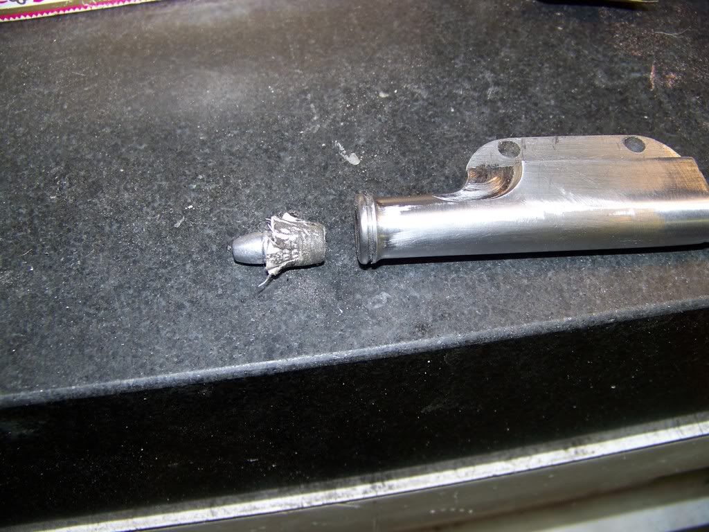

It is possible it will blow up when I proof it and will need to be replaced. The wall thickness is about .125" in the thinnest place. Hey its this kind of thing that makes it exciting!:eek: To proof the barrel I will overload it by at least 25%. Black powder is tame until it gets a heavy bullet or an extra thick patch and the bullet it forced extraordinarily hard down the bore so proofing is needed for saftey. Pyrodex is the new black powder and works good with less corrosiveness.

Though I really doubt you'll have any problems with your piece, I'd seriously encourage you to do some further research on proofing black powder guns. I'm not sure I'd be comfortable with a 25% margin of safety. Proofing standards varied by country, but in short they were much heavier. As in, around a triple charge of powder. Conversely, I've seen some proof loads (can't find the reference now) where it was a double charge of powder and a double amount of lead/shot, or something like that. Even a slight bulge in the barrel from these loads, and it would not pass.

I havent proofed this barrel yet but in the past I have doubled the charge with no problem whatsoever. I have filled the entire barrel and jammed a bullet in with no problems on a short barrel. It spewed out unburnt powder because the bullet wasnt in the barrel long enough to burn and build dangerous pressure. I wouldnt try doubling or tripling on a long barrel. I will be surprised if it bulges but if it does I will make a thicker wall one. A heavy bullet will build more pressure. I havent weighed my bullet yet but its about 3 times heavier than a round ball.
Here is the bullet with the patch. Its heavy and will be a good test for the proofing. I'll let ya know what happens.
Hey, sounds good man. That's what I figured.
I wouldn't try doubling or tripling on a long barrel.
These figures were for long barrels. Some quick googling turned up the Birmingham Proof House info, regarding shotgun barrels. (mostly damascus at that time, I'm assuming) A normal max charge for a 10 ga shotgun was 4 1/2 drams of powder and 1 5/8 oz shot. A heavy proof load used the same amount of shot with 12 3/4 drams of powder. (2.8 times the normal charge)

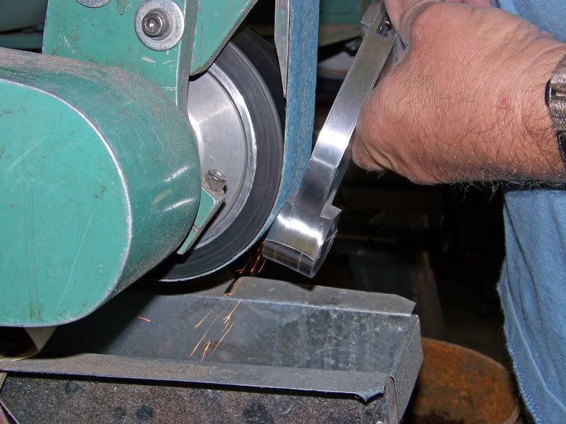

I modified the front bolsters for the better I think. They are smaller, lighter and tapered now.

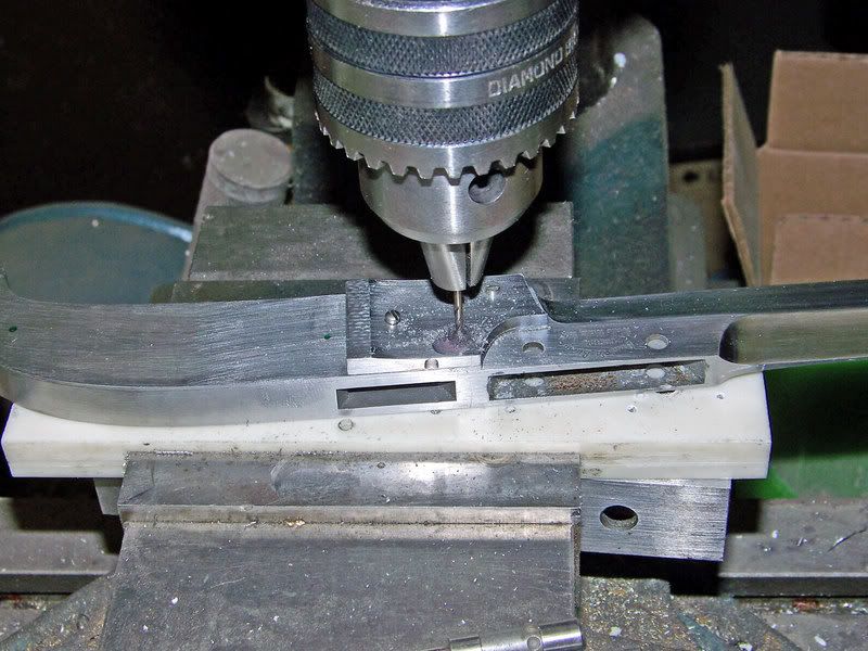

Here I am drilling the mounting holes. They are 2-56 slotted stainless screws and will be counter-bored.

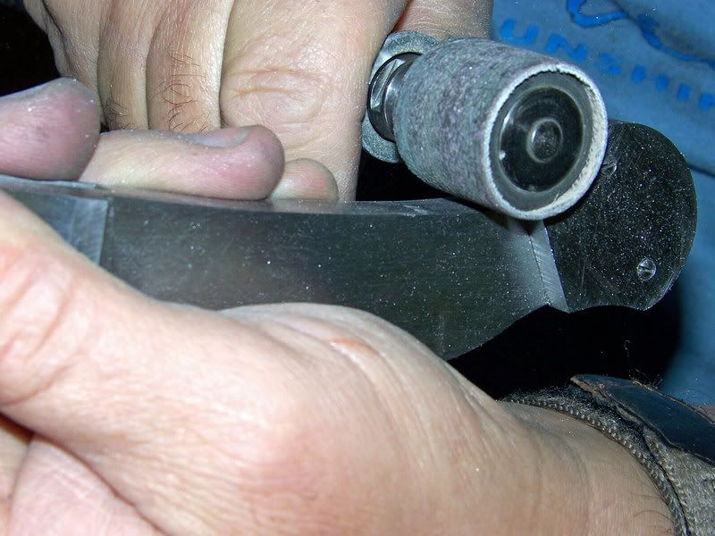

Here I'm matching and contouring the rear bolsters with a foredom. Front and rear bolsters are made from 1018 mild steel surface ground to minimize gaposis.
Tapering and contouring rear bolsters to a sea shell shape.

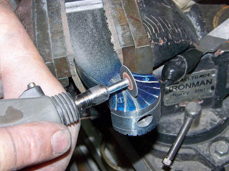

Dremel with a small cut-off wheel to cut deep narrow grooves in the sea shell pommels. I tried a file but they wont go around corners very well. This method seems to work good.
Next shots will be the finished shell pommels.

The pommel is cut out on my band saw. There was allot of grinding to true the frame, pommel and blade. Quite a bit of surface grinding too. All the slots are cut with a Keyway cutter.
