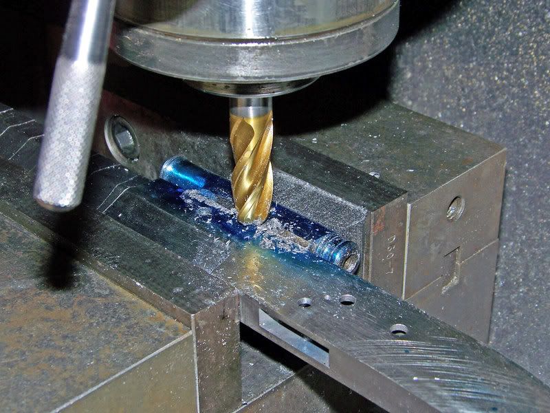

I use mostly 1018 and use a rifled liner from Brownells when I make a .22 caliber. On this one its a smooth bore .25 cal and I used just plain old mild steel (1018). It is possible it will blow up when I proof it and will need to be replaced. The wall thickness is about .125" in the thinnest place. Hey its this kind of thing that makes it exciting!:eek: To proof the barrel I will overload it by at least 25%. Black powder is tame until it gets a heavy bullet or an extra thick patch and the bullet it forced extraordinarily hard down the bore so proofing is needed for saftey. Pyrodex is the new black powder and works good with less corrosiveness.
I used the mill to drill the bore on the barrel and centered it by the bore on the lathe. I milled the mounting tab on the barrel and used a keyway saw on the gun frame to make the slot it drops into. I use blue layout fluid and scribe the centerlines with a caliper. Its not as accurate as using a DRO (digital read out) but works if I put my optivisors on and use a flash light to see my lines.

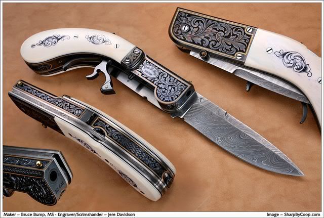

This is my favorite so far.
Its called "DEADWOOD" and has an assisted blade opener, Pre ban ivory, Jere Davidson engraving and gold wire inlays, Doug Turnbull charcoal bluing and color case hardening, adjustable hammer spring, ram rod in pommel and is stored in a leather bound book entitled "DEADWOOD" by Bruce D Bump
It has 2 ivory handled screw drivers, a silver bullet box, custom powder flask and a deck of cards from the 1800s. Its the sweetest thing I ever made. I do miss it but I am working on another called "The Vegas Special" that will take my mind off of it when its finished.

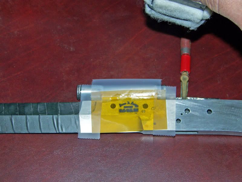

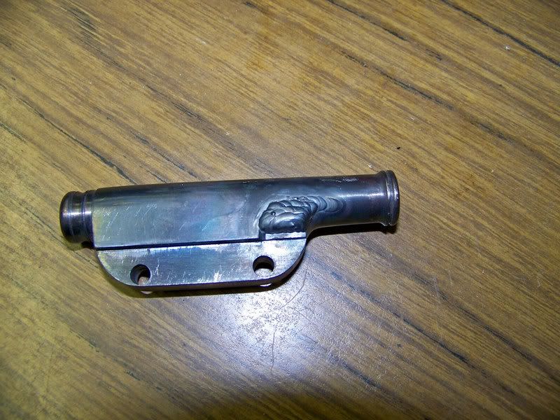

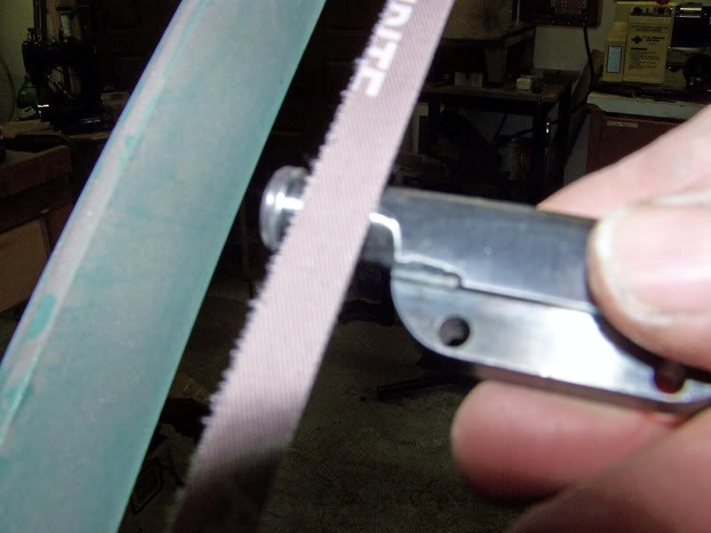

OK I told you if I screw up the whole world will see, well I milled a couple spots on the barrel and didnt like the looks of it besides they looked like a weak spot so I had the college heli-ark them closed and I reground the barrel in those two spots. If you scroll back you will see what Im talking about. Anyway Im happy now and am sure it is safer also.
Here is the barrel after the welding
Grinding off the excess welds
milling a groove at the base of the barrel with a round nose mill end.

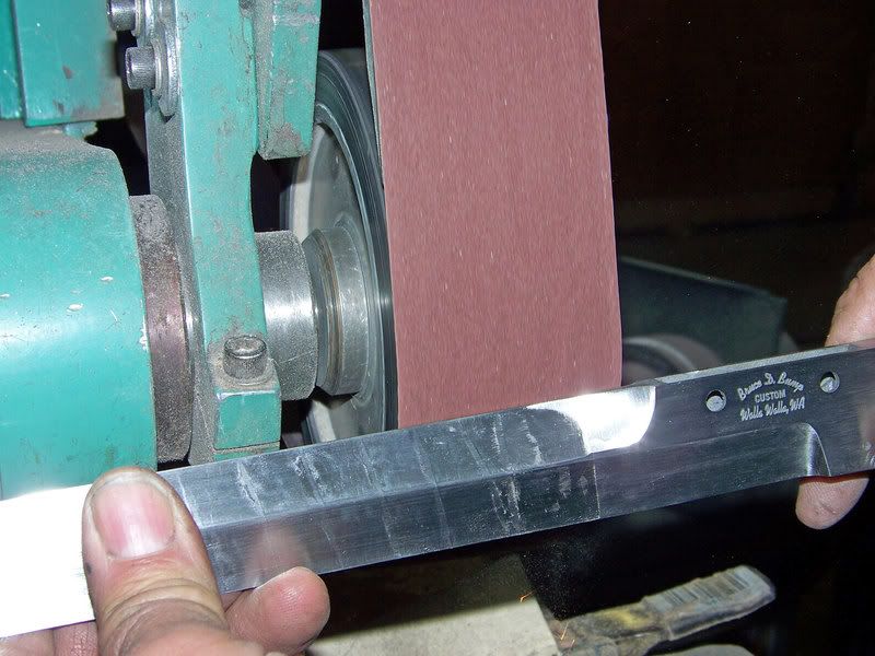

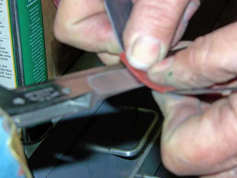

Hand rubbing the 5" bevels. Tomarrow is another day. Next comes modifying the front bolsters. Dang that one is blurry.
Thanks for tuning in
