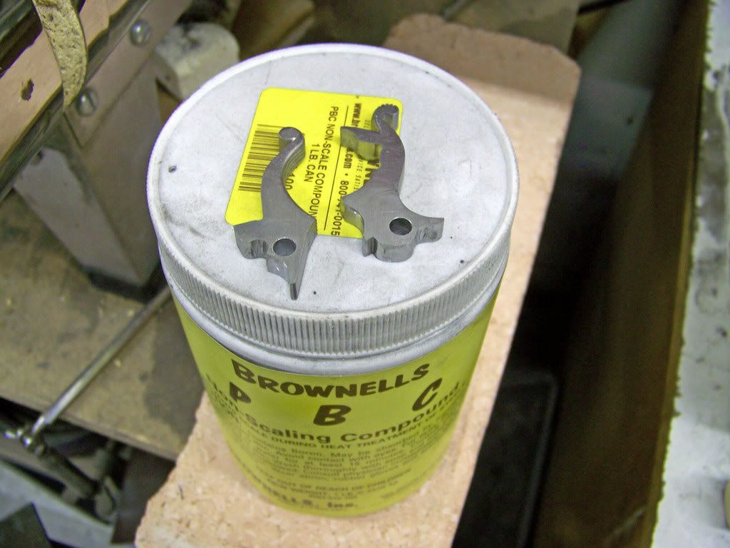

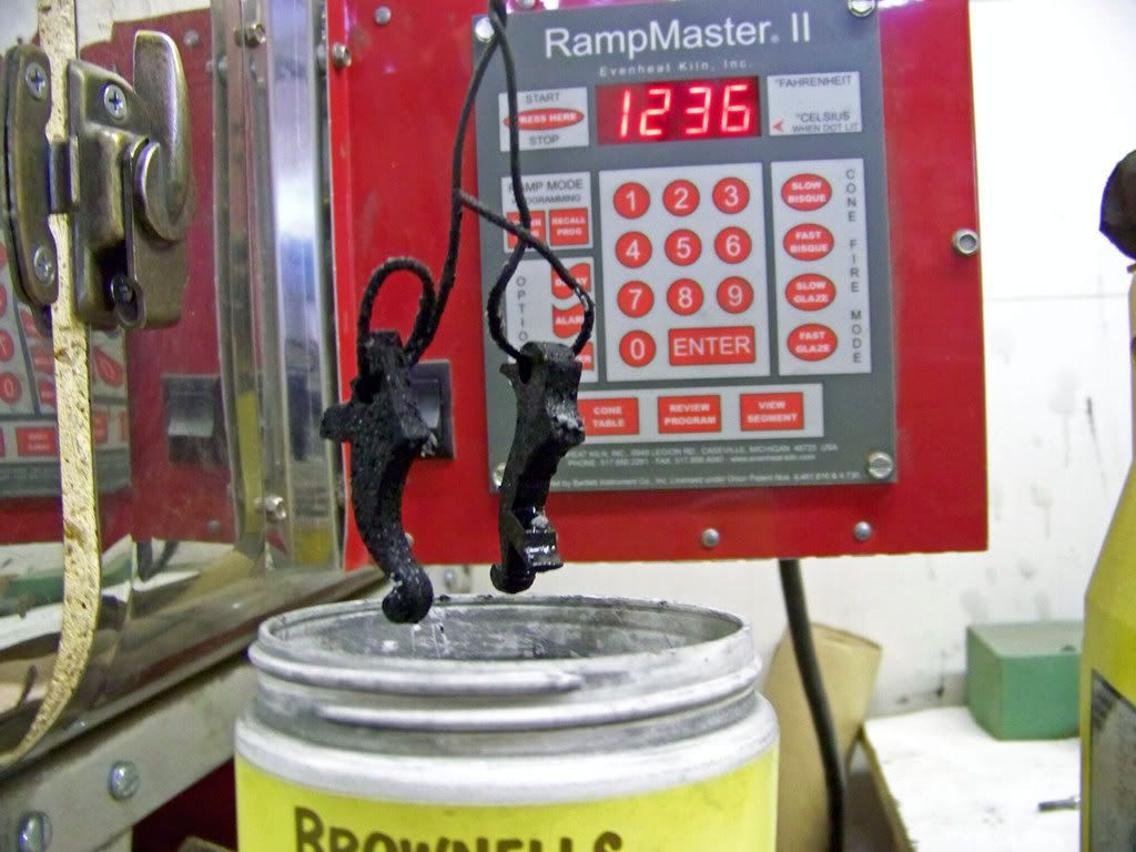

I had a few minutes before church today so I did some finish up file work on the hammer and trigger. Also heated the oven to 1500f and put them in at about 1300f until they turned blue and dunked them both in PBC. Back in the oven and soaked them at 1500f for 5 minutes and quenched them in Brownells "tough quench".
Here is after the PBC (anti-scale compound)

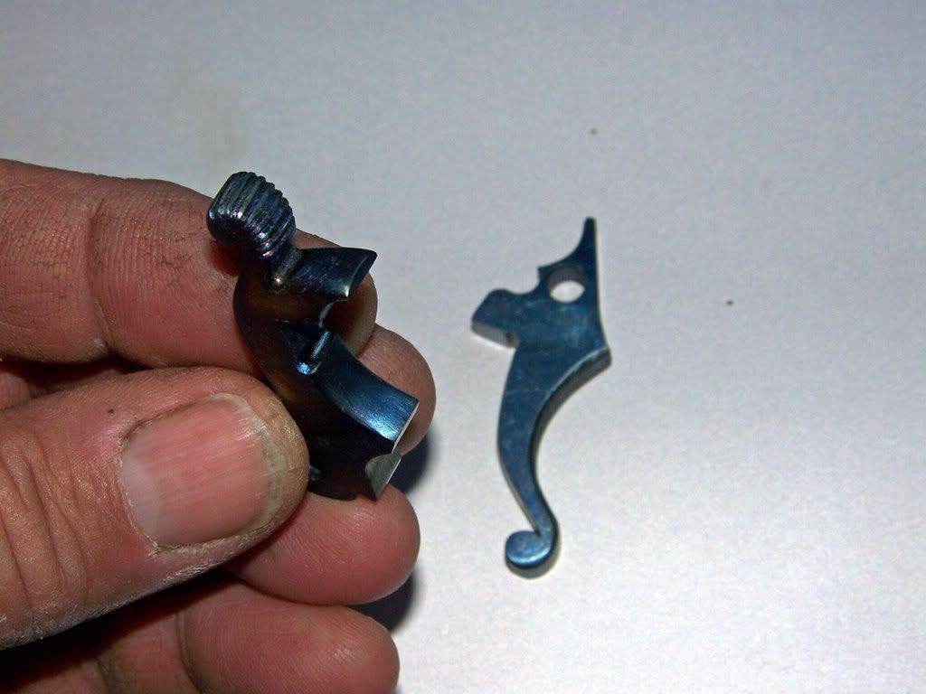

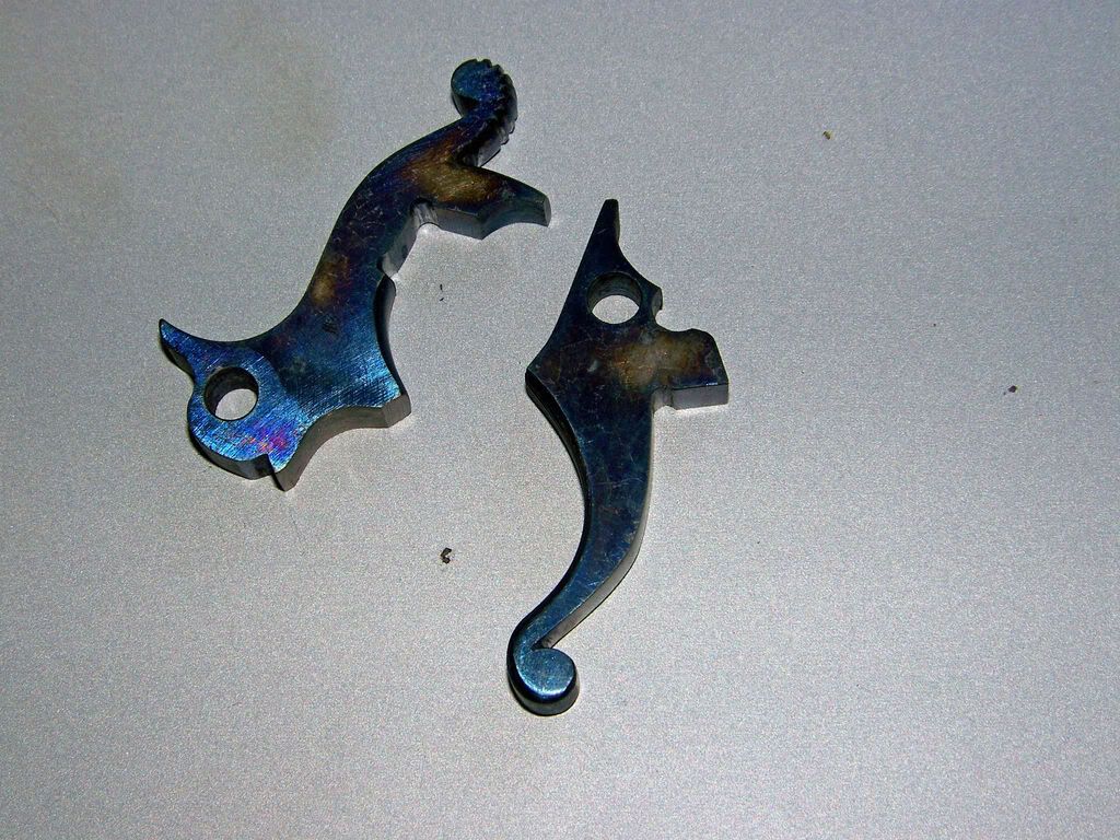

After hardening them and rinsing off the burnt PBC I cooked (tempered) em for 1 hour at 600f which should put them at 52 rockwell hardness. If you look in Brownells catalog they give hints as to correct hardness of the parts they sell for guns. Its a handy book and its free. Get one.
I love the PBC because there is no scale from austinizing heat. Look at this color after the tempering. My favorite shades of blue
I may have mentioned before but its so neccesary to get these two parts heat treated correctly. The sear (contact area between the hammer and the trigger) will wear away and fail to hold the tremendous pressure from the main spring if it is too soft, too hard and the hammer will break from the high impact of the normal operation of striking the nipple. Also the pivots holes and pins will gall and drag if they are too soft allowing the hammer and trigger to wobble and rub the sides of the frame. Which reminds me that I need to make brass or bronze spacers for them sometime soon.

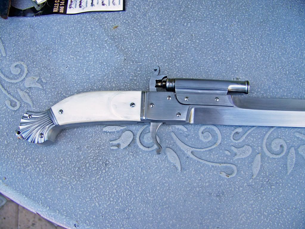

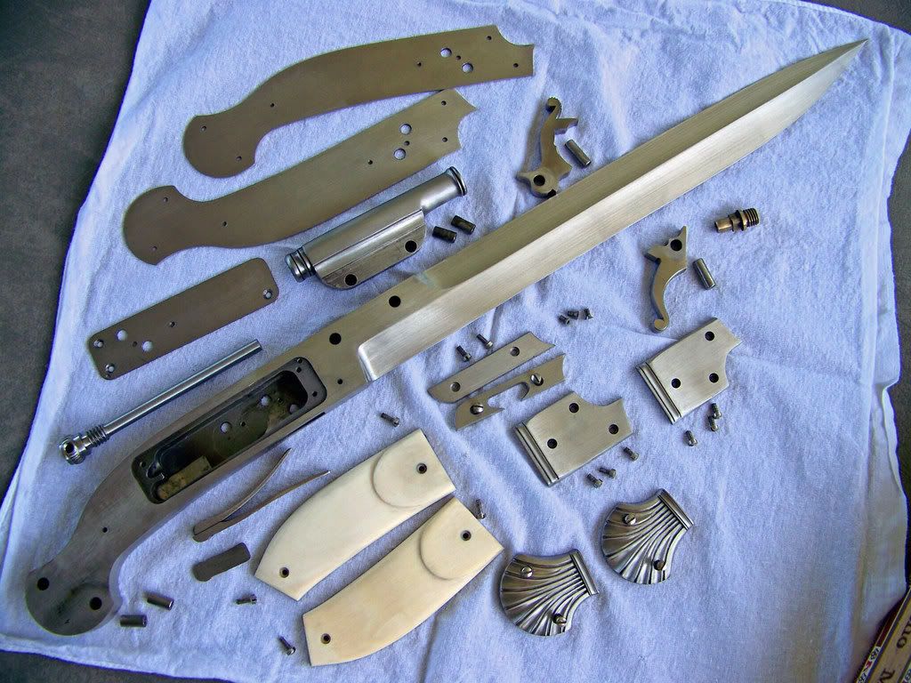

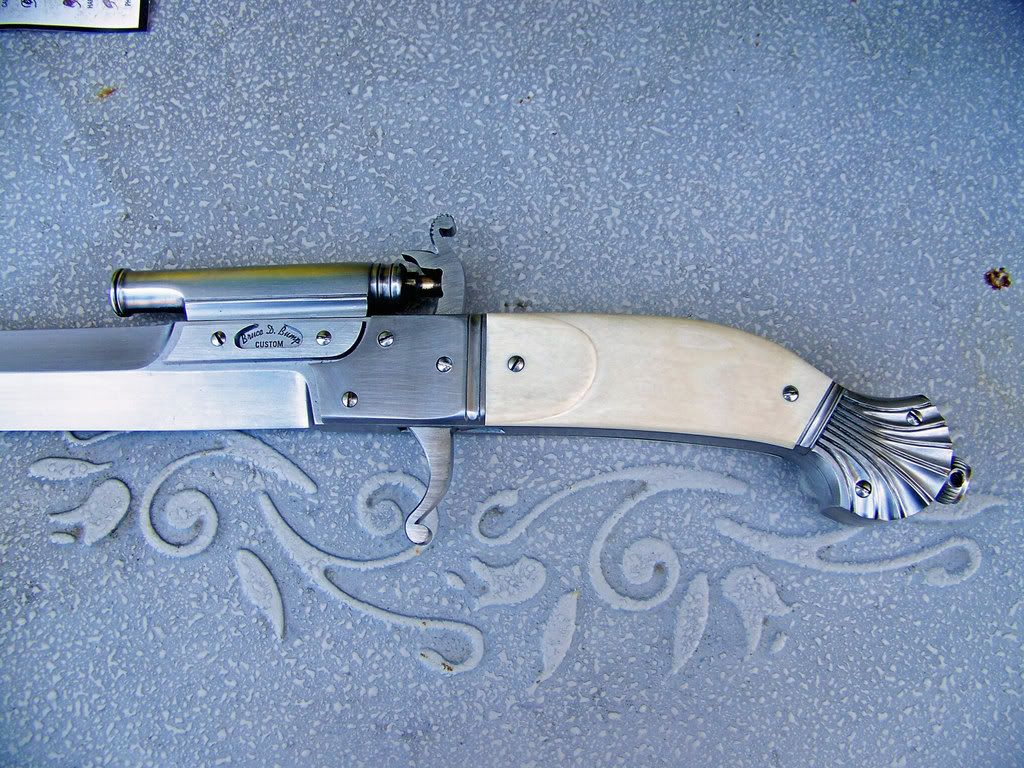

Here are the last additions. They are essentially plates that do the same thing as a flat washer. I wanted some more area for engraving also and these plates provide that. I had to cut out a window for my makers mark but I like it. It says Walla Walla WA. under the left plate but that sounds silly on a "Pirate Boarding Pistol" anyway so heck just cover it up.
I drilled a lanyard hole in the ram rod knob too.
Its about finished except for final finishes on everything. I need to take it down to about 600-800 grit before sending it to Jere Davidson for the engraving.
I went out an shot it yesterday. It operates very good and had only one misfire but that turned out to be a faulty cap. I started at 6 grains of black powder and worked all the way up to about 14 grains. There is no point going any higher as too much black powder doesnt have time to burn before the bullet comes out the muzzle. It fires like a dream with a nice recoil and report with 8 grains. No damage whatsoever to the barrel.

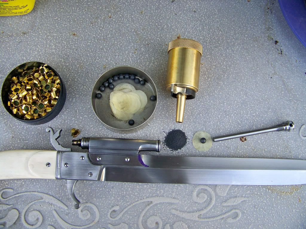

Here is my loading kit. It has a flask of FFF black powder, .250" round lead balls, .005" thick patches and muskett caps.
First simply hold your finger over the spout, invert the powder flask and open the valve with that little lever, it fills the spout with the measured amount. Now close the lever and turn the flask back upright. The measured amount of powder stays in the spout.
Pour the 8 gr. of powder down the muzzle of the barrel being careful to not spill any.
Next put the pre-lubricated cotton patch on the muzzle and place the ball in the middle of the patch.
Use the ram rod to push the ball and patch all the way down to rest on the powder
Put the ram rod away, Do not leave it in the barrel :eek:
Next cock the hammer back and place a muskett cap on the nipple. It will stay on the nipple.
Point and pull the trigger. Its that easy. Loading is half the fun of black powder shooting.
