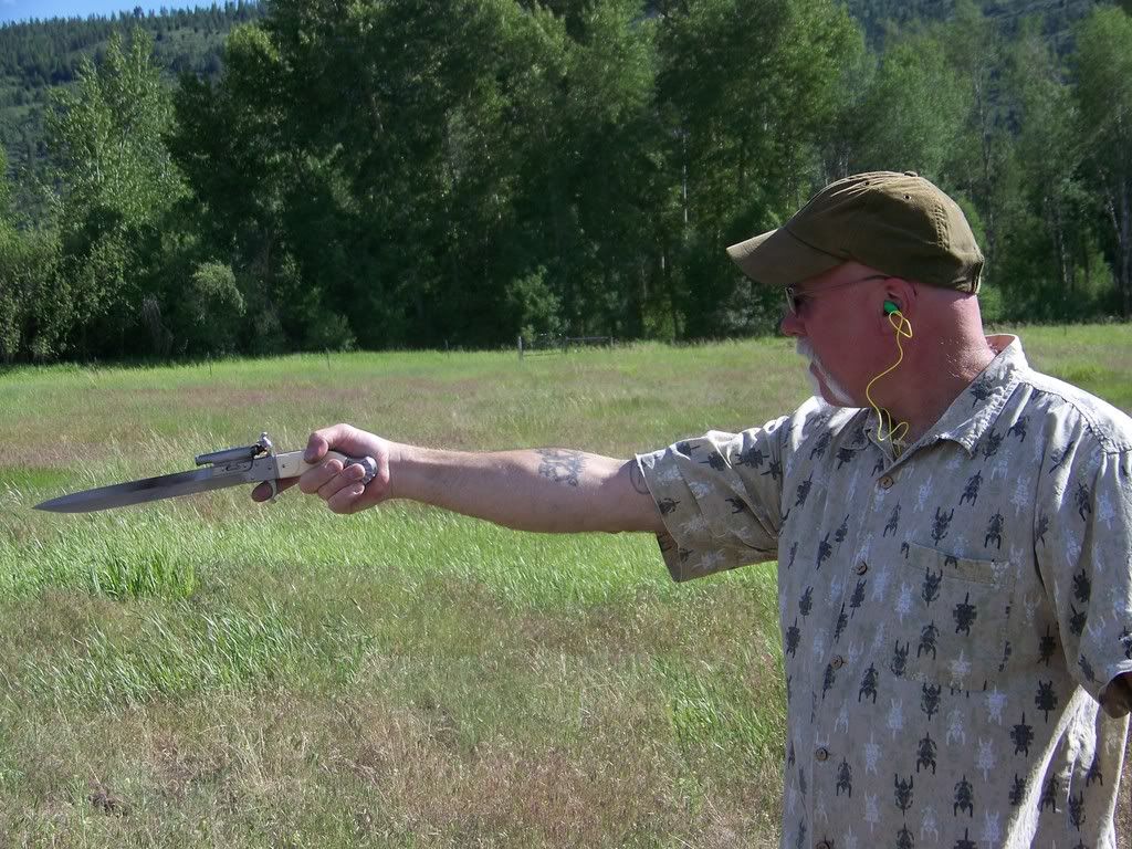

Just got home from Josh's hammer-in. The pistol got shot about 30 times by anybody who was interested. I think I'm the only one to actually hit the target though. Without sights and the fact that you cant sight down the barrel unless you move your hand off the side somewhat its not very accurate. Well hey it made for boarding pirate ships not for target shooting.
Here a nice pic of Dave Lisch
Notice the powder burns on the blade? It cleaned back up nicely but if left on it would stain the finish for sure. I looked close for lead deposits or signs that the round ball made contact with the top edge of the blade but there is no evidence that the ball touches the blade from recoil. I bet the bullet is gone before the kick.
All in all after about 50 shots total I'm satisfied that its a good shooter. The trigger and hammer area inside was spotless when I took it apart afterward. Black powder smoke residue has a bad habit of getting into actions and fouling them up but the hammer design of this one seals off the inside when the hammer ignites the charge and doesnt allow the smoke in. There was some powder residue on both sides from the muskett caps but the tender ivory is back far enough to not be touched from it.
Jim Cooper was there and took a picture just for the internet. After the engraving is done He will get the finished shots.
