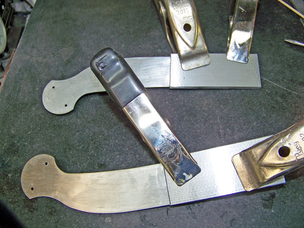

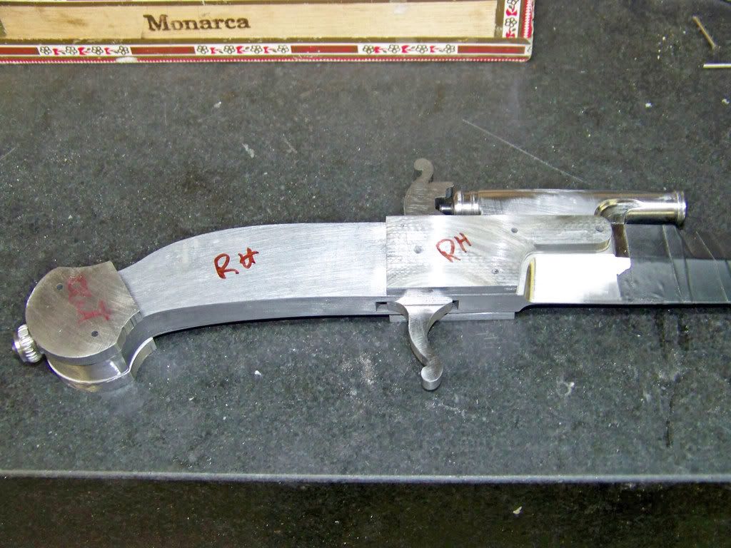

Here it is after rough shaping the rear bolsters. The front bolsters are profiled to match the frame but everything needs to be contoured still.
Its starting to take shape.

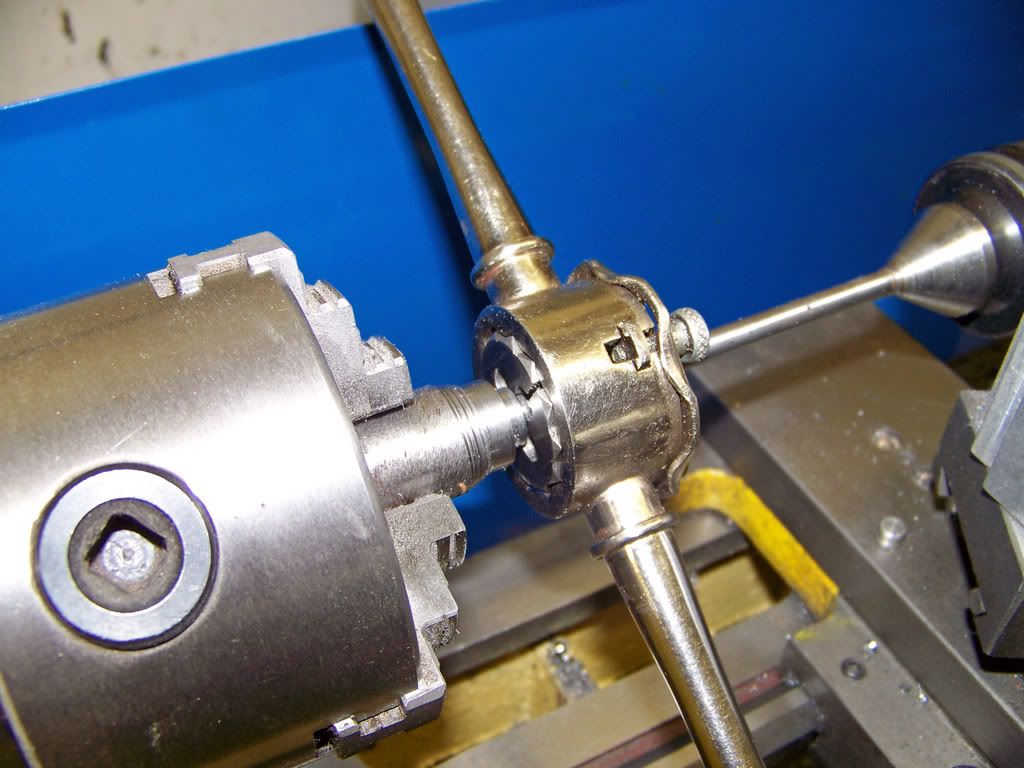

I have a small lathe but for small parts it works good and has many of the big lathe features. Its the 7" by 12" they sell for $450 or so in Enco. I have friends with lathes if I need something bigger.

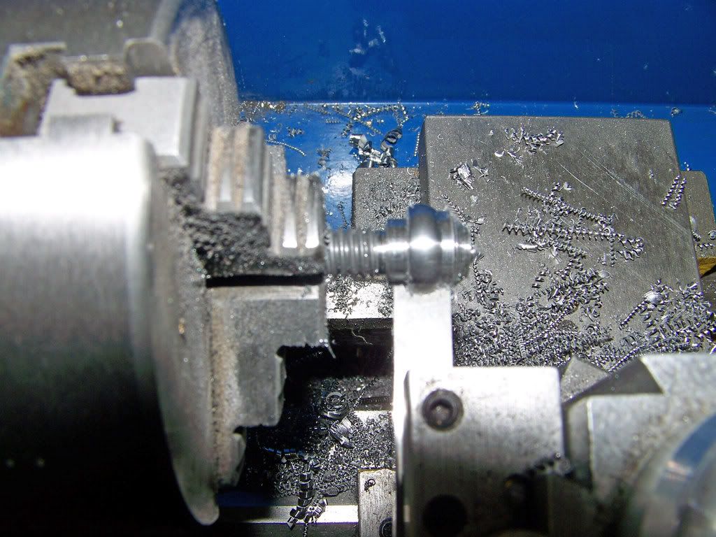

One of the photos above shows what to me is a special type of cutter, that's possibly shaving steel off of the ramrod. It almost looks as if it fits loose on the ramrod until the lathe is turned on, then that little unit can be adjusted to take a few thousand's off the ramrod?? Am I anywhere close?
I've been wondering who's going to get this one, then it dawned on me. Several pictures up shows the cut N shoot on it's side, with RH RH on it. RH? Hey! that's me!
Robert Hensarling (now get to work :o) Yes, I'd purchase a set of plans if you ever go that route. The way I understand it, if it's black powder, there shouldn't be any involvment with the ATF, etc.?
Robert what a good sense of humor you have this early in the morning too. The RH actually means Right Hand. Theres a LH on the other side:D This one may go to France when its finished but thats not for sure yet so I will put your name down next :)
The cutter you see in the picture is a high speed steel blank that I ground out a "U" shape and cuts a round spot on the knob. In machine shop one of the first things they teach is how to grind your own cutter tips.

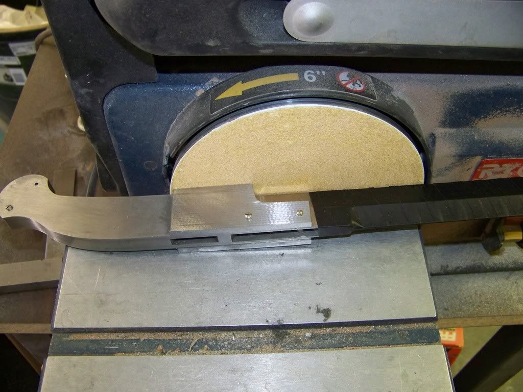

I think that if I make one right off the plans and take photos with each vital step with a written description throughout the entire project that you guys could each make one with home workshops. Maybe you would need help from a friend for just a few procedures, heck I still need help on some things. I dont have a surface grinder yet so the one you see in here is Robs with me running it.
