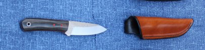

Not a DCC clip in that image, but similar in general appearance. (I have a ton of DCC clips on holsters and sheaths...but some of the similar clips work pretty well.)I am very picky in what I like for a pocket sheath. If you look at the pics navman posted, his sheath uses a Discreet Carry Concepts (https://discreetcarryconcepts.com/) clip on his sheath. On that clip, you can see a tooth that bends inward. The tooth makes it grip better. That is what makes it work better. The pic Hammer67 posted shows a clip without that tooth. It is fine on my folders, because I want to pull the whole folder out with the clip. On a fixed blade I want the knife to leave the sheath behind when I draw. Clip is only one part. The sheath retention is also important. If there is too much then you are pulling the sheath out with the knife no matter what.
The pocket clip also puts the knife at a height and location that you can access consistently and easily vs a slip sheath. I know its easy for me to look the knife into a kydex sheath, like holstering a gun. I haven’t used a leather sheath but if it is sufficiently stiff and does not collapse, it should work, too.
I have put DCCs on my pocket sheaths from various makers here. I think they work better than Mummert which I use for other sheaths. Ulti-Clip is generally my last choice.
