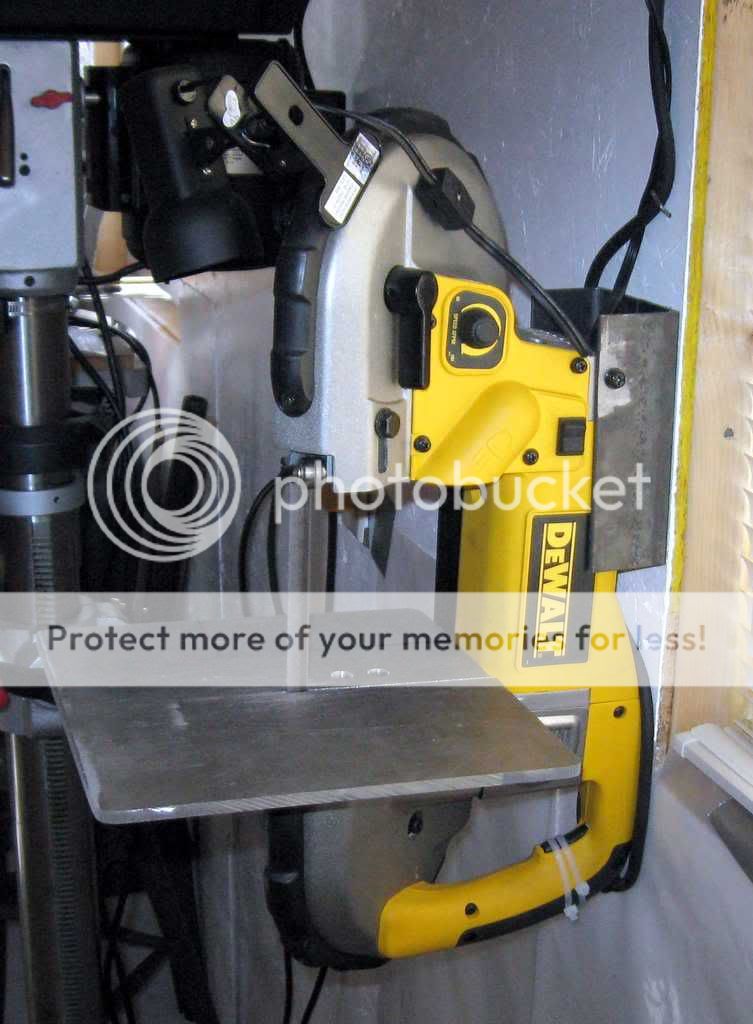

A piece of 2" angle iron purchased at HD, cut about 4" long. The work rest is 1/4" aluminum I found on ebay. I have a light switch mounted on the wall just above the photo.
Normally I don't show anybody a project until it's done, but I'll make an exception for you Will ;)
