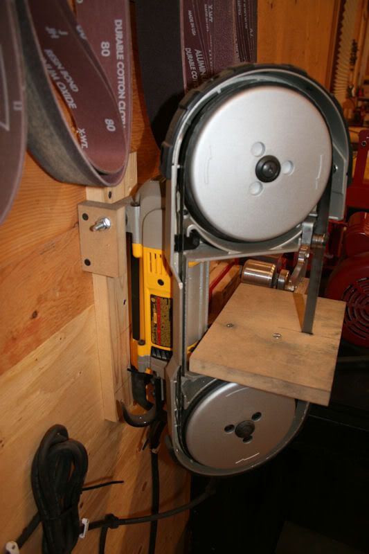

I am about to get a DeWalt and the information and pictures are great but no pictures of how the table is mounted:confused::confused::confused: So how is the table mounted?
take the lower blade guide off (the bent thingy above the rollers) and use it as a pattern to fashion a mount that bolts to your table and the saw. you amy be able to just modify the existing guide and mount the table to it.
It is very simple. Look at the picture Nick posted on the first page - I used it as a reference when I was making mine. Get 1/4" thick aluminum plate (mine is about 8"x10"), remove the material guide, make 1/4" holes in the plate that match the holes in the guide, countersink them and use the original screws to mount the plate. Before cutting the aluminum it is a good idea to make a table from the cardboard to see how it fits and what should be cut off.

Here is a picture of my portaband setup. I'm pretty happy with it thus far.
Very nice, looks like you can do good work on that. I don't see where the problem of throat depth arises, unless you're cutting short swords from bar stock...
