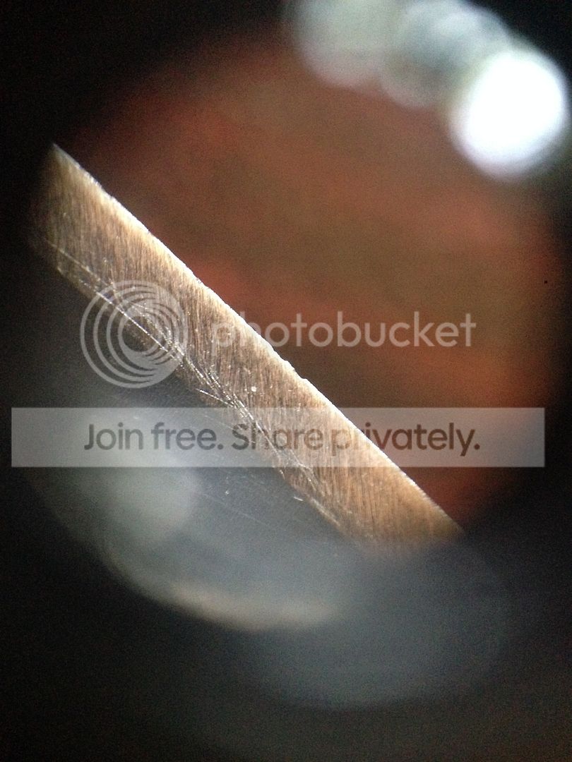

For some fun, here is an image of S30V ran at stupid low angles that I cut some twine with. Edge failure appears to be by carbide tear out rather than edge rolling. To resolve issues like that just increase your angle. I have done lower angles on steels like Nitrobe-77 and 14C28N with no such chipping issues.

but at angles lower than 15-dps ALL of these lower carbide steels suffer edge-rolls and chips on tasks like, for example, planing hardwood.
Really? have you ever try using high carbide steel like D2 or S30V sharpen to acute zero edge, something like well made scandi knife to carving hardwood?
I guess you just never try that... I will tell you that the edge will fail much sooner than a similar blade made of lower alloy like O1 or 52100, this is not theorizing either...
The very edge stability are about the strength of martensite structure not carbide.
Thinking of edge of 2 concretes block, one made of cement+ very fine sand... while another one made of cement + courser sand +crushed rocks.
Sharpen these brick to the same degree, which one going to have stronger acute edge? which one going to be stronger overall? that 2 different attribute right?
The lower carbide steel will hold the very acute edge better than higher one and it just the fact.
The different of edge structure between low and high carbide are much vast than most people think.
ddd_zps4oigbtqa.jpg~original
[/URL][/IMG]
Why do you think it is a carbide tear out vs. chiping? Carbide sizes(sub micron) and even grain size is much smaller than the magnification on the image above would allow to see.
