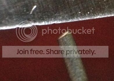

So, I reprofiled S30V to 7 degrees per side. Used it over the weekend for all my general chores and yardwork and here was the edge.
I experienced similar chipping as previously with some chipping that I felt at the edge, but not really visible in the image below. I could only capture the bigger chips @ 20X magnification. To the left of the pencil is the larger chips. To the right the edge feels jagged on the nail but unable to take pictures of it.
The led pencil is 0.5mm that I split into 0.1mm sections.
I found an image of S30V on another forum (sure hope it really is) that I modified. The sections that I highlighted in red is 10um (0.01 mm). Yellow lines are 5 um.
I just do not have the capability to take images of the smaller chips but the larger chips are around 100um (0.1mm).
I wonder if the smaller chips might not be some form of carbide cluster or such.
Either way. Fun experiment. Done for now, time to use my knives again and stop worrying about the little things.

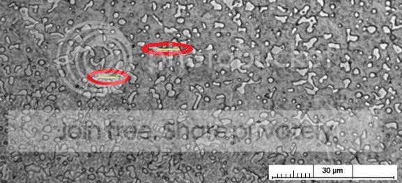

Cool pic, I don't think I've seen that before, and thanks for scaling the chip, like I said it was hard to guesstimate their size.
I'd guess if that happens it's be the size of the cluster. Although, even 10um is quite a cluster considering individual carbide size. Botched HT can produce large clusters, but I have no idea how large, fun stuff :)
P.S. FWIW I've checked several blades, all low carbide content, high hardness (Aogami 1, 2, Shirogami 1, etc) they all have microfractures or microchips, edges vary from 15dps to 5 dps. In the end, chipping due to stress is far more likely than due to series of consecutive carbide tearouts.

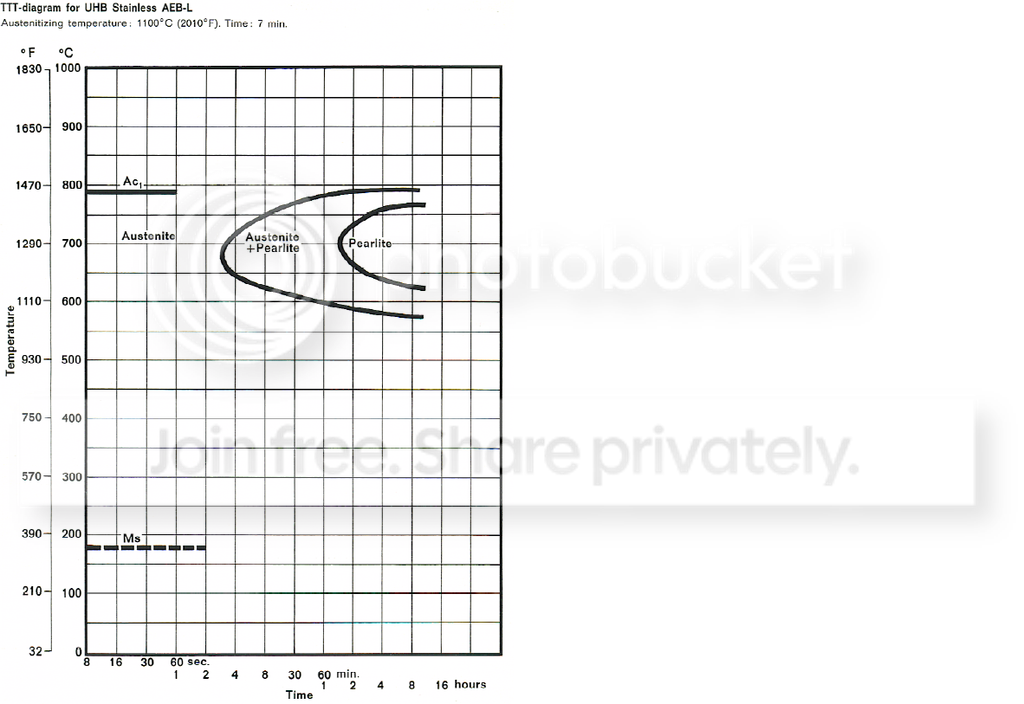

Speaking of AEB-L, is there a TTT chart of it? The Uddeholm DS I found speaks more about razors than metallurgy...
Pablo
The really good news is that the Mf point for AEB-L is well within the range of the old dry ice Slurpee cryo treatment. That is not always the case with the "super steels" assuming you want to eliminate as much RA as possible. The guy from Uddeholm at Blade a few years back told me that the desired cryo temp for Elmax is about 15-20 degrees F below what you can expect to get with the dry ice and acetone or kerosene mix.
