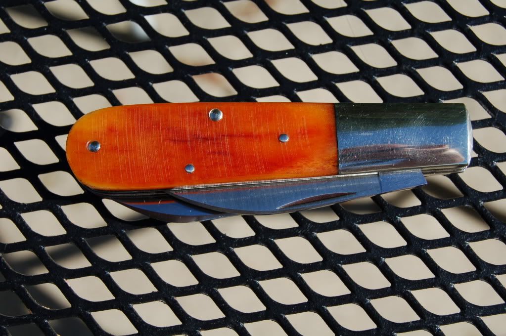

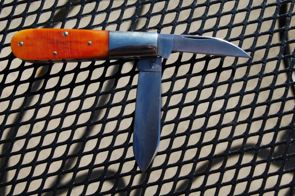

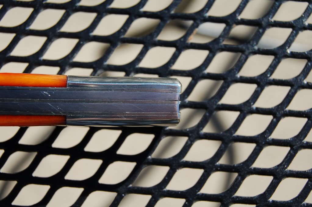

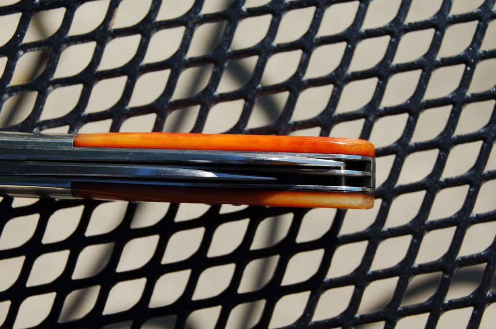

Mine showed up in the mail yesterday and first impression is that it is beautiful! This is my first Barlow so I did not really know what to expect in terms of how it feels in the hand. As others have mentioned there is a slightly sharp edge on the back stop of the blade when closed but I will smooth that out just a touch. F&F is very nice. The bone scales are perfectly finished against the bolster and around the frame. Good centering on the blades with no goofy rubbing on the liners. There is a minor gap on the back spring near the Wharnie blade but not a big deal. The main blade was also rather dull but I'm going to reprofile with my Edge Pro and add a micro bevel anyway. Pinning is all very well done. The size is perfect for every day use and rides in my watch pocket perfectly.
Here's a few pictures. Sorry for the poor photography skills! I struggled to get the lighting right to show off just how great this knife looks.

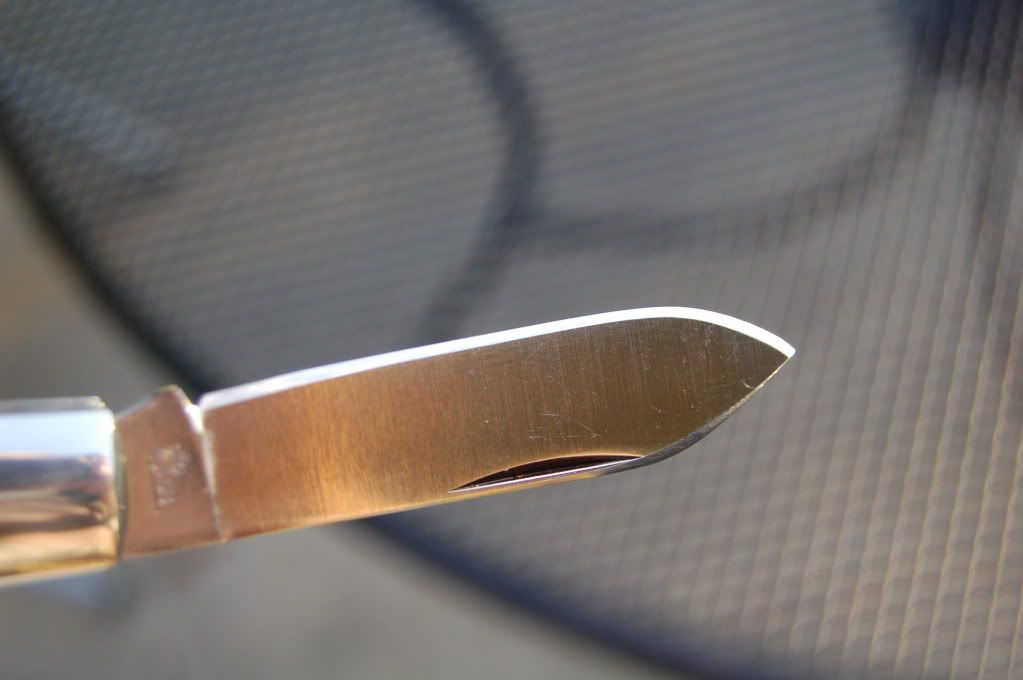

I spent a little time during lunch doing a quick reprofile on the main blade. Brought it down to a little under 20degrees per side so I could do a microbevel on my Sharpmaker. Makes for easy touch up. I will say that it took a little work on the reprofile. That Queen D2 is tough stuff! Should hold a great edge and will now clean-cut paper and shave very easily. I did try to run it through my Sharpmaker first at 40degrees (inclusive) and it did not even come close to hitting the edge using the black marker trick.
Nice Sharpening Job! Your pics made me want to carry mine today, but then I noticed that it needs sharpening. Guess I have some work to do tonight.
Barritt
Thanks! The Edge Pro is pretty easy to use once you get the hang of it. I still need to work on the wharncliffe blade this week. Brought it to work today and I have been looking around all morning looking for things to cut :)

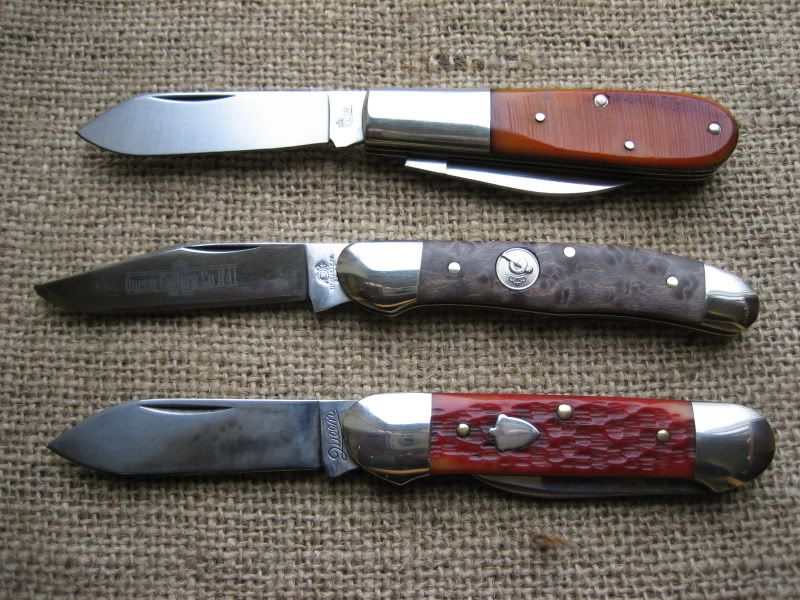

Finally a pic of my humble Queen collection. I'm really looking forward to adding this years forum knife into the mix :D
