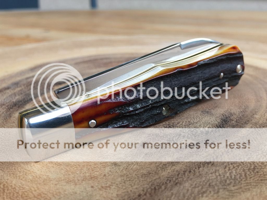

Haha, Jolipapa where did you get that photo? Is that a Queen, it's blade needs a little bit of viagra for a bit of pick me up, don't it or is that the photo? Did the scales come that way?

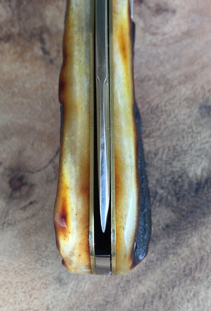

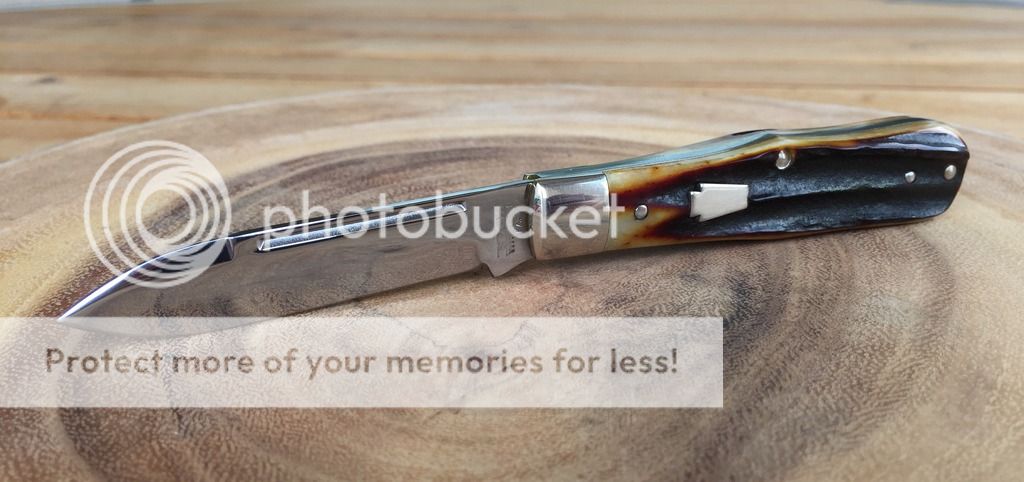

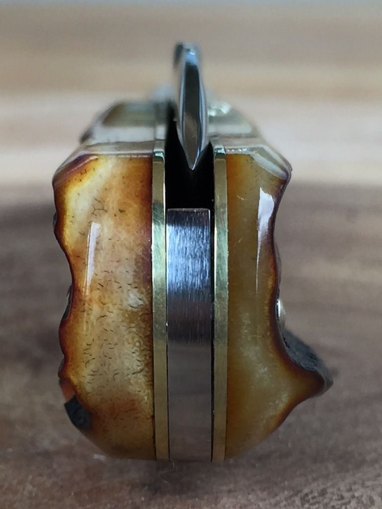

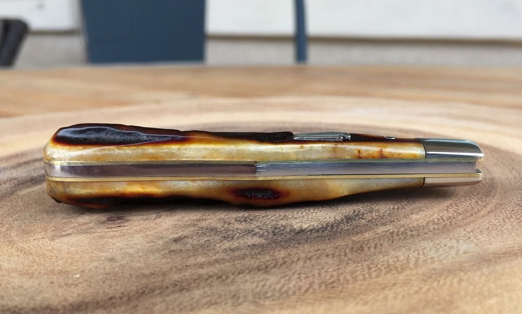

This is my country cousin Queen when I received it... Since my little hammer had some work. The blade is ok. Late friday evening or early monday morning work? :confused:
Joilipapa, I think I can see some light between the covers and scales. ;) :p :D I'm glad you were able to fix it but that is not acceptable. It's amazing that could have even left the factory that way. Do you think it could have warped and separated sometime after it was made?
JP That's a monster fail. A policy of 'Don't Ask, Don't Tell' must've been going on in the QC Dept, dreadful! :barf: Or maybe it's a new species of Micarta Beetle that's evolved to bore into synthetics....:eek::D:D
I don't think this happened after leaving the factory. Problem of QC. I had the same kind of problem with a German Eye sodbuster, to a lesser extent. Both are not-too-expensive (though not cheap) knives and not worth the trouble of sending back etc.

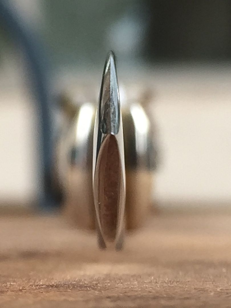

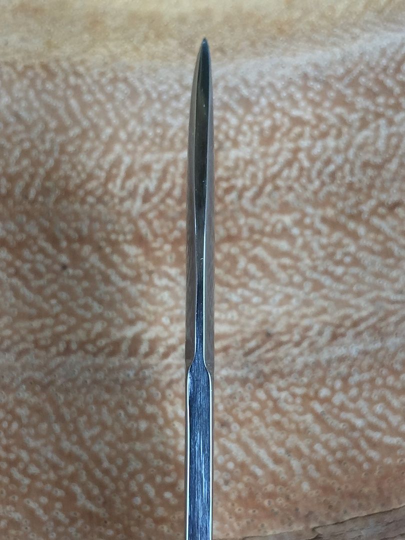

The bigger issues, which I have noticed down the road as I learn more about traditional knives and sharpening, are these: the primary grind is (in my admittedly amateur opinion) way off, especially towards the tip; the blade rubs the liner (partly a result of the funky grind); and there are some noticeable gaps between the liner and the spring.
Here are a couple angles of the blade showing the grind issue. On the left in this picture, you can see how much more material there is compared to the right. Towards the tip, the blade is really fat (for lack of a better term) on the one side. In fact, compared to just about any other knife I own, I'd say that the tip of this blade is entirely too thick all around.
In this photo looking down on the spine, you can also see how uneven the blade is ground, and how fat it is at the tip.
Here you can see how the blade rubs the liner (it's on the side where the blade seems fatter, which I'm sure contributes to the rubbing). You can also see the gap between the cover and the liner on the one side.
And here you can see another gap between the liner and spring along the back of the knife.
Now, I could live with most of these issues, but the biggest problem for me is that the grind has made it difficult for me to sharpen the knife. I wouldn't say that I'm great at sharpening, but I can put a good, serviceable edge on most of my traditionals. But as fat as this blade is at the tip, and as uneven as the grind is, I've found it really difficult to get the angle right and put a decent edge on it.

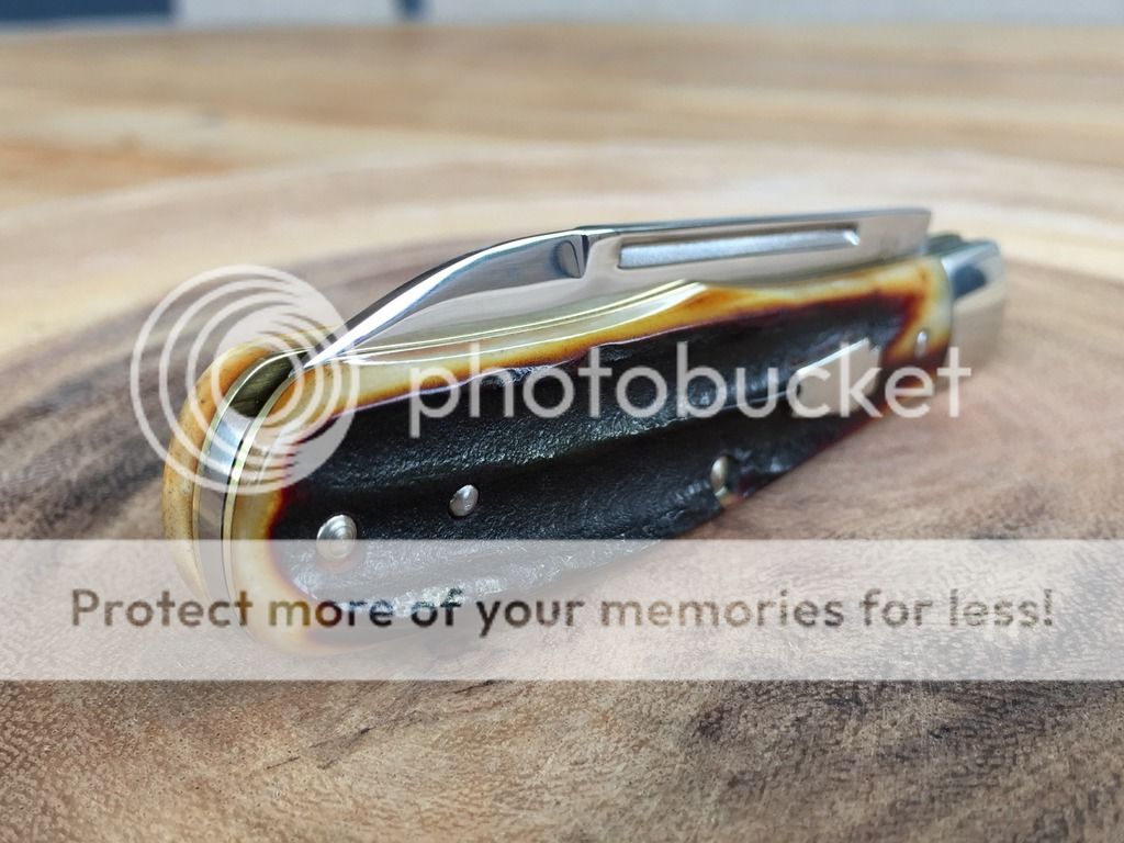

@ btb01, Barrett, I've got that same knife, and I couldn't be more disappointed in it. It was my first "modern" S/M purchase, and while it isn't a bear trap, it does have all the terrible f&f issues yours has. The blade was so far over to the liner, I couldn't even close the knife! I sent it in for warranty, and they fixed the "blade rub" but not the other issue I had with it. When open, the blade is still leaning so far to the left that it looks like a comics' prop knife. I have at least five other Queen made knives that have this horrible blade angle when open, and two of those have ridiculously bad grinds. That said, I have two vintage Queen made knives that are great (not perfect, but pretty close) and two Peanuts that really are perfect in every way. I think the promise of what those good knives of mine kept luring me back to try Queens, but the current offerings and experiences have put me off unless I can handle them in person. There are way too many other knives to choose from these days that it's just not worth the hassle to gamble my money. GEC has spoiled me for quality expectations, and at times I want to scream "if GEC can do it so consistently, why can't Queen!!!"

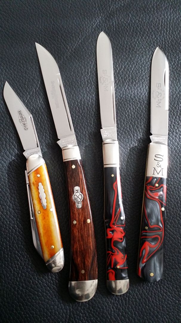

The daddy barlow was pretty decent from the factory, but the coke bottle's main spring was thicker than the blade which caused some serious horizontal blade play. You could actually see through the gap. Plus, the tip had a pretty crooked edge grind which was not fun to sharpen out. The clasp knife with rosewood covers shown here does have a bit of horizontal play, but otherwise it's fine. The shield appears to be pinned on this one. I REALLY wanted to like these knives so I live with the blade play on the clasp knife (which is caused by the spring being thicker than the blade as well, but not too bad) and fixed it on the coke bottle.
I have a couple of Queen knives, a trapper in amber stag, and a copperhead in curly zebra which are darn near perfect.
I wish they would get their QC straightened out. I really want to like their knives but I'm always hesitant to pull the trigger on a new one.
Draggat those red/black covers are absolutely stunning, as was my feathered buffalo horn. At least they get that right, but unfortunately it was about the only thing. I know what you mean about really really wanting to like it, but sometimes you just can't overlook so many other defects. Thanks for those pics though.
